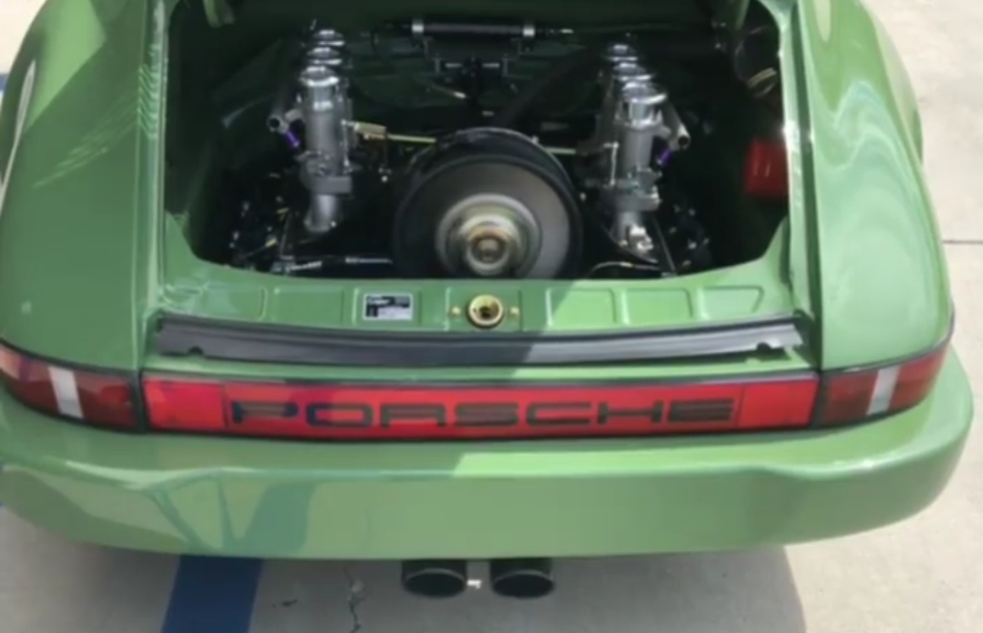

This is a 3L SC engine with upgraded cams, Borla itb's and MoTec management. Also runs our headers + a custom fit gt3rs muffler. Sounds delish !
