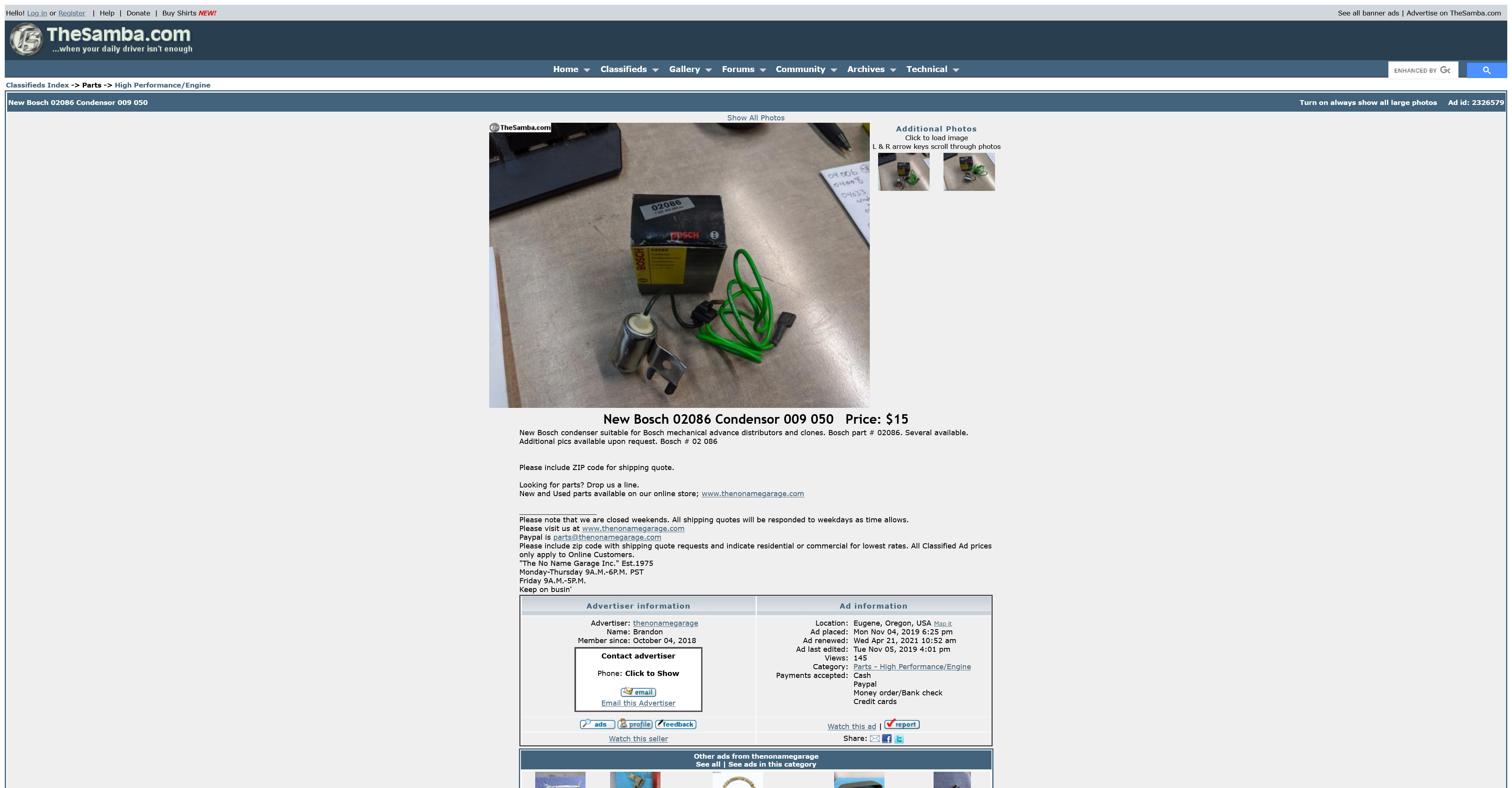

Use 911 points, they are equal to the tiger stripe points in 050, seller on theSamba.com has condensers listed for 009/050. Click to open
