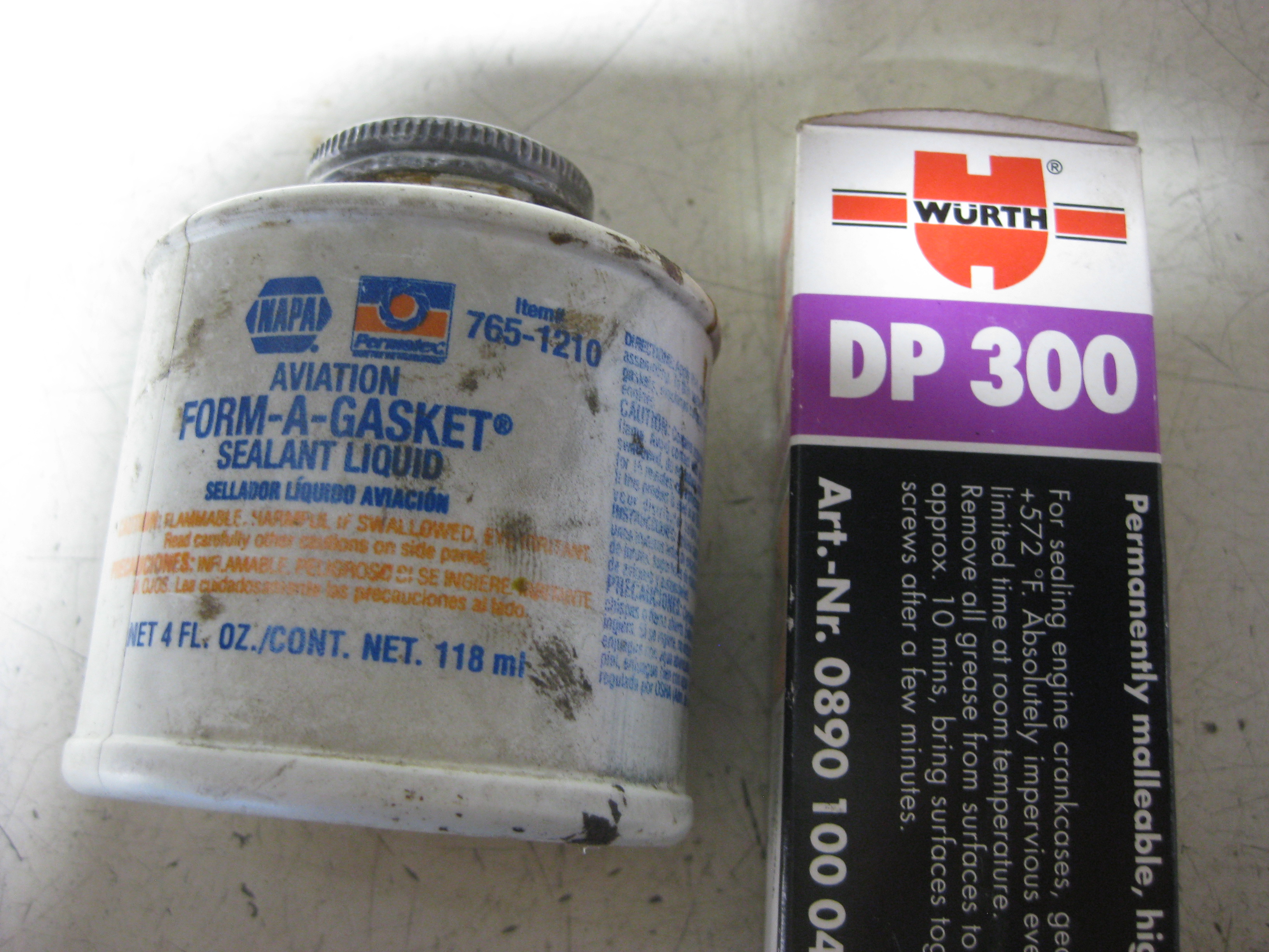

johnhora
post May 4 2021, 02:08 PM
Posts: 902
Joined: 7-January 03
From: Derby City KY
Member No.: 107
Have had good results with these over time...
Old School left...New School right.
