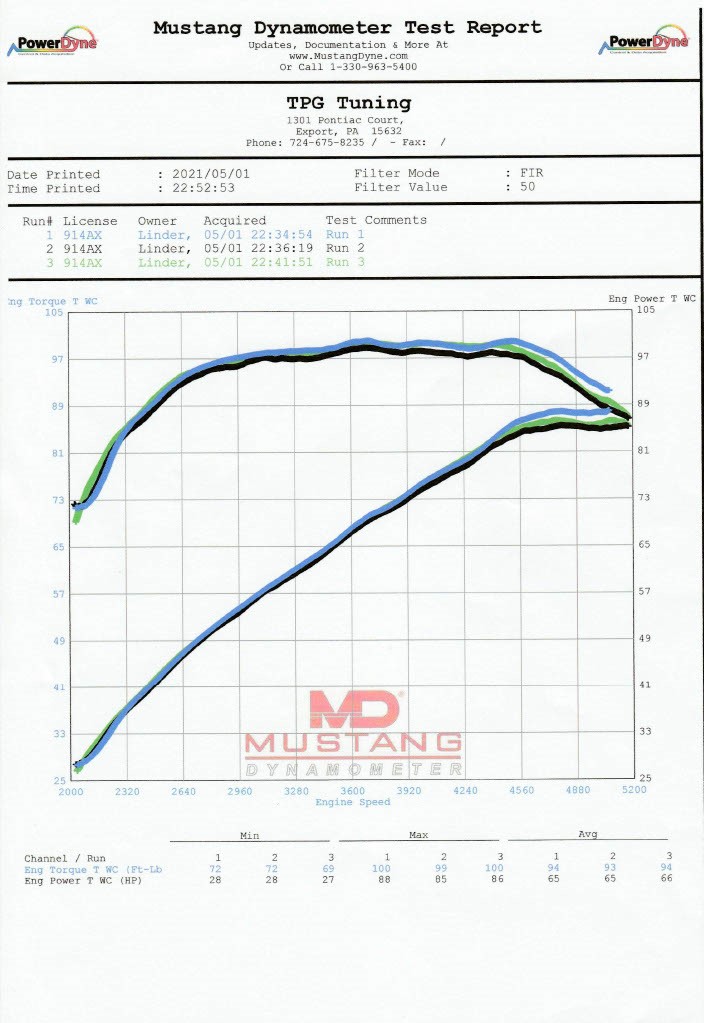

Just got back from having the teener run on a Dyno.
Good and not as good as I expected.
Was hoping for at least 100 Hp, didn't make it.
This run was on a Mustang Dyno, allegedly a Dynojet Dyno reads from 12~15% higher.
First the good.
Runs were extremely consistent. the three runs printed pretty much right on top of each other.
Torque was way up there above 95 tq from 3000 to 4500. with no real dips.
HP numbers were very consistent with a nice smooth line from 2000 to over 4500
Now the bad
Max HP was only read at 88 Hp and max torque was 100.
If I add the 12-15% it comes to 100 Hp. But it is what it is.
Build is
2056 D-jet, Heads by HAM RS+, 8.6 comp. Raby 9590 cam, SS HEs with Triad muffler. I Have adjusted the MPS to what seems to run best for this car.
This car runs great and I just wanted to know what it was putting out, Not really planning to try to tune it for more power. Reliability is the key. and I am so far happy with that.
Dyno sheet added (Date/time is wrong, 5/06/21 8:35am)

Just keep in mind that is your HP at the wheels. Not at the crank. You loose a good bit through the 901 box ~15%.
That said you are detuned with that build. Somewhere something is not working as efficiently as it should. What are you using to control fuel? Carbs/DJet/EFI?

That TQ looks great. I bet it drives and pulls great and can feel the difference in the upgrade.
Great Job

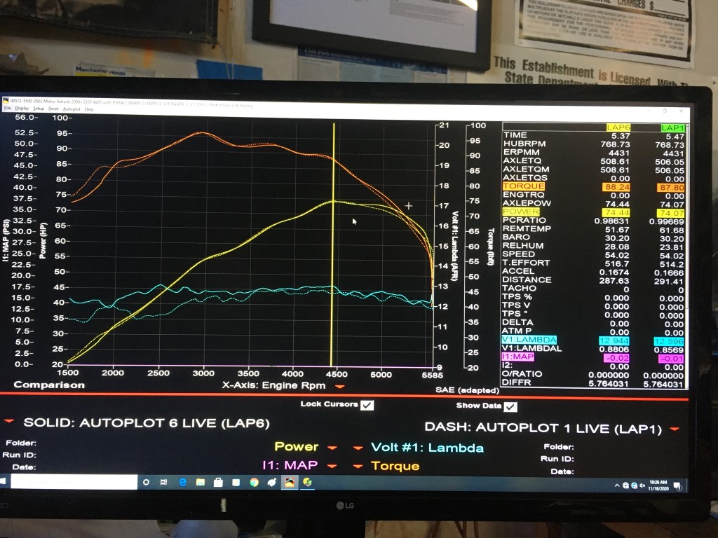

Edit: here's my "before", w/ Microsquirt tuned close to the same AFRs. No history on the engine known.

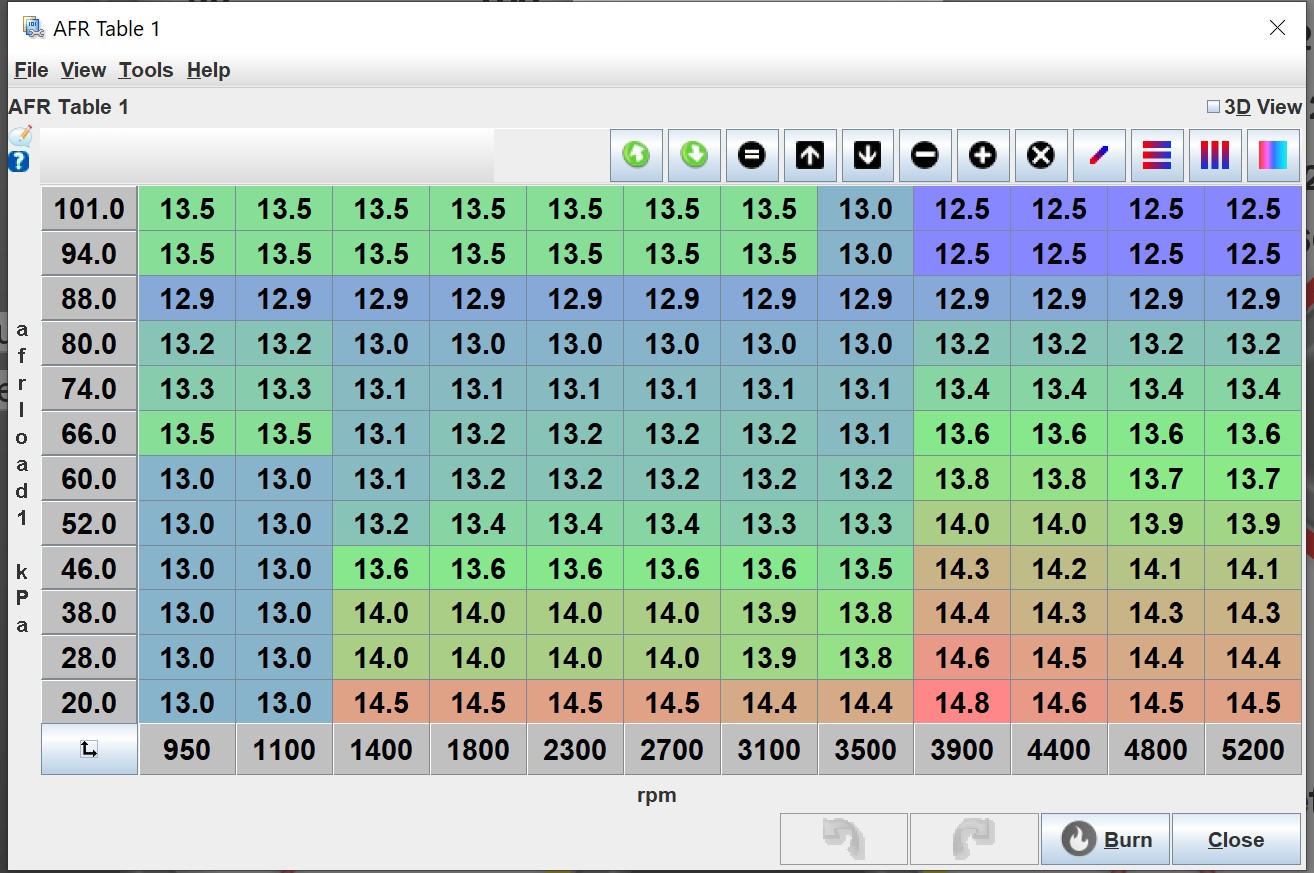

Correction on that; those numbers are for the Toyota MR2 project. Below is he 914 AFR target table.

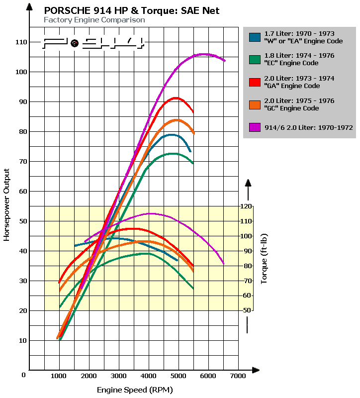

FYI by comparison for what you should be able to beat with your 2056 ....
The GA 2.0 USA stock 2.0L had better than your 88 max HP & 100 max TQ - with 116 lb/ft @ 3500 RPM & 95 HP @ 4900 RPM (DIN spec numbers) -
https://www.excellence-mag.com/resources/specs/367
FYI - Porsche USA stock numbers chart:
.... IIRC this is from the Porsche Chart(s) & made up by p914.com
1973 Owners Manual - with SAE 91 HP @ 4900 RPM, & 105 lb/ft @ 3500 RPM TQ numbers (ergo difference with Excellence's DIN numbers at the link above) -
IIRC SoCalAndy's (Andy T) prior yellow `72 914/4 with a twin 2-throat Carb (Weber?) 2056 cc turned out 125 HP, from what he told me - but that was +/- 7 years ago (prior to his current M471 yellow -6).
So maybe the current owner of that car &/or Andy T may know his old 2056's numbers, & whether it was crank or rear wheel.

Don't forget that the standard for manufacturer dyno numbers changed in 1972. All the 2Ls prior to 1975 were rated at Gross (the old rating carried over), but Porsche had to go to the new Net rating for the '75 and '76 because of the re-rating for emissions. I believ there was also a compression ratio decrease?
For what we're doing today, Id' suggest stock ratings for the 2Ls should be compared to pre-75 numbers.
