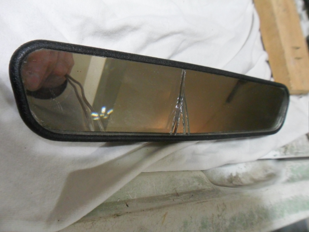

I found this gem in a box of parts I bought last Sat. It's an early interior rearview mirror in very good shape, but the glass is cracked.
Can this glass be replaced? Source?
Thank you.

Possibly by a local automotive glass & mirror shop, but they're still available new & used all over, & it may not look perfect after being opened up - depending on the shop tech's skills.
It's the same mirror as used on 1960s-70s 911/912/912E/930 cars too.

I would bet it can be. I had a 2004 BMW M5 that had an issue with the rear view self-darkening mirror. They wanted like $500 for a new mirror. I located a place that repairs rearview mirrors on-line and they replaced the glass for about $110 dollars. That was maybe 8 years ago. I do not recall the company name and gave the receipt to the purchaser when I sold the car.

I asked this same question about two weeks ago. I was told that I might be able to socten the rubber that holds the glass in by heating it in boiling water. Didn’t work.

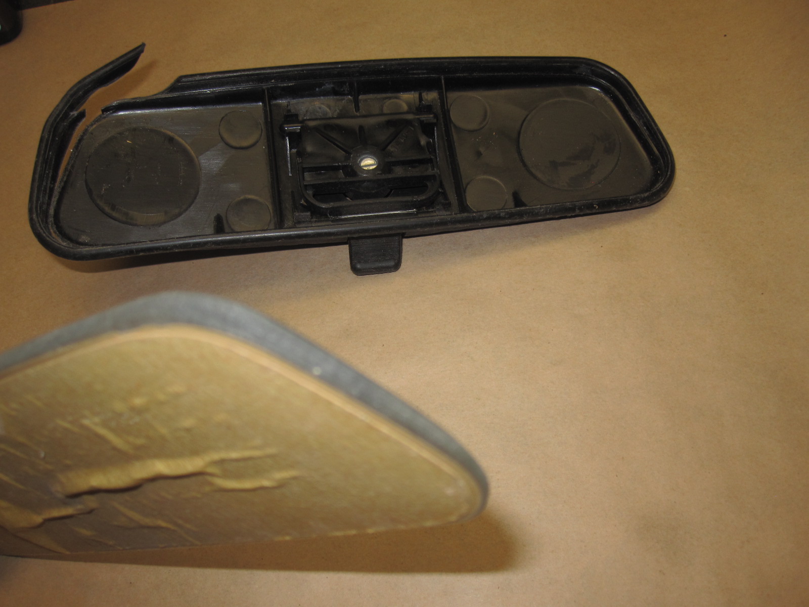

The plastic is very tough.
I ruined one in the interest of science.
It was wobbily anyway so hacked it up to see the innerds.
It must have been assembled originally as a pliable shell because there is a screw
inside that is inaccesible after the glass is installed.
The wobbily mount was easily remedied (loose screw) with the glass removed.
Immerse in boiling water to allow assembly ?
