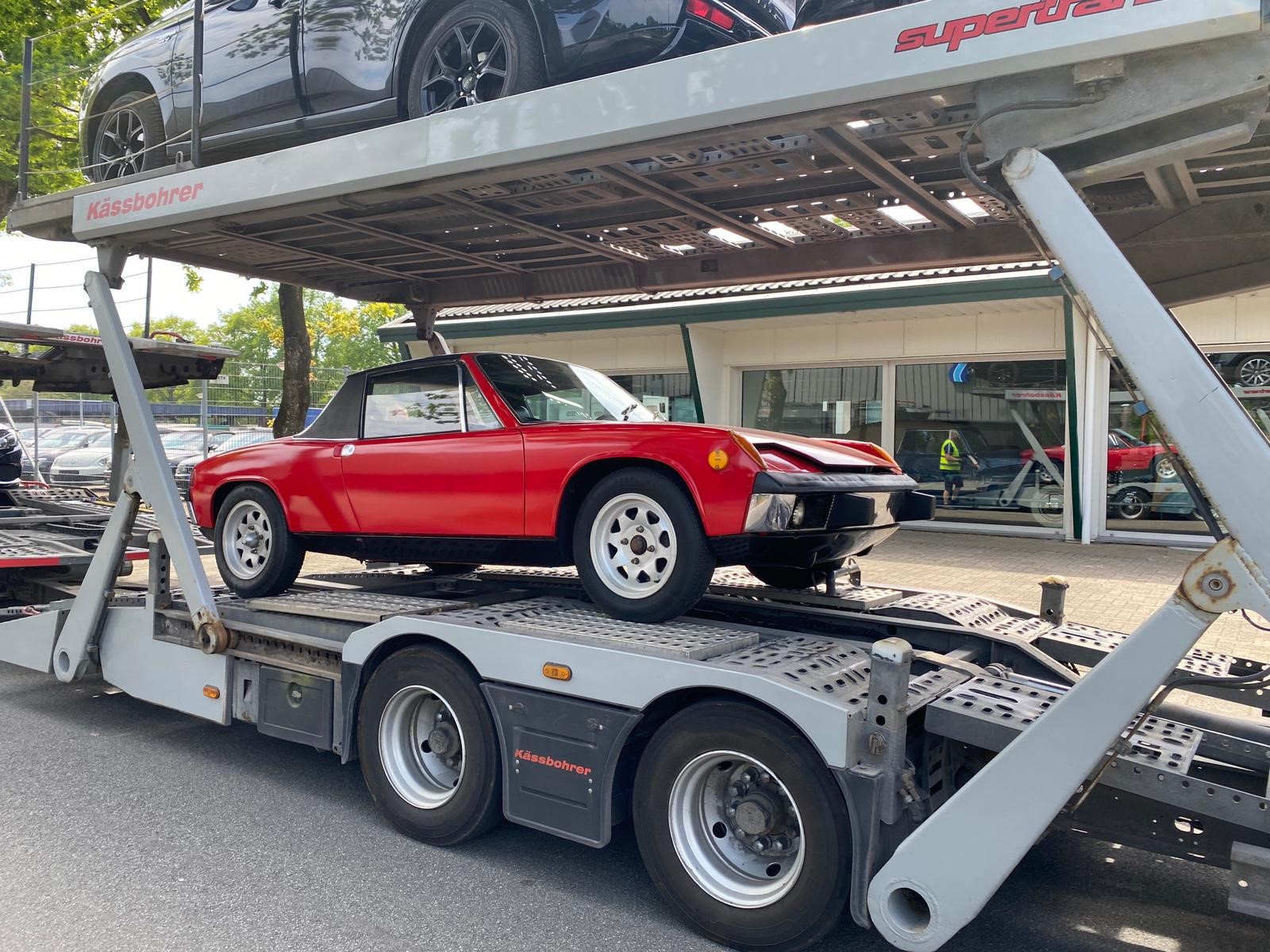

My 914 is finally here! The condition is not as bad as I feared, but is also not as good as I hoped. But as it was always going to be a project car, I’m not yet having much too buyers remorse.
Originally a yellow car, but has been painted red (horrible quality, even the side markers have not been removed, only taped up and the painted etc), but by the looks of it, the longs seem to be pretty solid and most body panels look good. I haven’t removed the rockers, but from my first view, only surface rust. Has travelled from California to the Netherlands and now in Estonia. There is something fishy with the front end though – the hood is not flush with the front wings and also the lights sit somewhat lower. Could be that the front has been crashed and then badly rebuilt, but I’ll tackle that much later – first must get it registered and get it running.
The engine runs, but I have no idea when the oil was last changed etc, so not trying too much at first – will replace the oil and see what’s what.
Of course as a new owner, I have multiple questions and hope you can shed some light for me:

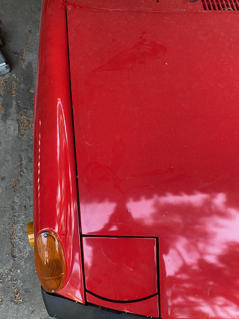

The lights can be adjusted as well as the trim in front of it so that might not indicate an accident.

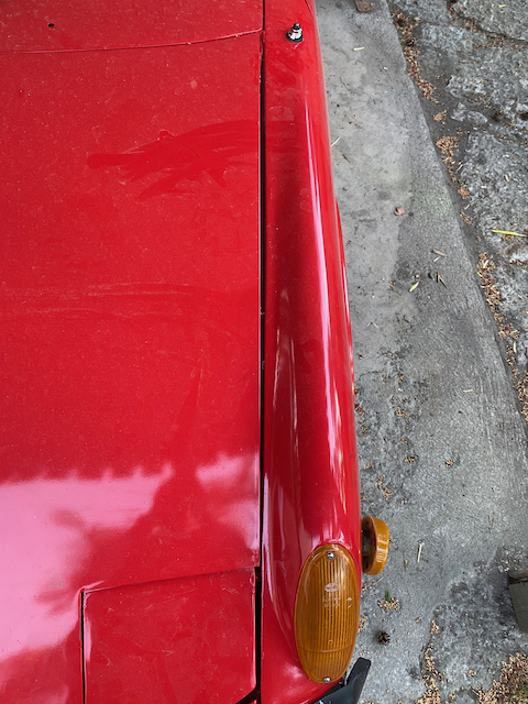

QUOTE(devil @ Jun 8 2021, 04:52 PM) *
Forgive me for stating the obvious here, but the photo shows the front hood/trunk unlatched. Does it just need to be pushed fully shut?

QUOTE(flipb @ Jun 9 2021, 06:04 AM) *
(IMG:style_emoticons/default/agree.gif) I thought the same thing. May just need to adjust the latch but make sure the cable is working correctly or may wind up having to pull the bumper to get back in.

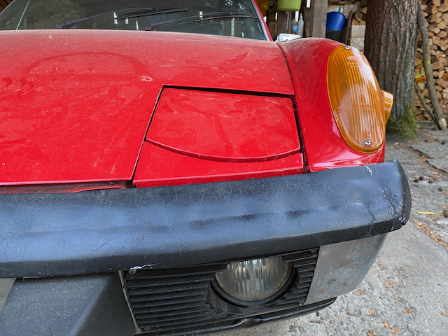

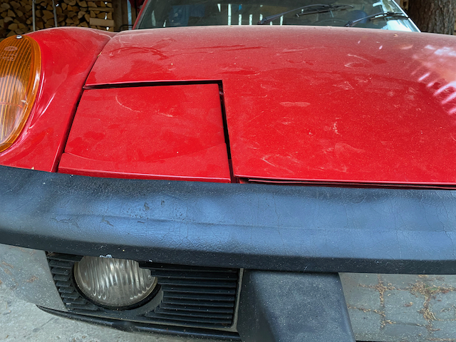

QUOTE(flipb @ Jun 9 2021, 04:04 PM) *
Ah yes, on the photo the hood wasn’t latched correctly – it seems that the hood latch cable is too short and it runs across the front trunk. I’ve ordered a new one already. But the problems are when the hood is closed.
Here are the close-up shots from the hood. Maybe some of it can be adjusted, but the fenders, lamps and hood just don’t line up nicely. And the bumper rubber top is totally shot as well.
I’ve removed the left turn signal light fixture and it seems that part of the left fender is made of bondo. Not ideal, but I’ve see the fenders available on the web, so if push comes to shove, I can have it redone.
