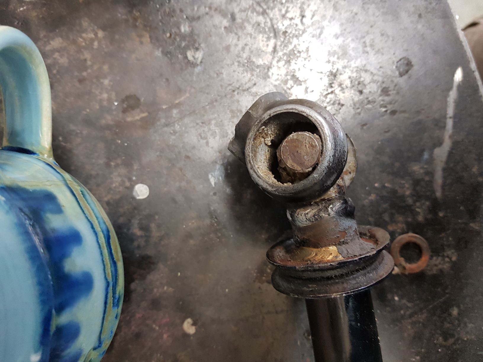

> Shift rod bushing bearing behind the knuckle disintegrated, Any luck replacing bushing
pete-stevers
post Jun 28 2021, 02:31 PM
Shinee Side Up Prep and Paint
Posts: 2,672
Joined: 10-October 04
From: Abbotsford,BC, Canada
Member No.: 2,914
I guess dealing with 50 yr old parts ... shit just happens. (IMG:style_emoticons/default/sad.gif)
The bushing gave up to ghost and disintegrated ,lucky for me I had a spare shift rod. I am just wondering what the solution is. Has anyone had luck re-bushing the shift rod

pete-stevers
post Jun 28 2021, 03:03 PM
Posts: 2,672
Member No.: 2,914
It is part of the shift rod that is just behind the knuckle at the firewall... giving the knuckle the ability to rotate slightly up and down.

pete-stevers
post Jun 28 2021, 03:27 PM
Posts: 2,672
Member No.: 2,914
Right here
914e
post Jun 28 2021, 03:43 PM
Posts: 497
Joined: 21-February 20
From: Arizona
Member No.: 23,951
QUOTE(pete-stevers @ Jun 28 2021, 02:27 PM) *
Right here
The ones I linked should be the right ones. Getting the pin out can be difficult if it rusted.

post Jun 29 2021, 07:31 AM
Dr. Phil
Posts: 5,907
Joined: 9-December 09
From: Kennesaw, GA
Member No.: 11,106
QUOTE(pete-stevers @ Jun 28 2021, 05:27 PM) *
Right here
i went thru this last year, biggest issue was getting that pin out it has splines on it that help keep it in place once pressed in , so you need a press. once that is pressed out,
clean it up and get the new brass bushings, much less play than the derlin ones, perfect fit, tight and smooth, also did the firewall bushing from RIX914parts. com,
or use stock Porsche or 914rubber, then get the brass one fro the console at thetransmission, and if you really want smooth shifting, get the whole Tangerine racing shift rod and rear console bushing. i think they use a different knuckle at the firewall similar to the steering u-joint.
so several options on this.
Good luck, -

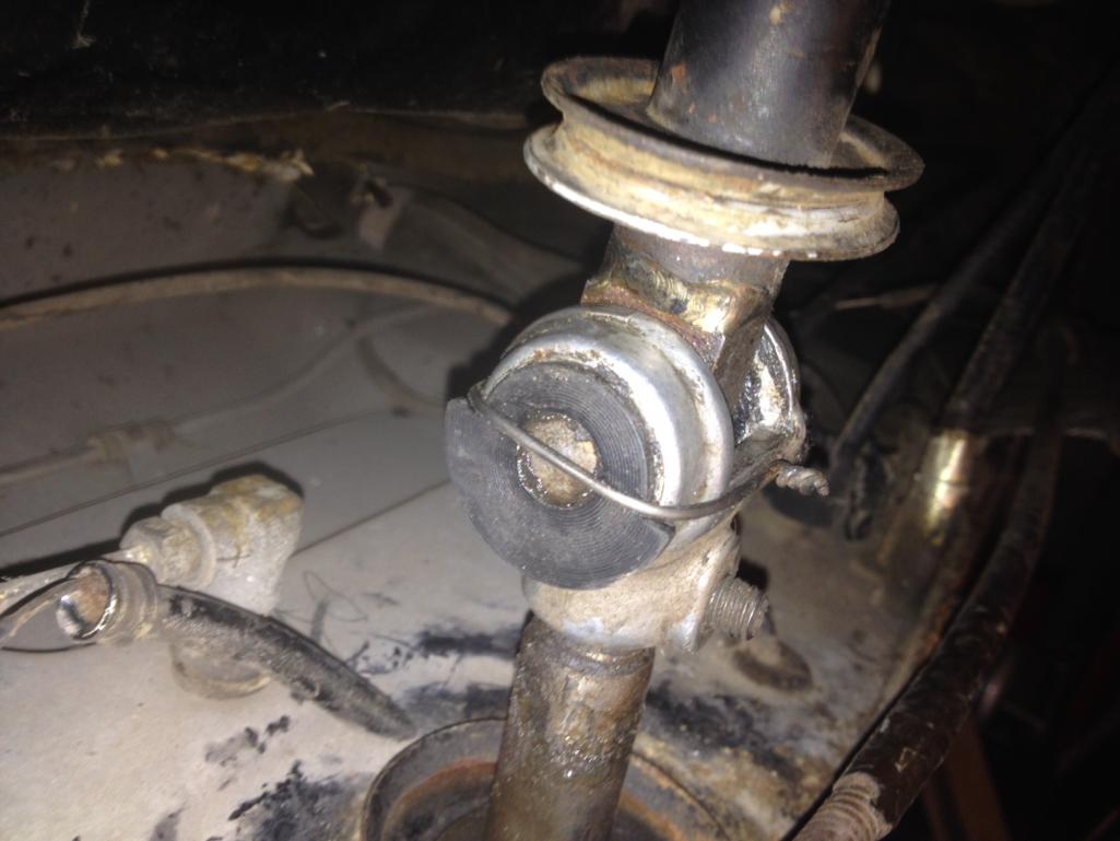

Member No.: 632
One of my favorite bushing installation photos. I guess they couldn't get the pin out. (IMG:style_emoticons/default/idea.gif)

GregAmy
post Jun 29 2021, 07:50 AM
Posts: 2,651
Joined: 22-February 13
From: Middletown CT
Member No.: 15,565
QUOTE(maf914 @ Jun 29 2021, 08:33 AM) *
Uhh, hmmm...I guess that'll work...?
