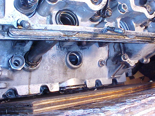

I had my motor on a milk crate- (IMG:http://www.914world.com/bbs2/html/emoticons/headbang.gif)
The crate collapsed and shifted, dennting both oil return tubes on one side of the motor. (IMG:http://www.914world.com/bbs2/html/emoticons/ohmy.gif)
This should put a kink in my 914 fantasy.
I am very disappointed. Almost sick.
I looking at a tear down to replace these things.
No serious damage just very depressing, as the motor was to go in tomorrow...

No worries. Get a couple of replacement tubes. The usual suspects sell collapsable tubes that you can install without tearing the engine down further.
Hang in there!!!!
-Lawrence

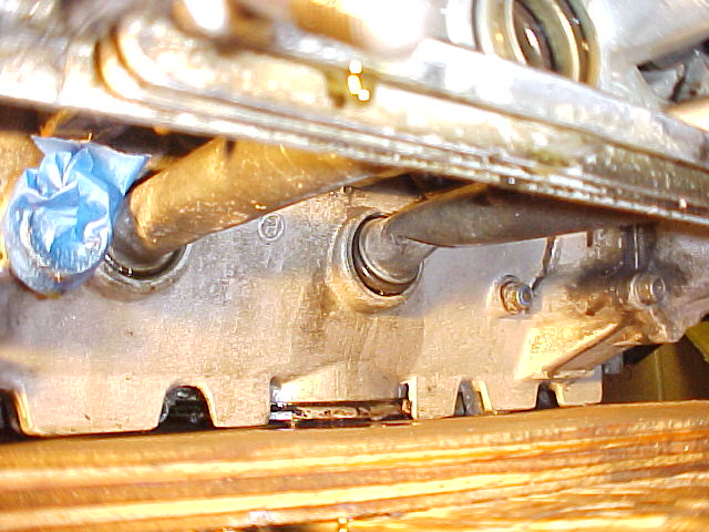

I was able to squeeze the bent one out.
Why cant they push through like on the type FOUR's?
Unless someone tells me otherwise, this baby's coming apart.
Maybe, well find out the true displacement after all.
I hurl... (IMG:http://www.914world.com/bbs2/html/emoticons/barf.gif)

Trekkor get the return tubes that collapse they are very inexpensive. I just replaced the seals on each end and the center seals too on my 911. Thanks Mark

Take a pair of channel locks and twist the tube out. There is a tech article on the bird board.
http://www.pelicanparts.com/techarticles/9...return_tube.htm

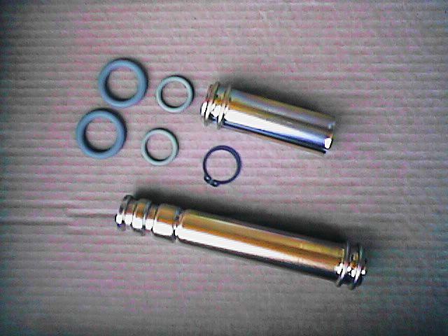

When I saw this picture...What a relief (IMG:http://www.914world.com/bbs2/html/emoticons/boldblue.gif)
I might as well do all four.

Found the price for the parts on Pelican- $27.85 each.
I'm in.

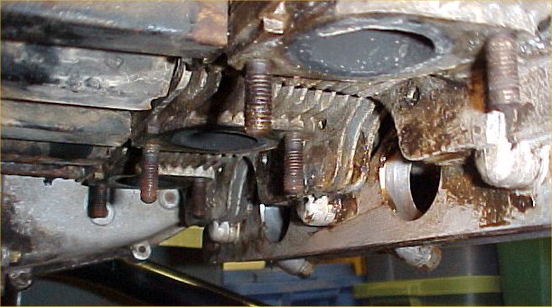

popped the other tube off.
I used these 18" channel locks I have. Just ripped it out of there. (IMG:http://www.914world.com/bbs2/html/emoticons/ohmy.gif)
