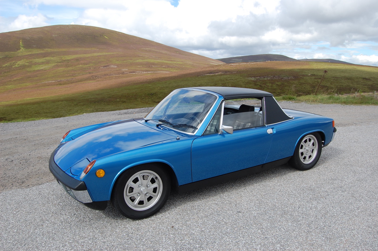

Help - my new to me 1973 1.7 Djet came running really sweet, but almost immediately developed the 'hunting tick-over' of lean running / air leak. We replaced all the vacuum pipes, found one of the inlet gaskets had a very slight leak. Seems somewhere along the line things have been tweaked to compensate for the leaks so that now they're cured, the car is running super rich. Having had a L-jet for years the Djet is new to me so any advice on where to start first would be much appreciated. Thanks ChrisAttached Image

ctc911ctc   That is a beautiful car! SUPER rich could ...   Jul 23 2021, 09:43 AM
