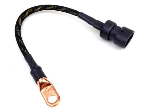

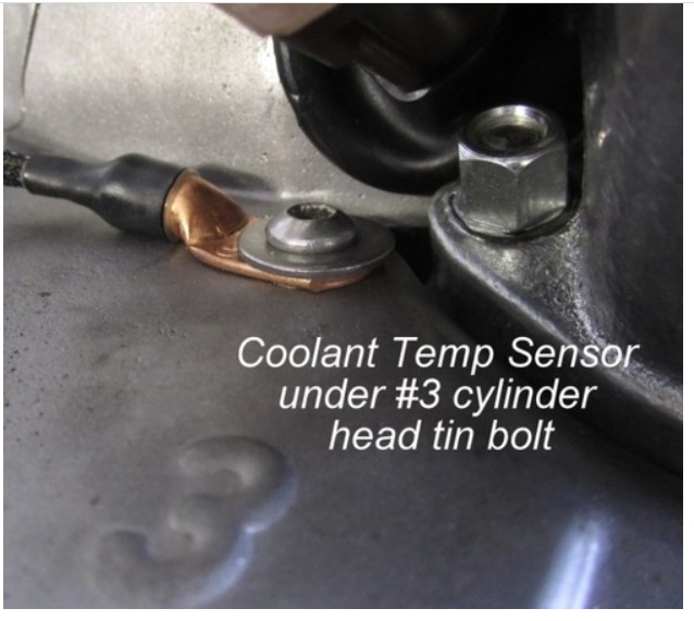

DubShop makes that thermocouple/thermister-thing for tuning warm-up on the Micro/Megasquirt. It's intended to be inserted under one of the engine tins screws (I use the one behind the #3 intake manifold). It's not intended as an accurate measurement of CHTs in the context of how we discuss them and the allowable temperatures.
One major advantage to that sensor is that it already has the pull-up built in, so all you have to do is wire it up to the MS (5V, ground, sense). It's the easy button for the purpose of managing engine warm-up and enrichment. Works great.
I also installed a standard K-Type thermocouple under the #3 plug to be used for tuning purposes, to ensure I'm not running too lean or hot. I ported that into the Microsquirt's ADC7 input via an Adafruit amplifier. It will not provide feedback to the ECU for corrections but I can log the data and later compare it to trends to see if I'm getting too hot (good so far). It can also provide warning limits if I'm using the ShadowTuner dash on an Android tablet.
So Ted, I suggest moving forward with the DubShop sensor for warm up enirchment and then work later toward adding the CHT for info.

I just noticed the Dub Shop has a Type 4 version of the sensor that I didn't notice a few months ago. Looks like the difference is just that it has a larger hole do it can be mounted in the stock sensor location. Here is the description:
Modified GM coolant temp sensor for Air-Cooled VW use. The Type 4 sensor has a larger hole so it can be mounted to the factory location with a 10mm x 1mm bolt or you can use an intake manifold stud if you wish.
This is not meant to act as or replace a proper cylinder head temp sensor

They are selling two versions. One that goes on the #3 tin screw but another special for the Type 4 that has a larger hole to bolt to the stock CHT sensor location with a 10mm bolt. Same sensor, just modified with different size holes. Doesn't seem like it would matter which you use, but I like having the option of using the stock location. Feels cleaner somehow.

I went with the one on the engine tin screw because:
- It's outside the engine tin, so very easy to access - like, right there; and
- It doesn't matter where it is, since you're going to be managing/monitoring/editing your warm-up sequence based on what the sensor shows over time.
I do not, not, not suggest you use this sensor at the stock D-Jet true cylinder heat temperature. It should ONLY be used for ECU warm up sequence.
All of the years of collective "true" CHT evaluation and limits (such as Raby's recommendations) are based on a specific thermocouple (Type K) installed in a specific location (under the #3 spark plug).
If you try to use the D-Jet location in lieu of all of that collective knowledge, then you are setting yourself up for potential problems (that location is likely to be simultaneously neither as not, nor as responsive, as under the spark plug).
Of course, if you want to install both, and develop a stastical program to demonstrate correlation between the two, then everyone that follows you would be your biggest fans...

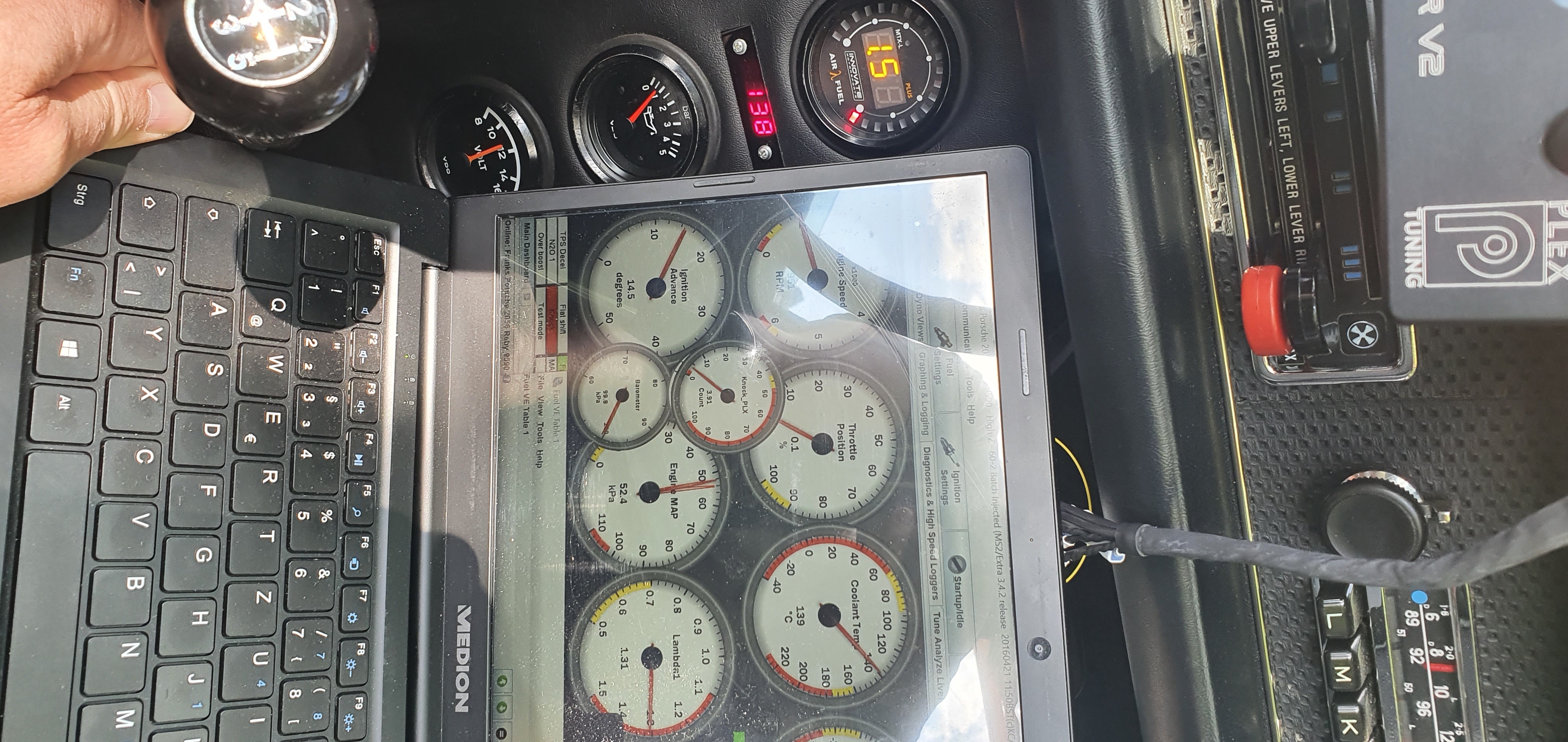

The MS doesn't care if you use Mario's sender or the one I'm using or if under engine tin or in CHT location. You just need to adapt the WUE settings and it will run fine.
Here before engine start:

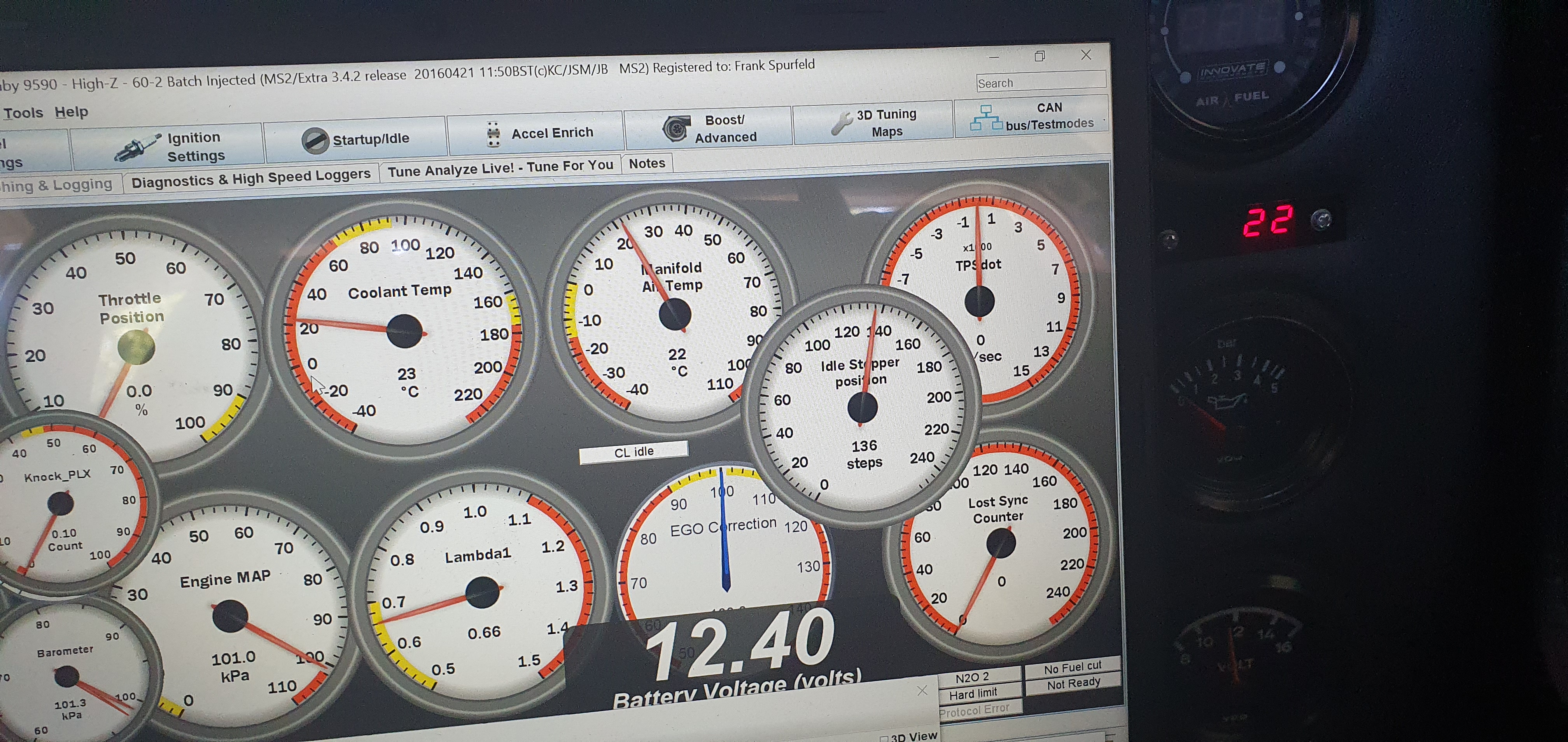

Frank S
post Jul 30 2021, 08:37 AM
Post #35
Posts: 135
Joined: 15-April 15
From: Wiesbaden, Germany
Member No.: 18,632
Region Association: Germany
And here warmed up:
You need to look for coolant temp.
This correlates up the highest temps I have ever seen 183°C
Just if you push it really hard like WOT uphil the under the spark plug sender will show a max of up to 4°C more for some time and then the other one will catch up. You never miss more like this 4°C in spikes...
It's working absolutely flawless.
But again, I'm not using the OEM heads!
