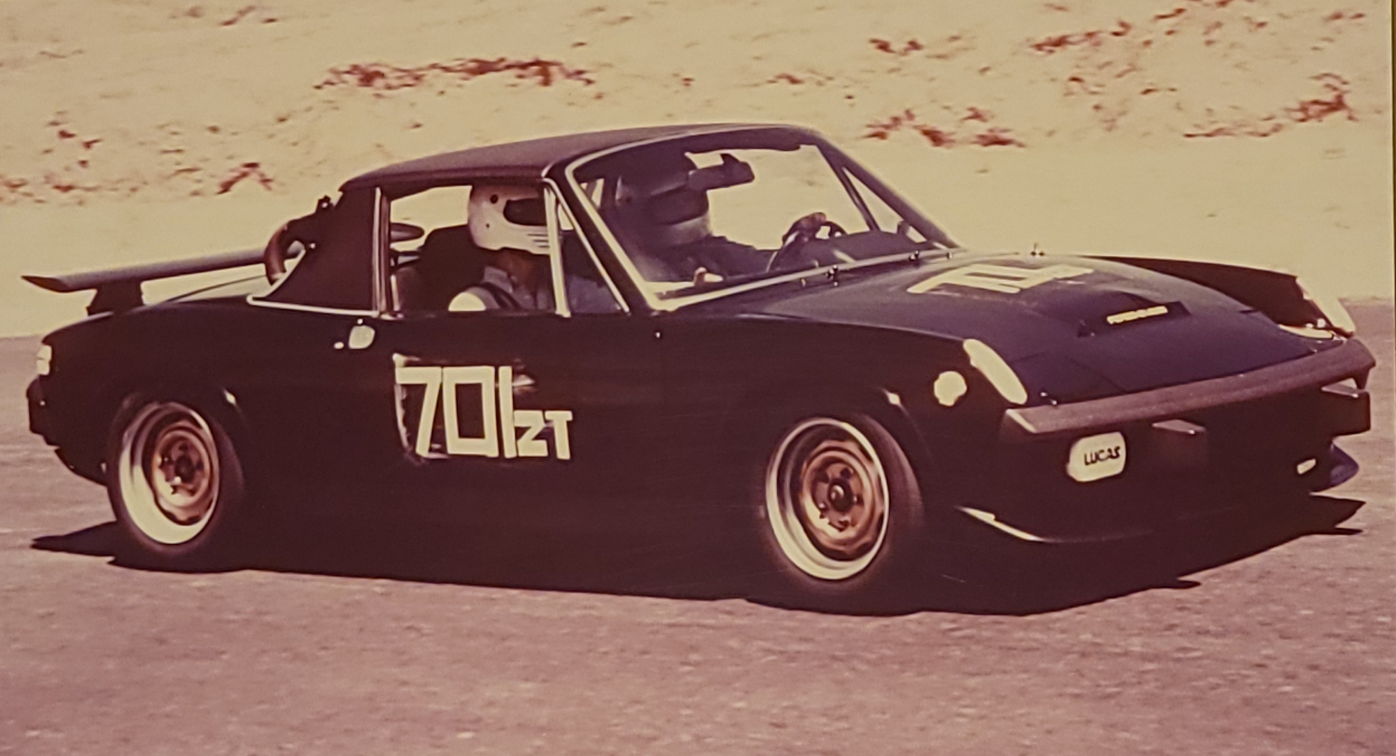

I tried this simple air scoop attached to the right side targa sail panel in the early '80s; it worked well enough to feed cold air into an intercooler mounted near the battery tray.
After the (undersized) intercooler blew its hats, I just mounted the largest available Spearco/Blackstone intercooler, popping through the rear trunk. At speed that brought an intercooler temp differential of over -100°f between inlet and outlet of the cooler.
