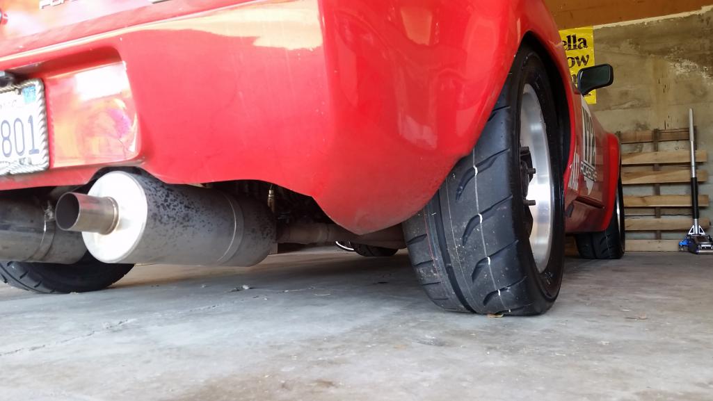

Toyo Proxes R1R. 205/50 15 and 225/45 15. Sidewall ok in front, a little squat in the rear.

QUOTE(roblav1 @ Aug 25 2021, 06:55 PM) *
Yep, saw these and I probably won't be doing too much wet weather driving here in NorCal. How's the day-to-day ride on those? I'd love them in the twisties, just wondering if they're particularly harsh on regular streets.
The backs as you noted were the thing concerning me, going from 60s to 45s would be pretty dramatic.

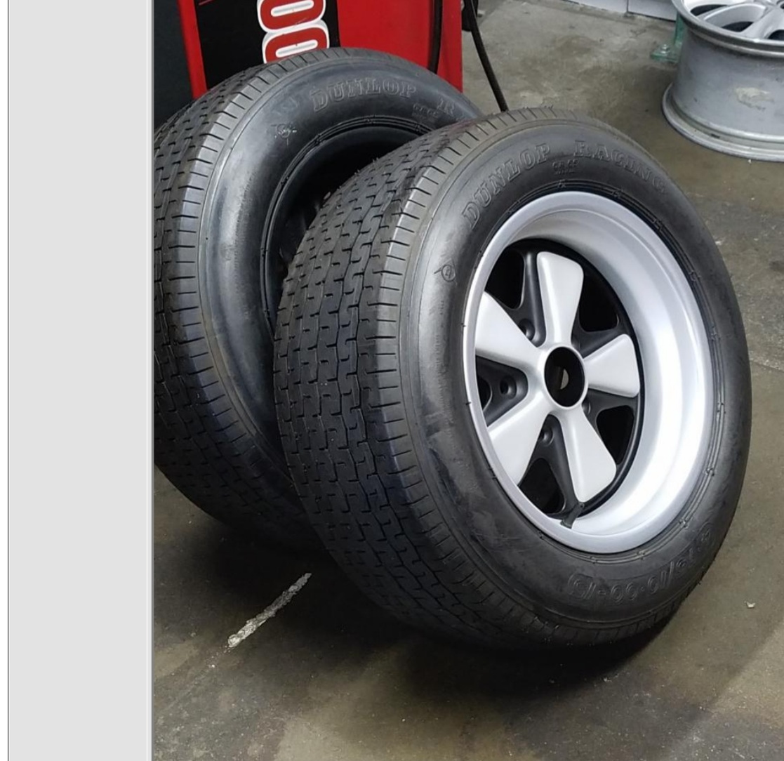

These Dunlops (race compound) are period correct, and still available. This set of 4 were shipped in from a UK tire dealer, less expensive than some USA race tire shops!
roblav1
post Aug 25 2021, 10:17 PM
Posts: 528
Joined: 18-September 12
From: KY
Member No.: 14,943
QUOTE(Genau Autowerks @ Aug 25 2021, 11:10 PM) *
Not too harsh to me and am running 200 lb rear springs and 22mm front torsion bars. Plus ARB'S. Compound is soft, and the tread looks like racing rain tires. Very good grip. Gearing ends up pretty low but fits my mod S cams. Got used to low gearing decades ago running a 6/28 R&P in a 66 911, and that's what it feels like. On the positive side, you'll likely not wear out 1st synchro.

QUOTE(Maltese Falcon @ Aug 25 2021, 09:13 PM) *
Cool! What vendor did you get them from over there? It's crazy for my Alfa Duetto, I can often get parts cheaper and quicker from my UK supplier as well!

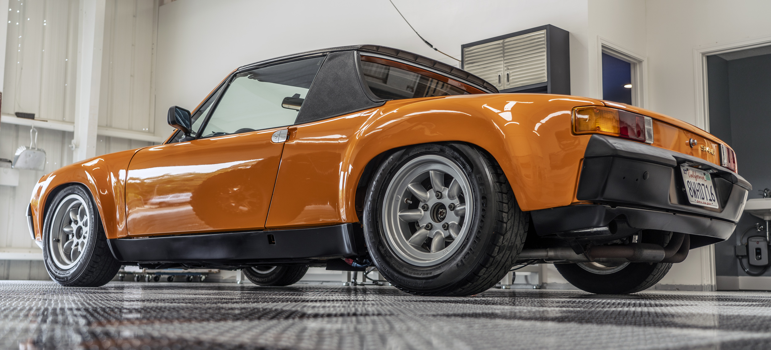

This is a very muscular looking 914! (IMG:style_emoticons/default/aktion035.gif)
