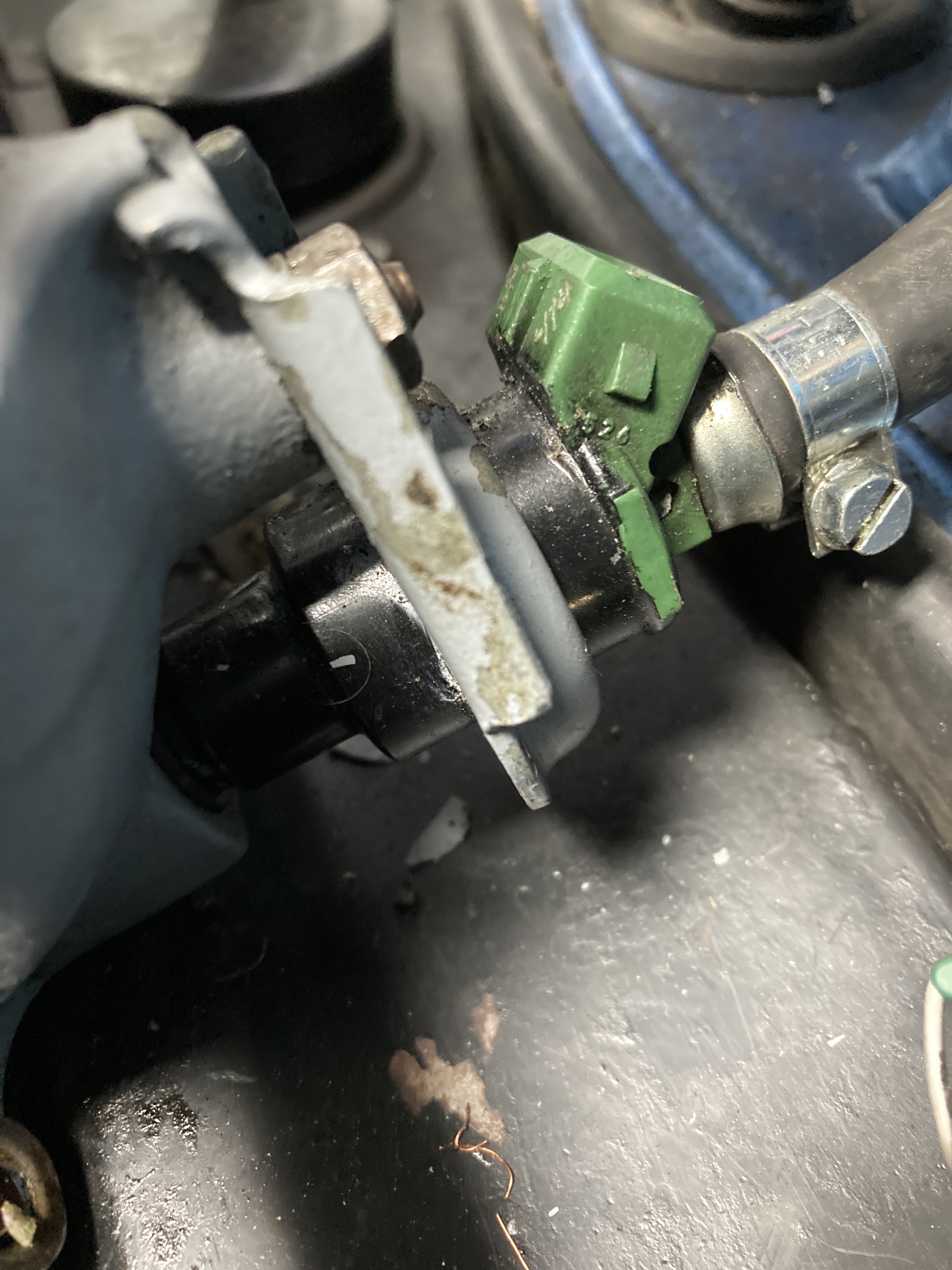

Anyone have experience with these injectors? I have them fitted to my recently acquired 73 1.7 with standard Djet.
My car is currently running very rich / flooding and the injectors are heading to a local specialist for testing as we suspect one of them is sticking.
The alternative is they are the wrong spec for the car. Anyone else run them?
https://www.fiveomotorsport.com/hose-type-e...ro-asian-sport/
They are the 380cc type.
Thanks,
Chris

Nice you figured out what they are. That is almost 100cc too much for a 1.7.

I believe that green top injectors are for the 1.8liter engines. The yellow top ones are for the 1.7 liter engines.

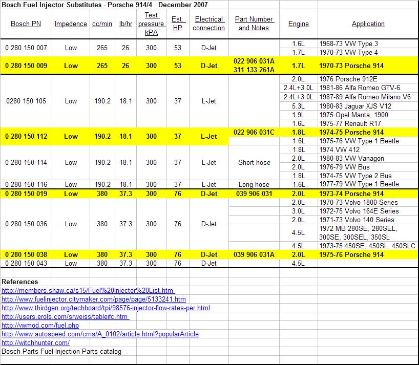

Green 2.0, yellow 1.7?
Replacement , I put these in my 2.0 while the Bosch we're sent out for service. Fj67 worked well. No issues. Add the seal kit.
Maybe check the FJ114?
2.0 standard FJ67
https://www.rockauto.com/en/parts/standard+...l+injector,6224
1.7 standard ( FJ114. 1.7)
https://www.rockauto.com/en/catalog/porsche...l+injector,6224

QUOTE(emerygt350 @ Sep 2 2021, 06:57 PM) *
OK, that would account for our inability to trace the rich running / flooding. I did see in correspondence from the PO that the supplier claimed they were compatible with a 914 1.7 Djet. I was hoping maybe that one or more of the injectors were either sticky or leaky but I guess what you're suggesting is they're not compatible at all.

sholman5
post Sep 4 2021, 07:59 AM
Kraut burner
Posts: 191
Joined: 11-September 16
From: Ormond beach, Fl.
Member No.: 20,391
QUOTE(Halfnelson @ Sep 4 2021, 06:16 AM) *
QUOTE(Dave_Darling @ Sep 3 2021, 08:23 PM) *
No, they are compatible--they spray a metered amount of fuel just fine.
It's just that it's the wrong amount for a 1.7 engine. They can probably be made to inject the right amount for a 1.7, but it will require work to the rest of the FI.
It's a fine difference between "compatible" and "correct", but it's there. Especially if you are selling the parts.
--DD
Thanks Dave - would this be a complex way of doing things or would it be simple ie tweaking fuel pressure? I would need to order replacement injectors from the US so that would take a while so if tweaking is relatively straightforward that would be an option for sure.
What is the correct metered about a 1.7 injector should deliver?
