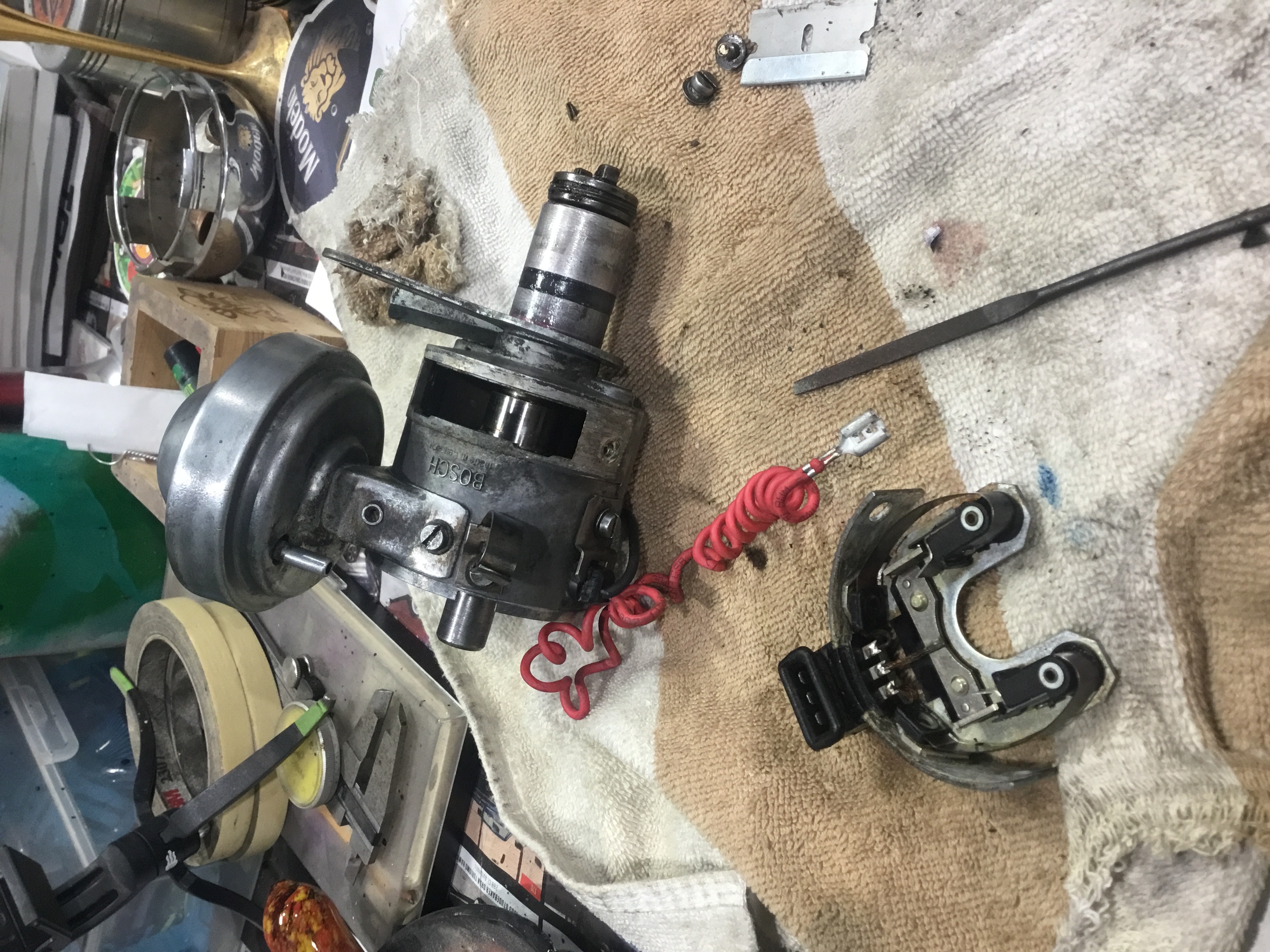

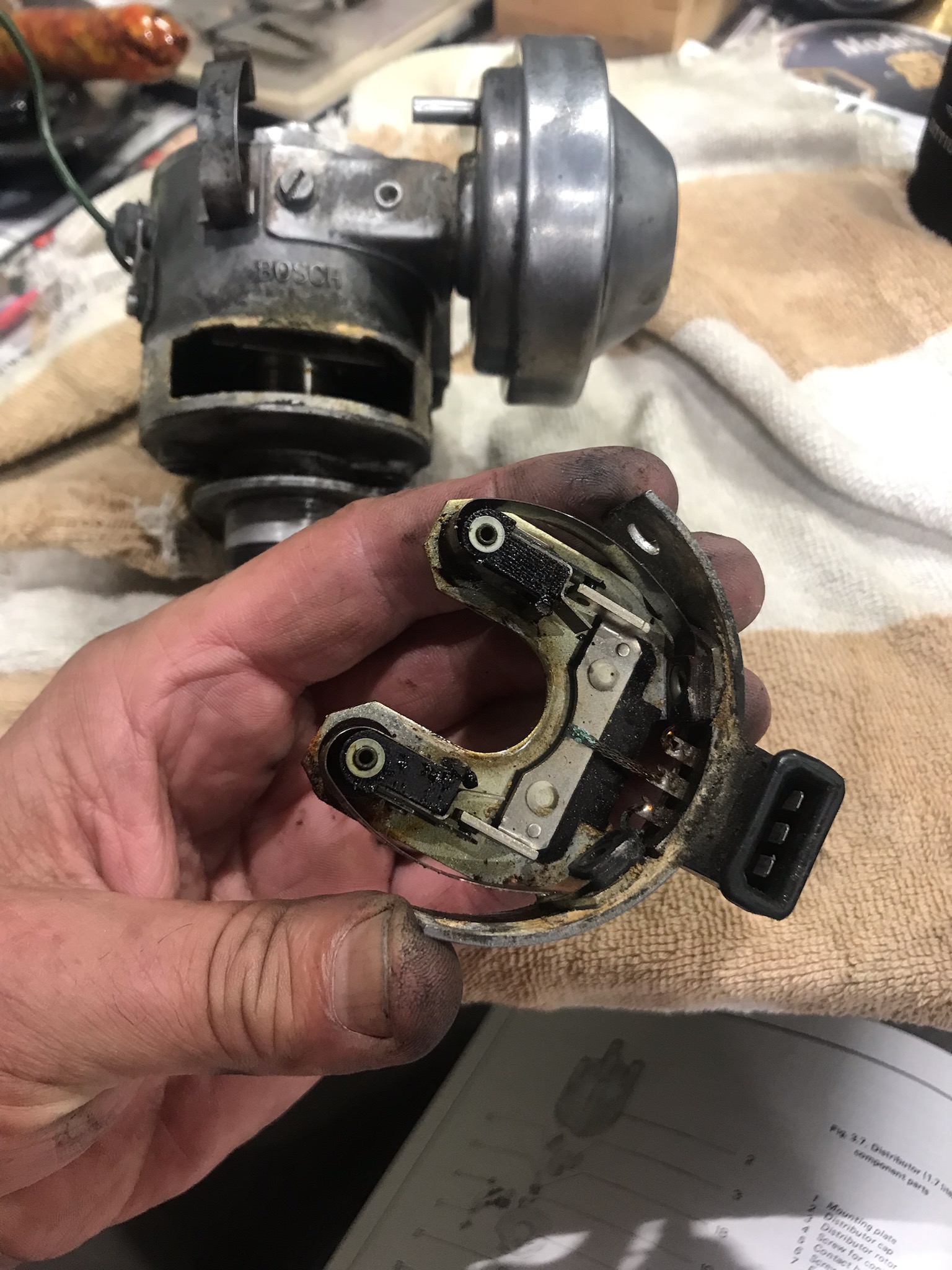

My Fuel injectors stoped firing? I pull the dizzy cleaned the contacts too, 2 started working, this dizzy is done? What do I replace it with? #123? Part?

@Solocholo it looks like the contacts for your FI triggers are partially broken off.( or maybe I am not able to see them clearly?). There are some members who you can source them (also can re-adjust to factory spec with special tool) but reading through the comments I received it was clear that swapping in a new modern dizzy is the way to go. Expensive...but what isn't these days. Will report back later today with how my engine is running. edit....mix up in shipping. Got the wrong one so now delayed until Tuesday.
