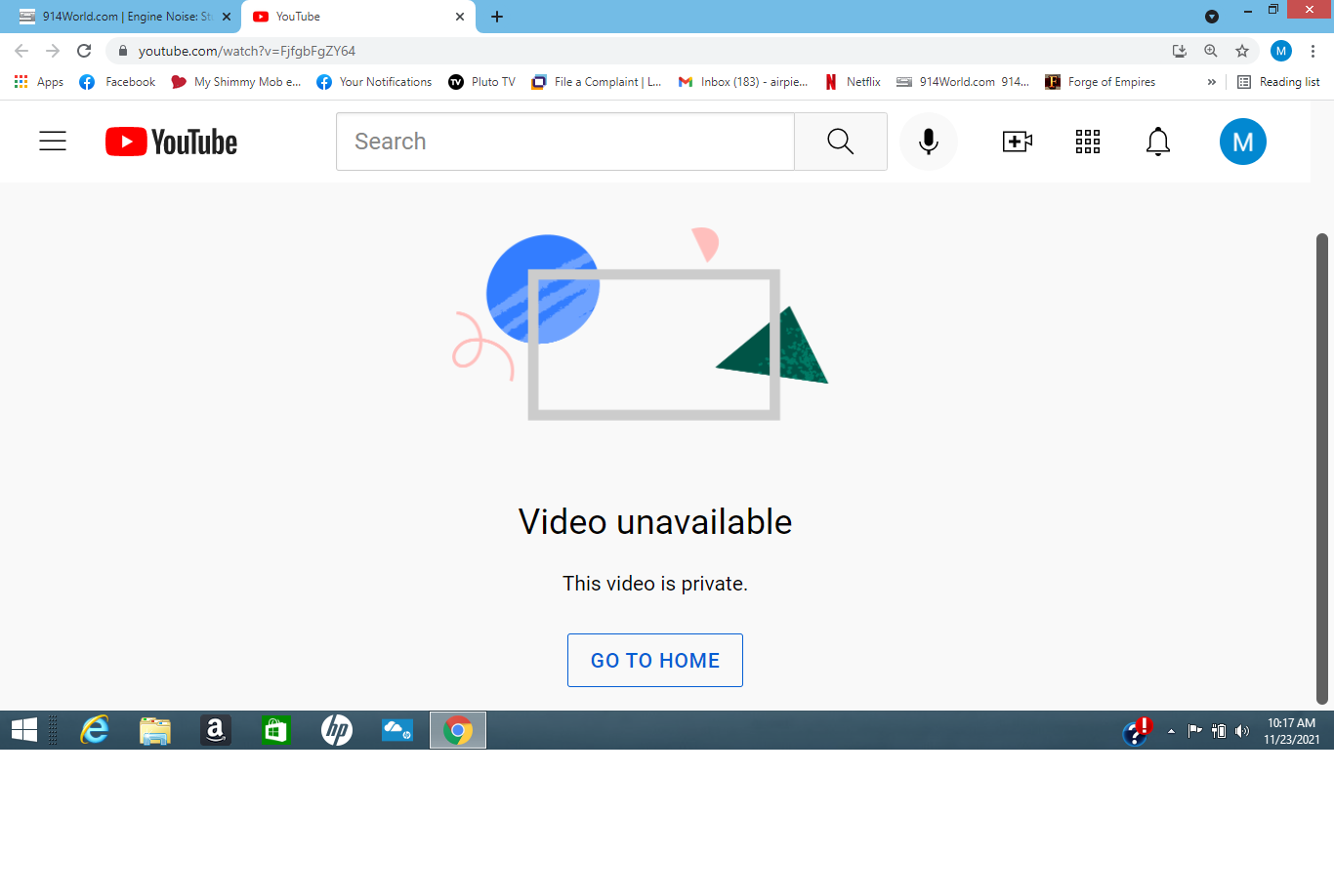

Shivers
post Nov 23 2021, 12:19 PM
Posts: 3,335
Joined: 19-October 20
From: La Quinta, CA
Member No.: 24,781
Fanmac
post Nov 23 2021, 01:09 PM
Posts: 5
Joined: 23-November 21
From: SC
Member No.: 26,102
It's fixed, please try again.
