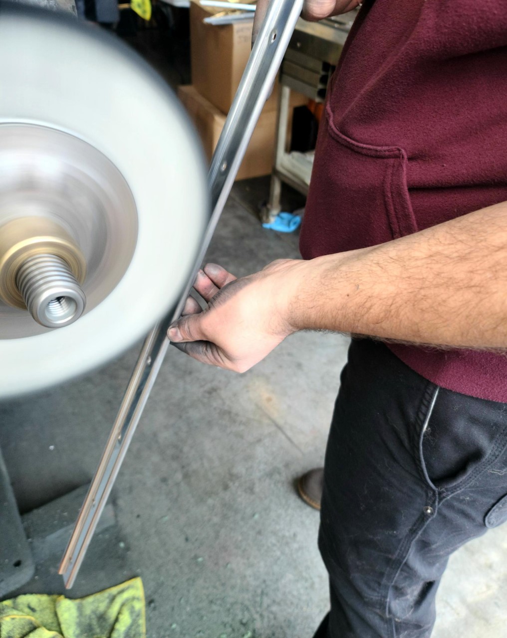

QUOTE(rhodyguy @ Dec 1 2021, 10:41 AM) *
You might give 'jeweler's rouge' a try. Pretty inexpensive. Cheaper than buying and shipping a used piece of glass (no idea how to safely package it short of building a wooden box). There are plenty of YouTube videos that show how to use rouge to polish glass.
Makes me wonder......
