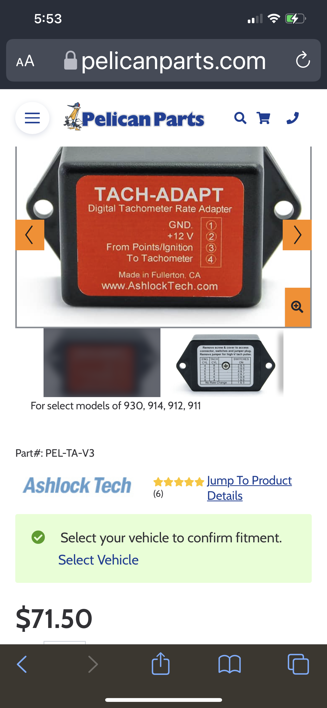

It will work fine if you buy a tach-adapt. They are about $70 and a genius little piece.

A stock 914-4 tach can be made to work with a 6 cylinder engine by using one of these:
https://ashlocktech.com/tach-adapt-1
...but your indicated redline will be different from actual, unless you modify the fascia. Other options based on modifying your existing tach or replacing the tach core are available too, and range in price accordingly.

And the owner of the device is a member here. (IMG:style_emoticons/default/beerchug.gif)
