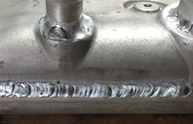

I purchased a Everlast 185DV (less than $1K) in 2018 and so far have had no issues with it. I already had a MIG welder as well. I wanted to be able to weld Aluminum and Stainless but did not want to spend a ton for something I will use a few times a year. It is 120/220 capable however to weld Aluminum I had to use 220V to get enough amps (tried on 120 and would trip the breaker) It did not come with a foot pedal (found it essential vs finger switch for a good weld) and I purchased that separately.
I have now welded Aluminum, Stainless and mild steel. I found precise prep before welding to very important. Stainless and Mild steel were easier to get decent at than Aluminum. Aluminum was very hard to learn. It took me 4 big tanks of gas to get ok. I used the welder to weld up a Vellios oil tank for my -6 conversion. I was worried about leaks from the welds but they were all good. The casting on the other hand had many spots with porosity that leaked air when pressure tested and had to weld up the porous spots. Pics of welds on Aluminum tank. So far I am quite happy with the welder, especially for the price.
