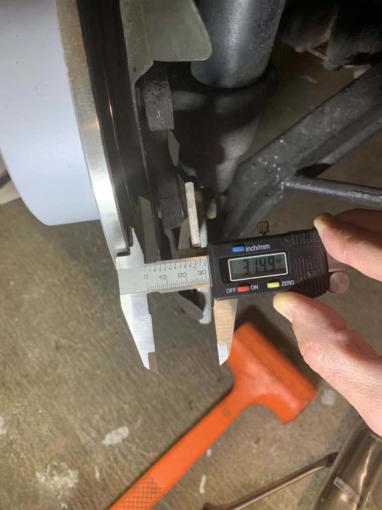

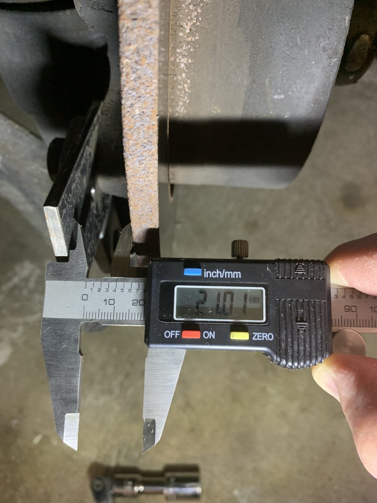

Now that I have the 914 in my shop, the plot thickens!
The stock 914 rotor inside face to caliper mounting face is about 21mm
The T1 or early 914, 5 bolt drilled rotor mounted on the '74 spindle has a rotor inside face to caliper mounting face of about 31.5mm
I don't have a set of early calipers to compare to late calipers, but I'm pretty sure that difference in offset isn't ~10mm @Eric_Shea ?
So it appears that there is a difference in calipers as well as struts (as @ChrisFoley pointed out) early vs late with respect to overall caliper offset. How much that difference was, wasn't known until now.
