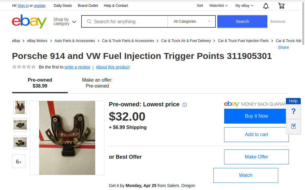

. . . . local vintage Porsche mechanic who said my impulse sender had no signal.
The blinker fluid is also hard to come by.
Signed:
Resident smart (IMG:style_emoticons/default/bootyshake.gif)
Time for a new mechanic in my opinion. I've been in the automotive industry for 27 years and have no idea what is meant by an impulse sender in the context of a 914.
It could be interpreted to be any sort of Hall Effect sensor (Crankshaft, camshaft, speedometer, ABS sensor, etc.). Of which, the 914 Fuel Injection system has zero.
Could it mean:
Injector trigger points? Maybe -- but can be obtained with some work.
Ignition points -- These are definitely available so suspect that isn't what he means.
Source for trigger points in a pinch - not completely unavailable.

I like superhawks idea... he might mean the trigger points in the distributor
like I said... anything can be found, even if its in the form of a good used one...
but you have to know the correct label for "impulse sender" before you can search one.
if you found something on the internet, maybe send us a picture of it

It can only be the trigger points (although impulse has such a nice star trek ring to it). I would suggest spending 400 on a 123 ignition as the triggers are getting to unobtainium and that will also address the points issues. The rest of the djet is available and reliable and we can help you sort it out.
Just fyi, my 73 2.0 djet was near basket case due to well meaning mechanics. It cost me about 1000 dollars to get it running perfectly. 4 injectors, rebuilt mps, new hoses, cleaning, and some new boots and gaskets, the new 123dizzy, and more gauges than god.

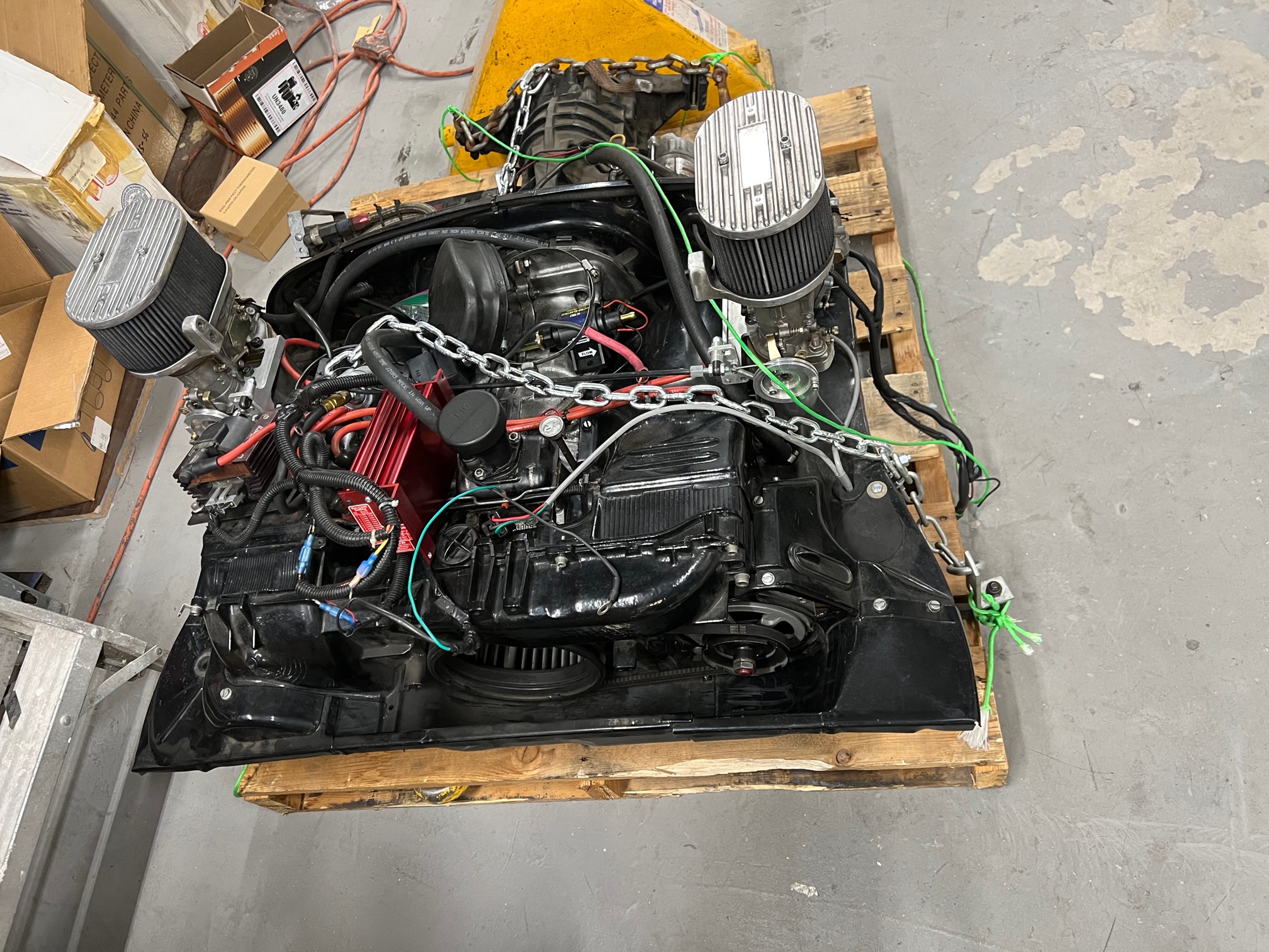

QUOTE(BK911 @ Apr 19 2022, 02:01 PM) *
I swapped over to carbs for the same reason; parts were just hard to find and I got tired of trouble shooting the FI system.
Now parts are a LOT more available, and the FI knowledge is more accessible.
However, I still do not have ANY regrets making the swap.
Cleaner engine bay and easier trouble shooting.
You can pull your existing FI and put on a set of carbs with minimal effort.
I went with the EMPI HPMX 40s.
Pretty easy install.
Ditto for me. From my perspective working with 50 years old electronics is just too problematic. I have done the conversion with several cars and never looked back.
Sure, when the Bosch FI system was new, it was unbeatable, but she has her issues when old.
