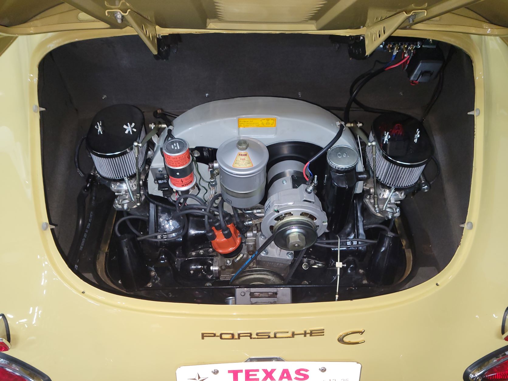

You could always go aftermarket EFI...
(IMG:http://www.914world.com/bbs2/uploads_offsite/www.allzim.com-1143-1650542915.1.jpg)
This is a kit for a 356. If you already have carbs, you can bold this on a 914 in a few hours. The only thing you will have to do is to extend a the power lead and the O2 sensor lead, and weld in the O2 bung. It will start and run out of the box, but it will need tuning because this is tuned for a 1800CC 356 engine.
I have driven a 356 with this kit. It starts with the turn of a key, it idles great with no issues, and it out performs the exact same car with carbs on it.
Check it out here: https://www.allzim.com/store/356-parts/efi-...ersion-faq.html
Or call Aaron at 800-356-2964 or 817-267-4451 for more info.
I know Aaron is working on a kit for a 914 that will use the original throttle body and runners. But it is not done yet.
