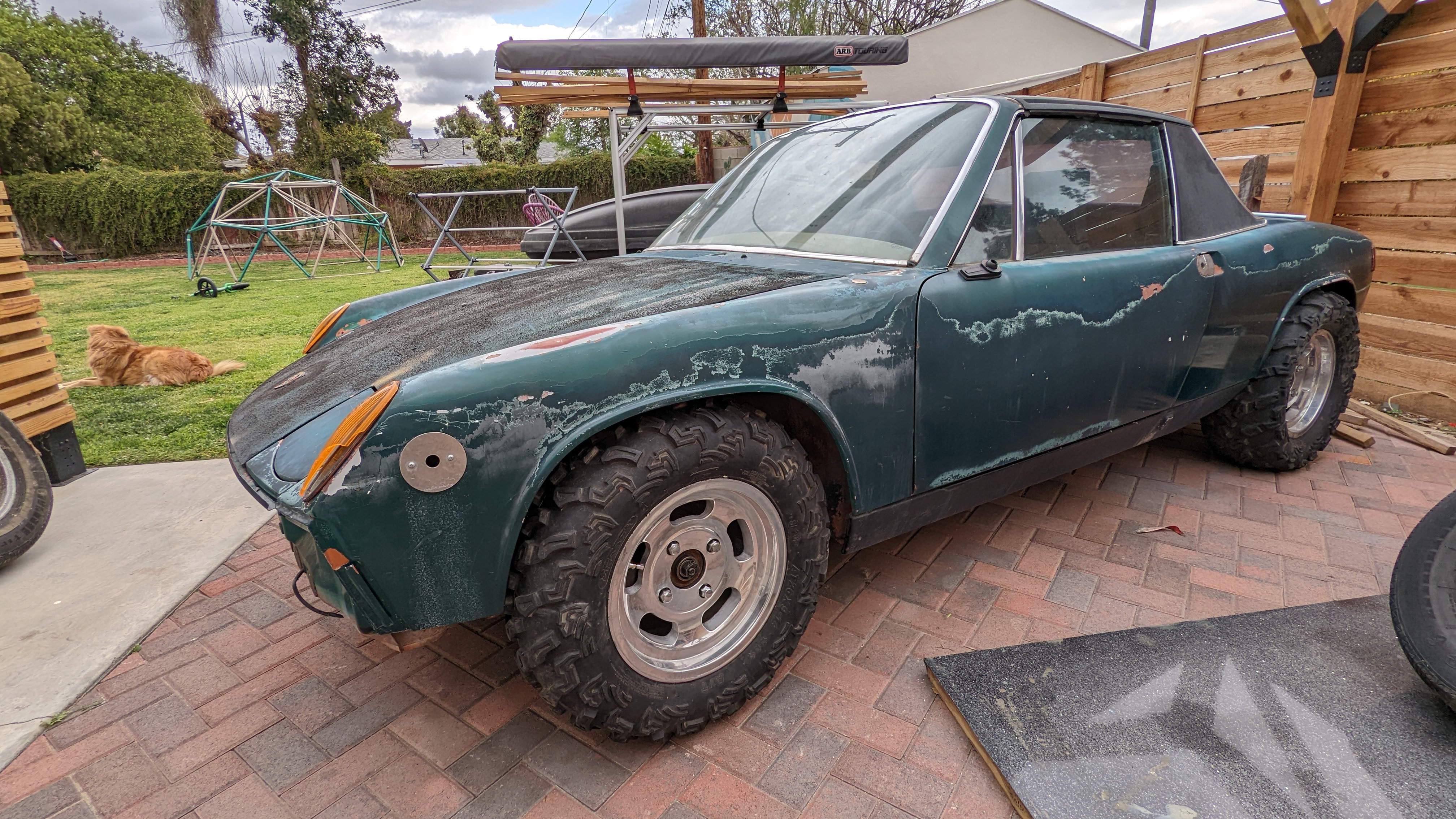

Picture of how it sits right now with UTV tires, for reference:

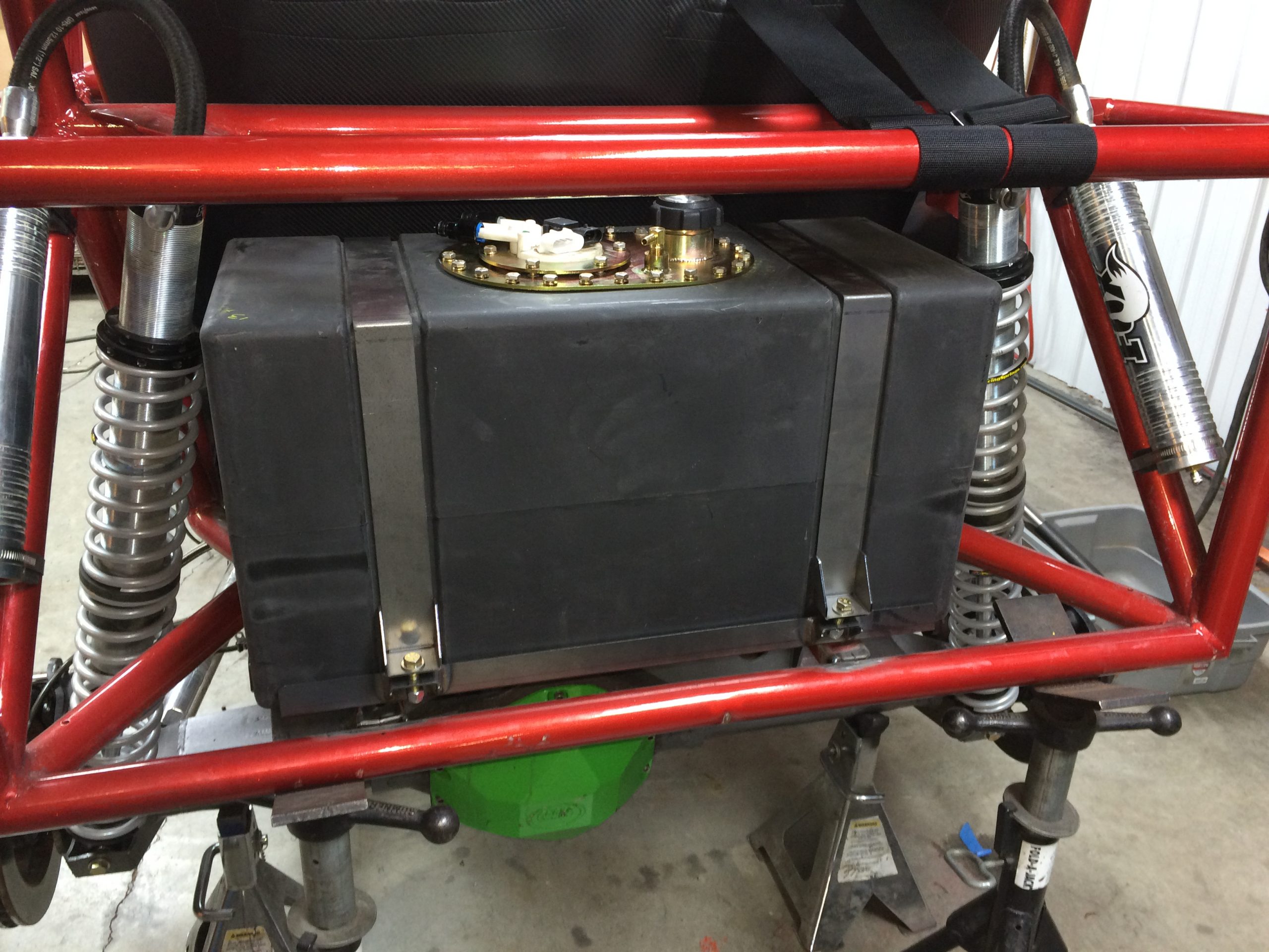

Picture of what I'm thinking of maybe doing:

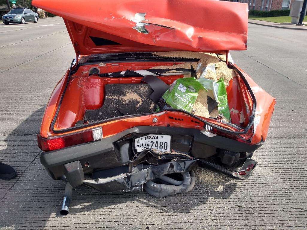

This is how I know.
I was sitting still at a light. The car that hit me was doing close to 100mph. I was pushed forward about 50 feet. The hit was hard enough to pop the ash tray and radio out of the dash.
The crumple zone in the back saved my life. And you want to put a gas tank there? If you do, please let me know your name and address so I can take out a life insurance policy on you.
Clay

Clay, I have to wonder about the bag of kitty litter in the back. Was it in the rear trunk when the car was hit, or was that the work of an emergency responder?

QUOTE(ClayPerrine @ May 10 2022, 05:08 PM) *
That is an absolutely terrible idea. The rear trunk is a crumple zone, and you would be putting the gas tank in harms way. Believe me, I know.
And putting the gas tank above the hot engine/transmission is a really bad idea too.
Leave it where it was put originally. If the tank is bad, there are new ones available, or people on here have good used ones to sell.
Clay, if there was ever a thread that warranted posting "those" pictures, this is it.

Compared to Clay's crash, mine was a minor dent.

QUOTE(Lockwodo @ May 11 2022, 11:36 AM) *
There were two bags of cat litter in the trunk. We had not unloaded them after a trip to the pet store.
Needless to say, we had to go get more litter.
Clay

QUOTE(Mendivil26 @ May 10 2022, 01:25 PM) *
@Mendivil26
What size wheels and tires are you running on there?

@SirAndy , Running 26-9-r14 in the front and 26-11-r14 in the rear. Wheels are 14in diameter X 7in wide.
I tried mounting the smallest BFG KO2s out there (215-75r15) but the front rubbed the inner fender real bad, no turning radius was left, the rears cleared relatively fine.
26.75in diameter is probably the largest diameter wheel you can have in the front without serious sheet metal massaging.
