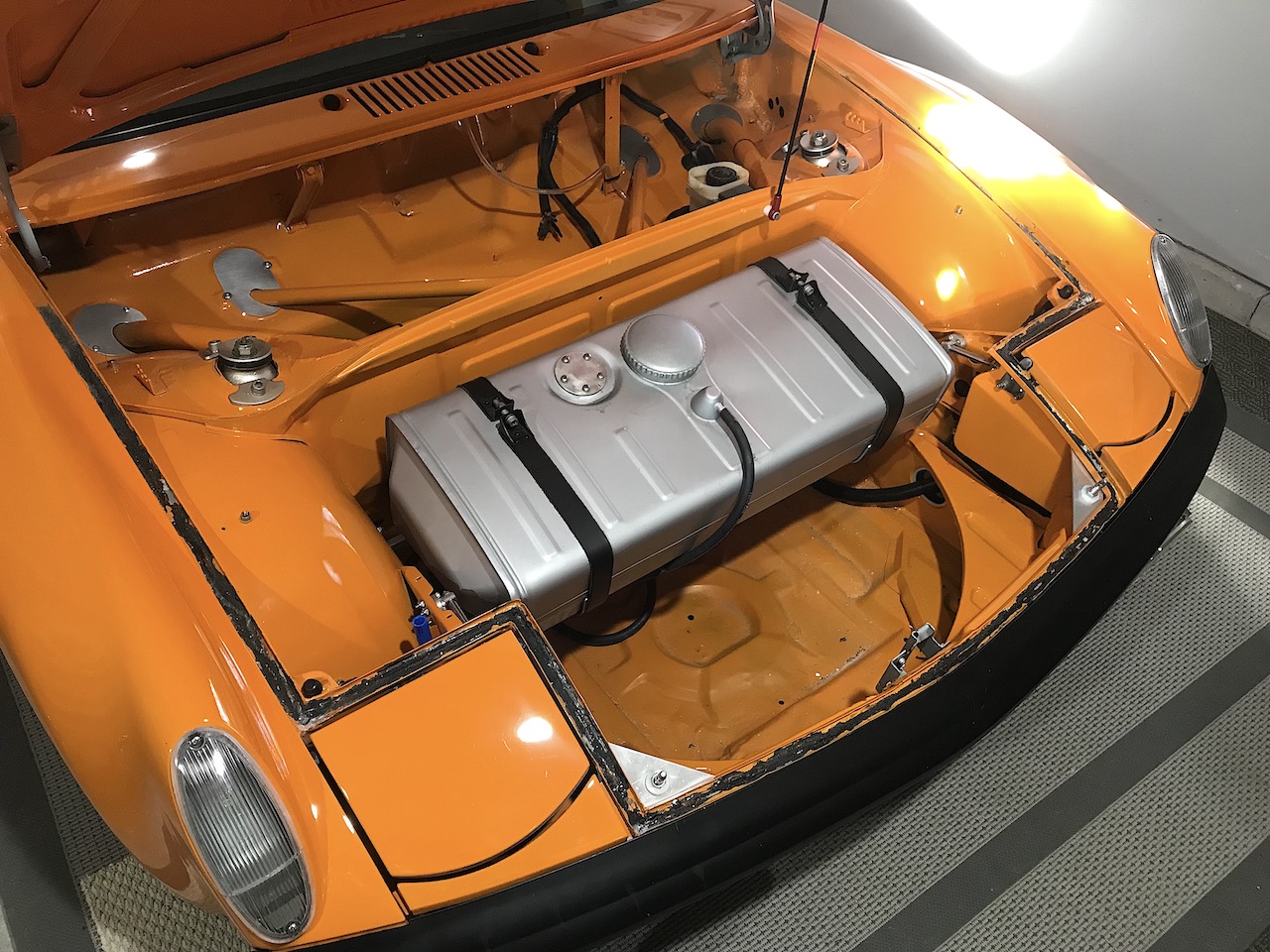

QUOTE(mlindner @ May 13 2022, 03:00 AM) *
Not what your looking for but just a different look.Attached Image
THis is cool, any details on where that tank came from?
I like the fact that it leaves space for the cage to come from the inside through the vent holes without cutting additional holes. It also looks right and not just "universal".

Yes it is a 356 tank, it was going to be a fuel cell for racing but I'm getting to old. If I stay with this I could make it so it would hold a fuel cell blatter. Also, I will install a space-saver spare for additional safety.

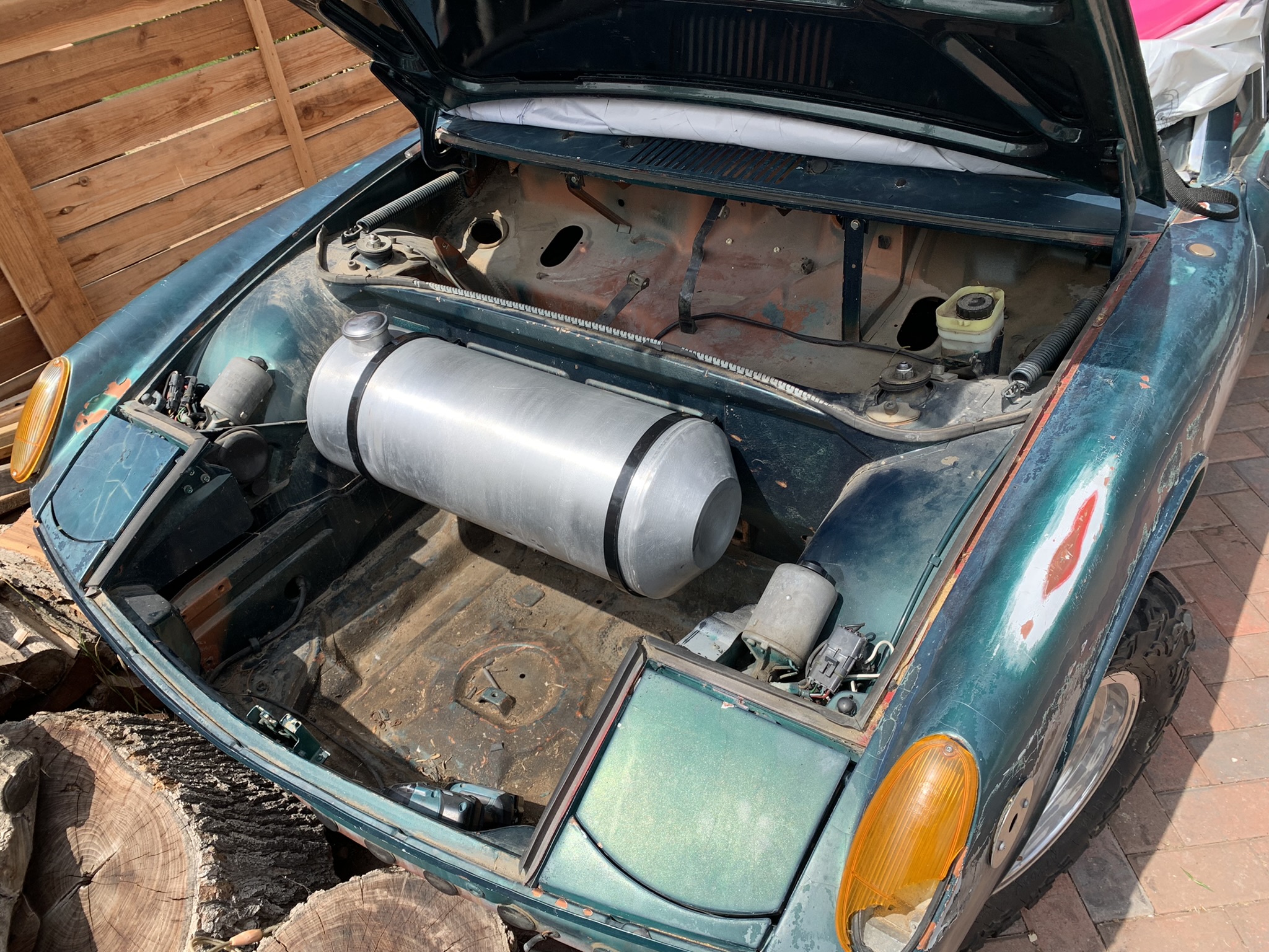

post Jun 3 2022, 12:33 PM
Post #33
Posts: 31
Joined: 26-July 18
From: Riverside, Ca.
Member No.: 22,344
Thanks to everyone for your great advise.
I found an aluminum Sand Rail Gas tank on offerup for $30 that cleaned up nicely with a little elbow grease.
I decided to install it in the frunk like @mlindner and all the other people with fuel cells while I figure out the cage fabrication and suspension reinforcements. I'll need the original gas tank location to be clear so I can route the cage through the existing holes. Once that is done I'll try to bring it back to the original location if it fits; if not it'll remain there.
I'll also reinforce the frunk area so it becomes a bit stiffer and not much of a crumple zone.

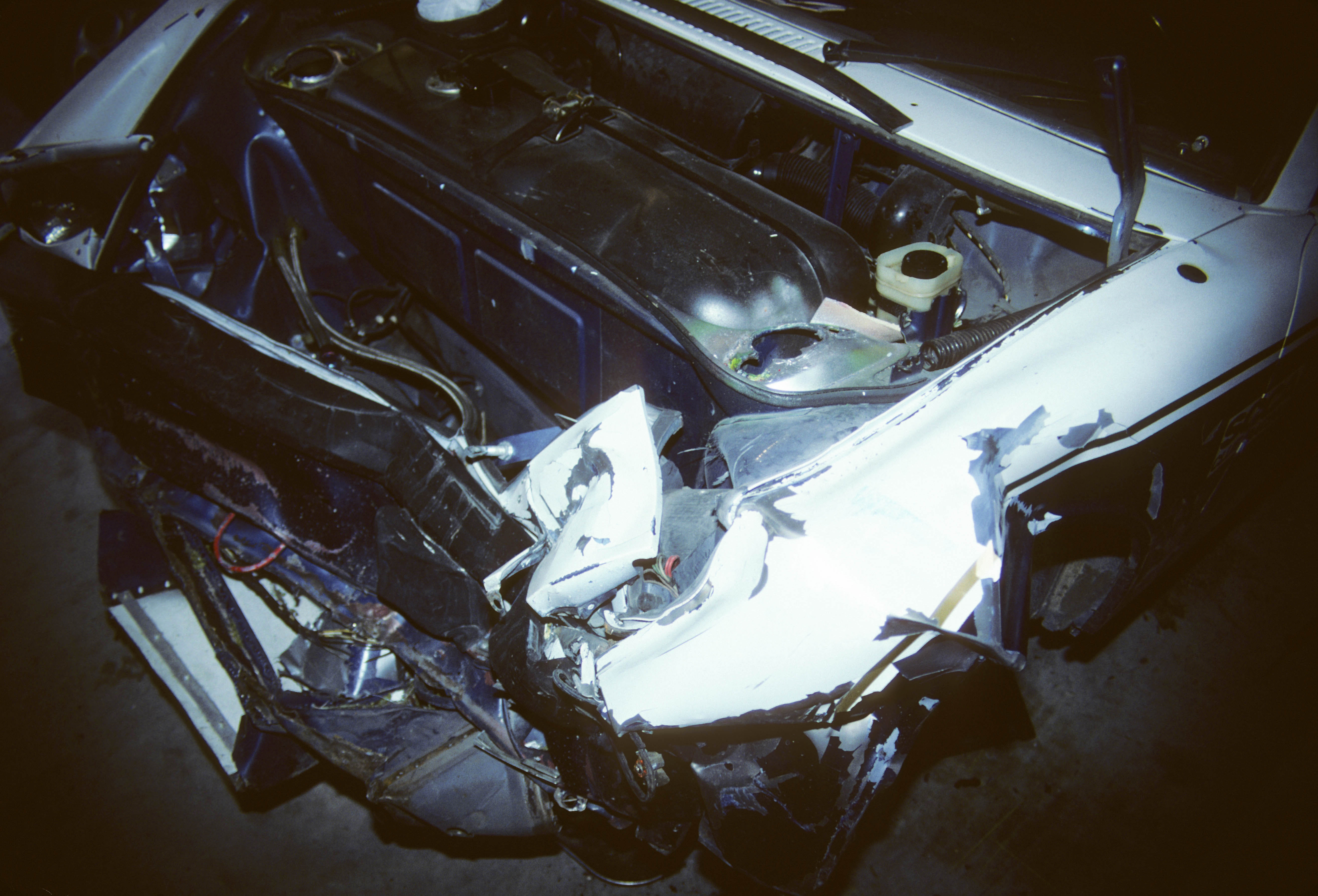

Not to rain on any parades, but the frunk also serves as a crumple zone. I proved this when I collided on-track in my SCCA-PCA race car. The front end collapsed up against the front bulkhead. The stock tank in the stock location got a small dent but was otherwise intact. The impact was hard enough to put a kink in the floor pan, and break the mounting ears from the transaxle.
I would not put a gas tank, even a fuel cell, forward of the bulkhead.
