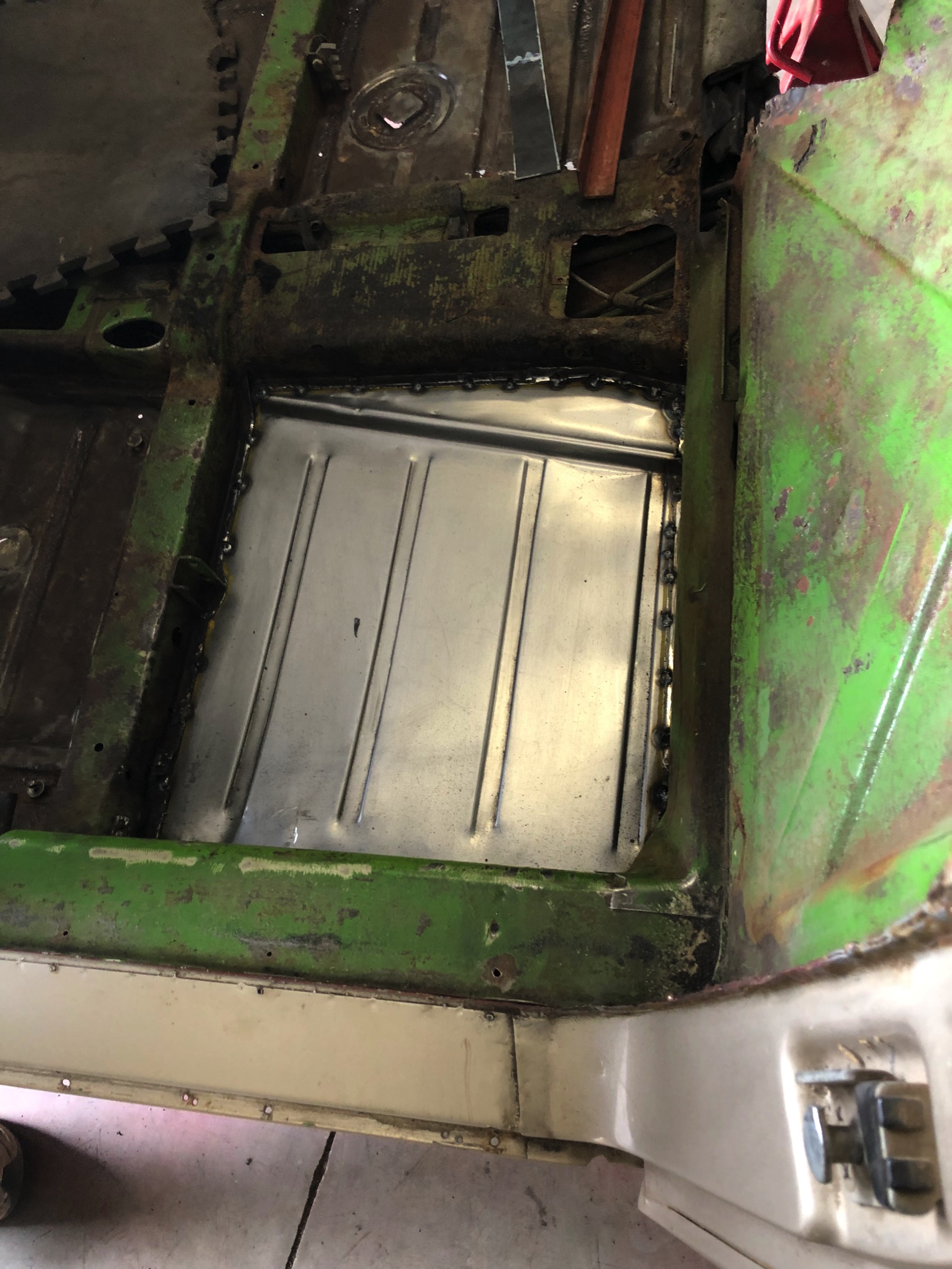

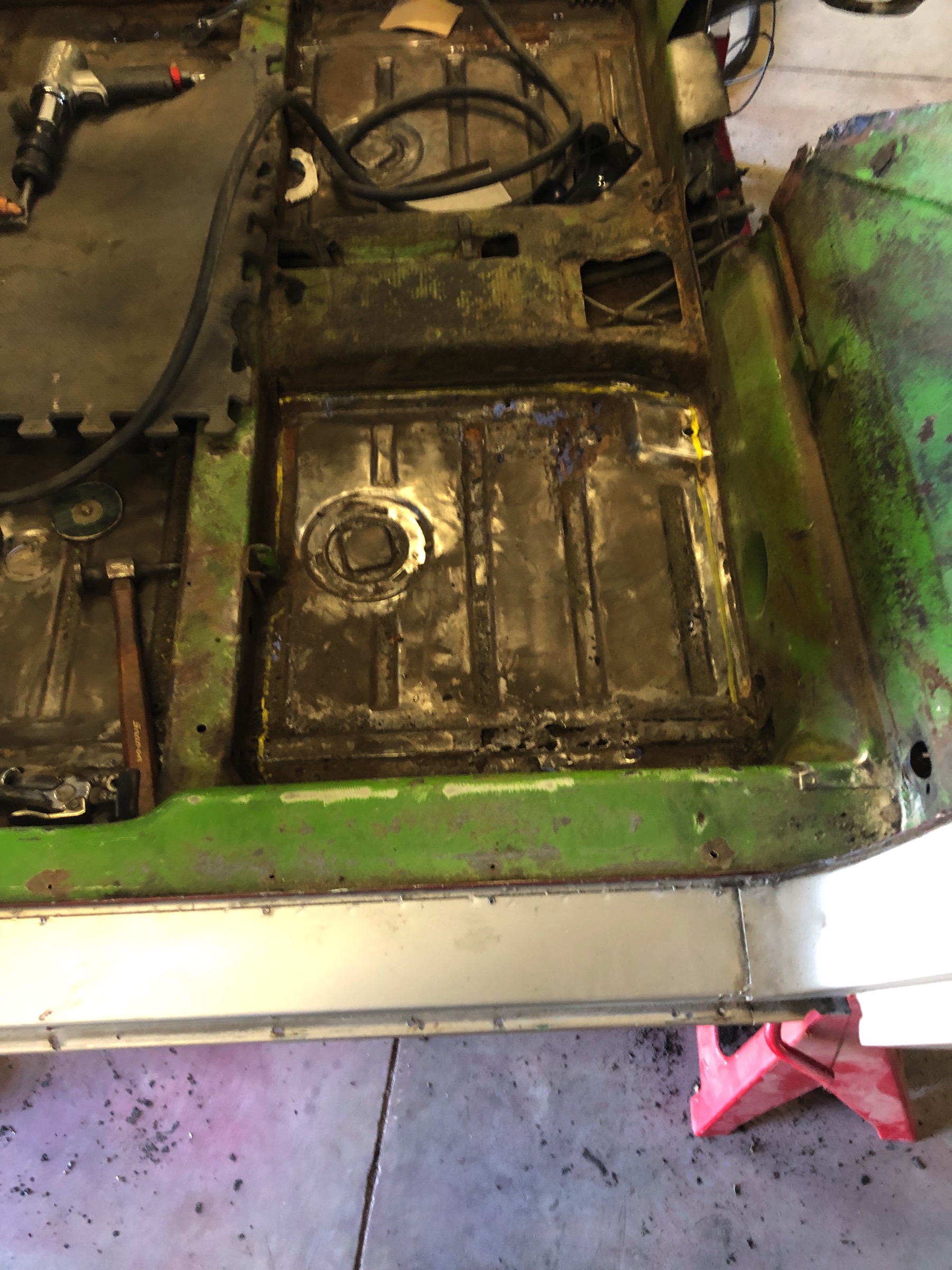

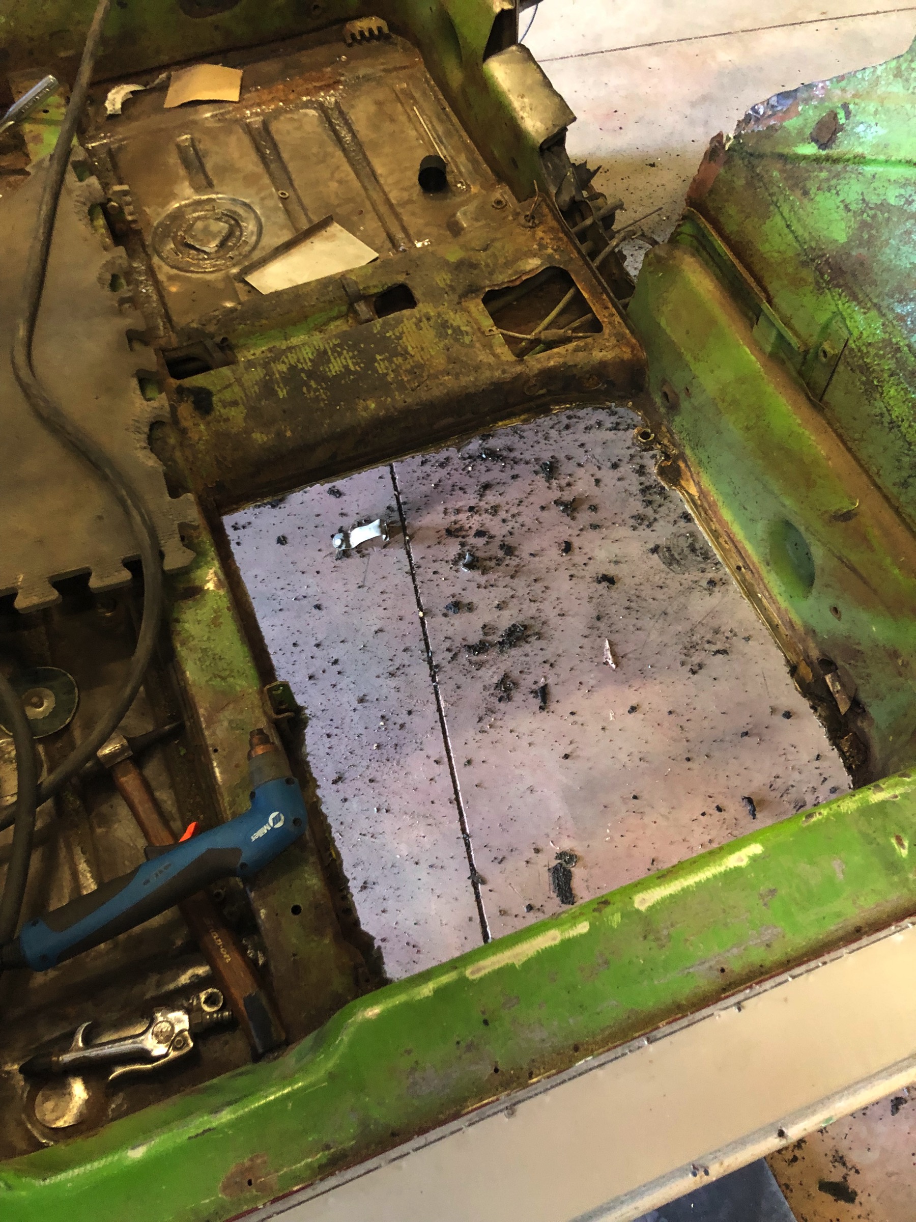

Started the rust repair on the drivers side floor pan.
Rust all cut out. For this section anyway.
Because Nothing on this car is factory I decided to make my own panel. I an a little rusty with the bead roller but.........
It will have Berliner, sound deadener, insulation and carpet over it.

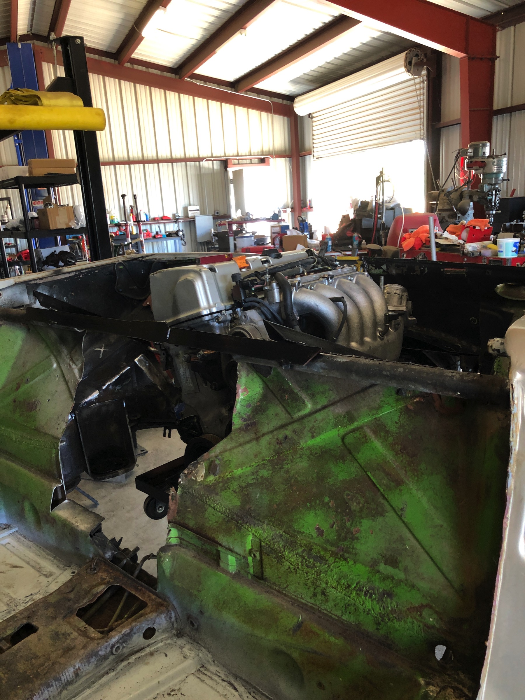

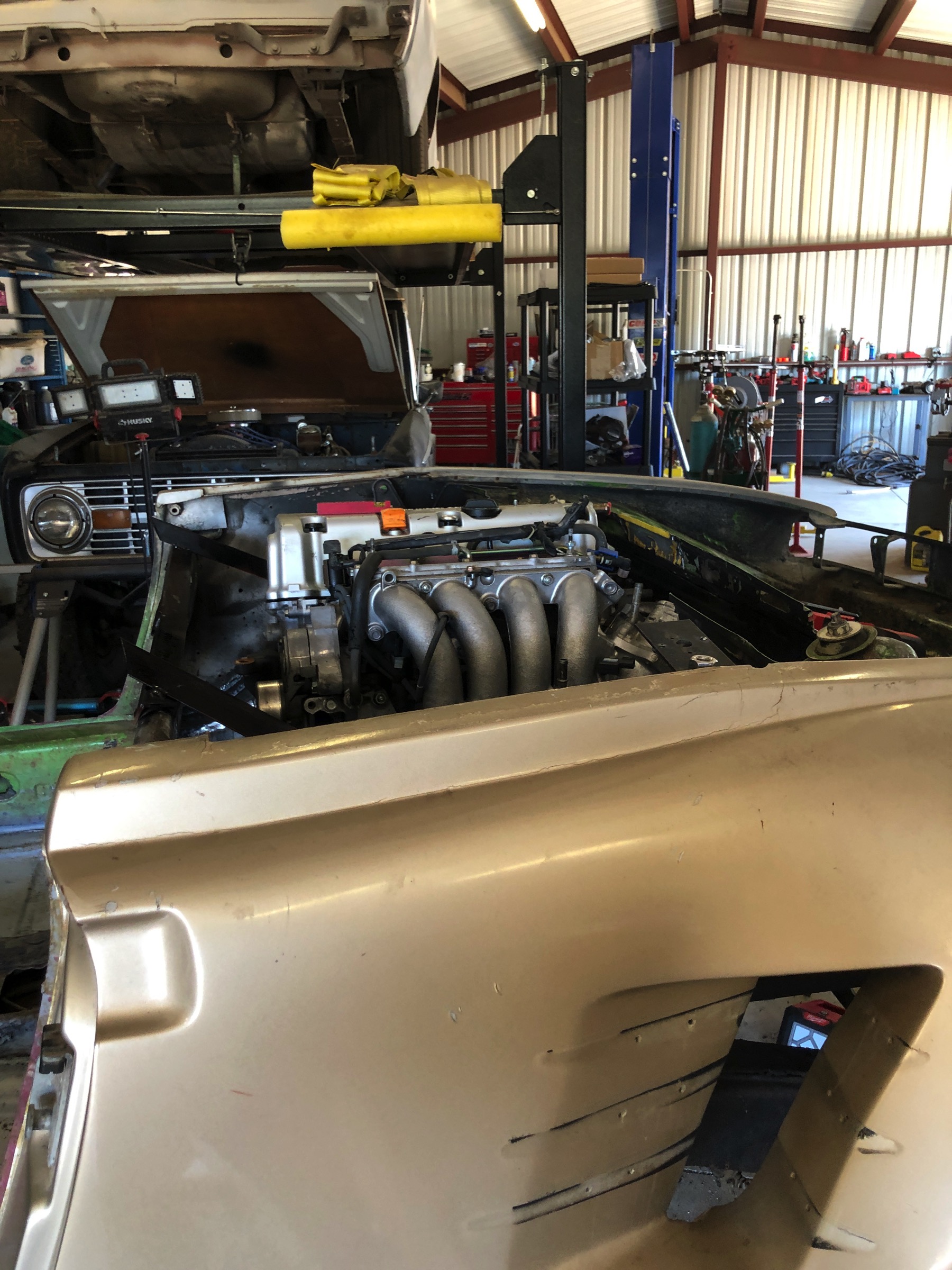

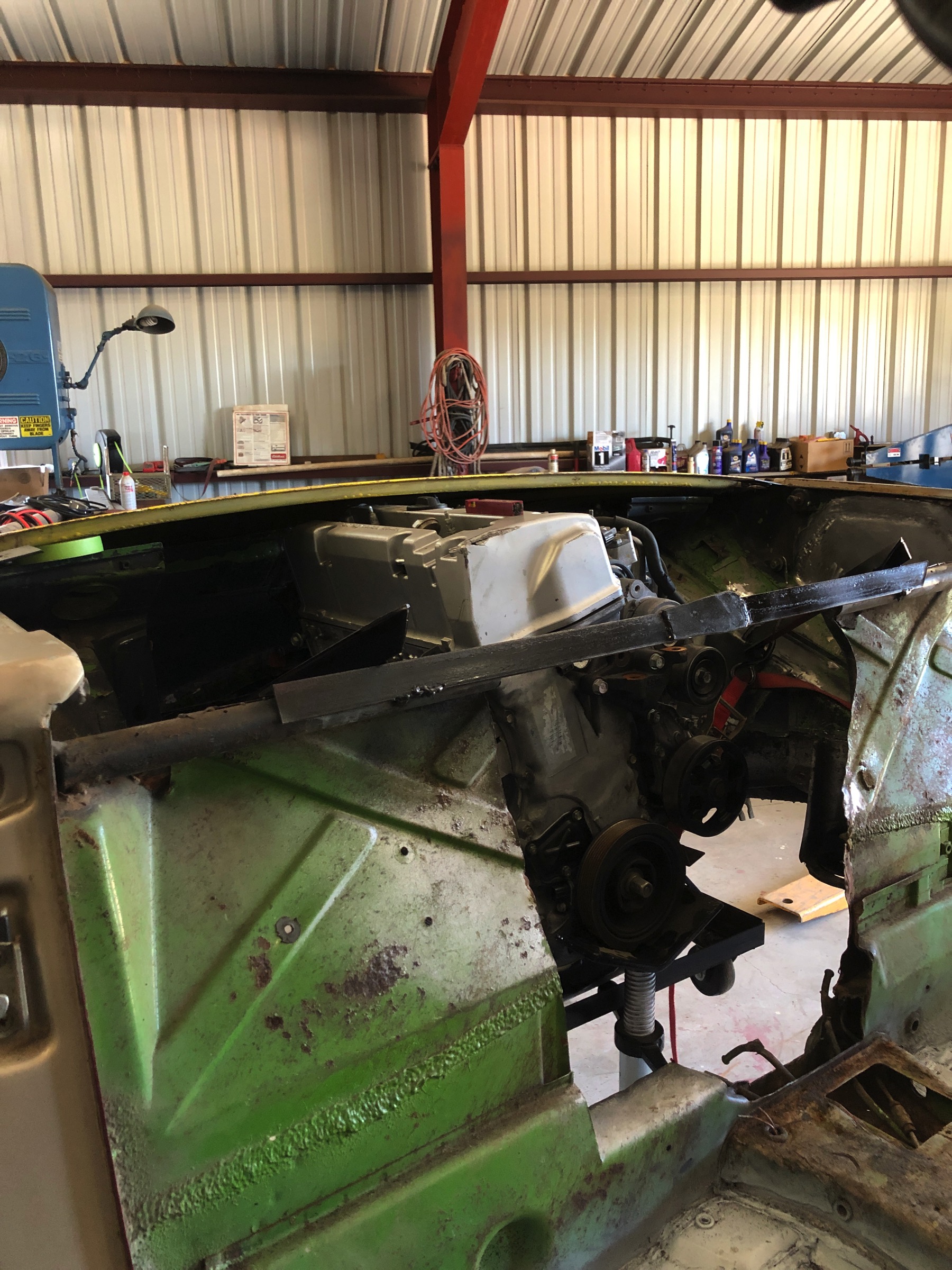

Had a chance to work on the car today and got the motor and trans mocked into place. Next Saturday Ill work on getting the mounts completed and yes it is a Honda K24, the trans is a boxer 6 speed.

OMG that poor firewall...
I hope part of the restoration will be replacing the firewall and regaining all the chassis strength someone hacked away.
The nose - i've seen worse. All I can guess is that they were trying to fit a radiator poorly and either did not know or did not care how to make a shroud to fit it properly.
How are the longitudinals under all the fiberglass? Are they sound?
Zach

QUOTE(GASHOLES GARAGE @ Jun 6 2022, 05:02 PM) *
@GASHOLES GARAGE
Why not use the real thing? New floor pans are cheap enough.

Yes the firewall is a high priority we just wanted to get the motor in first and make sure we did not have to modify something we just fixed.
The nose- that is the case and yes very poorly.
The longs surprisingly look good and I was wrong in an earlier post there is reinforcement on them. They are straight and true with no rust except a small spot at the hell hole that has been repaired.
Pat

True and that is a good option we thought about going this route but nothing on this car is factory.
Pat

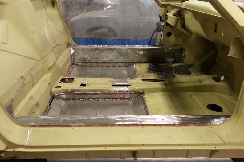

If the owner is tall, your best bet is to drop the floor maybe 1.5". @Cracker Tony is 6'5" and while his car isn't chopped/raked, with the dropped floor, he fits nicely in his car - with a helmet. And he's running a stock firewall.
If you google or search here for "914 dropped floor", you'll find pics of what gets done. I've attached one, just to get you thinking. I'd HIGHLY recommend you incorporate this approach, particularly since the floor is being corrected anyway.

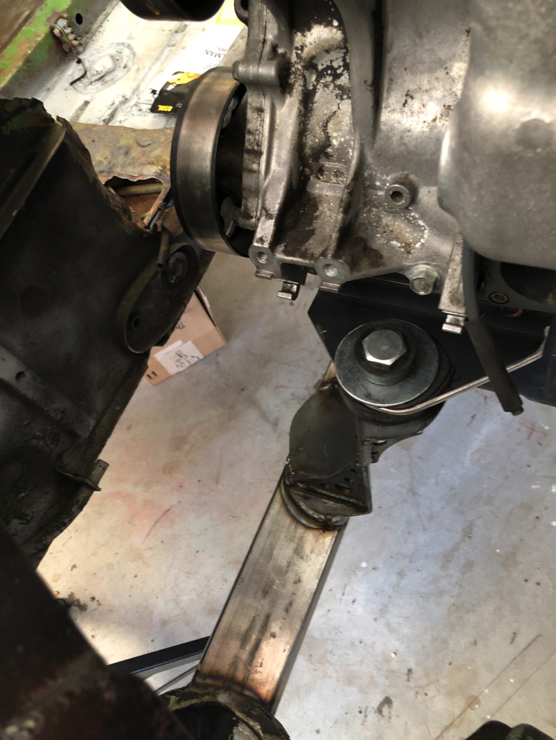

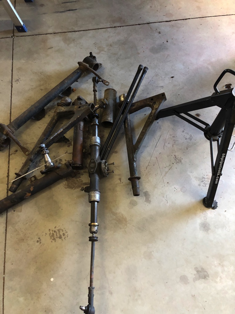

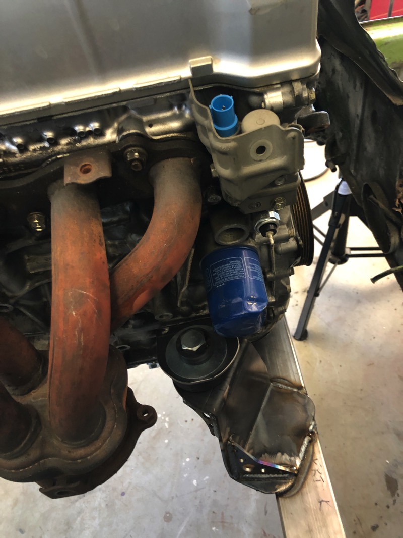

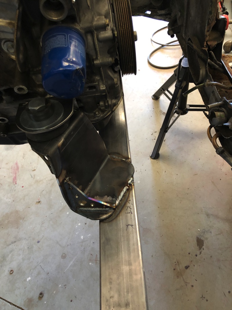

Got some time to work on the car this weekend and got the motor all mounted in its new home.
Also while working on the motor mounts Jeremy took apart the front end.
Once it was all apart we realized none of the parts that he bought matched with what was taken off. It was at that point we realized it had been converted to a 911/912 frontend. Good thing he has a parts car.

While I am not an expert on Honda engines, I do know that at least some of them spin backwards from "normal" engines. And I know you are using a Boxster transmission. Are you sure you are not going to end up with 6 reverse gears and one forward one?
Clay
Chris H.
post Jul 5 2022, 08:37 AM
Post #39
Posts: 4,079
Joined: 2-January 03
From: Chicago 'burbs
Member No.: 73
The K-Series spins clockwise luckily. Man that thing looks tall in the chassis.
GASHOLES GARAGE
post Jul 5 2022, 08:56 PM
Post #40
Posts: 27
Joined: 5-June 22
From: Southern California
Member No.: 26,601
I'm no expert on Honda motors either but I'm pretty sure it is not counter rotating. Though I have been wrong before according to my wife. That would make for an interesting first drive.
Pat
