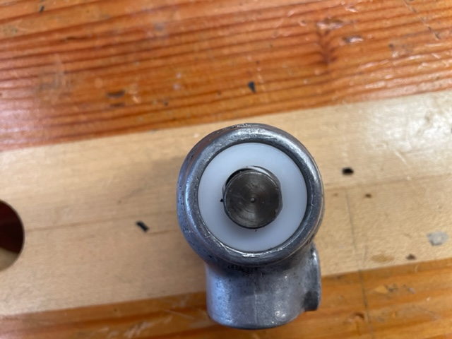

Hey Teeners, Just finished the shifter bushing in my SC and had great results. Figured I should do the BB as well to get some of the slop out. I started at the coupler and firewall, found the bushing had blown out and the coupler wasn't too bad. But since I had new bushings in hand I easily pulled the coupler apart and then found that the new bushings were not correct. The ID is way too large. Bought them from the local Porsche dealer in a weak moment of impatience. Parts bag shows 964-424-223-01. Ran the number on Pelican and their site says they are correct.
Please take a look at the photo and you'll see the problem.
Obviously I can;t cal anyone today but I'm wondering if anyone has seen this before?
The SC calls for a very similar bushing but it is a different part number, ending in 02.
My pin measures 12mm and the bushing ID is a bit over 13mm.
Thanks for reading this and any suggestions.
RobAttached Image

There are two (now maybe three ?) versions of that bushing.
The earliest one is familiar to us for '73 and later cars with the side shift linkage.
It has a round, tight fitting hole for the cross pin.
The next one looks very similar but has an oval shaped hole for the cross pin.
The part number you show, 964 ... ... .. I think is for that part. It was intended to
reduce cabin noise in later 911s
The one you pictured is a new part with a larger center hole ?.....or is that your worn
old part ?

That is the new bushing in the photo. From my experience with my SC coupler, the pin is a nice tight interference fit. These new bushings fit like 40 year old worn bushings.

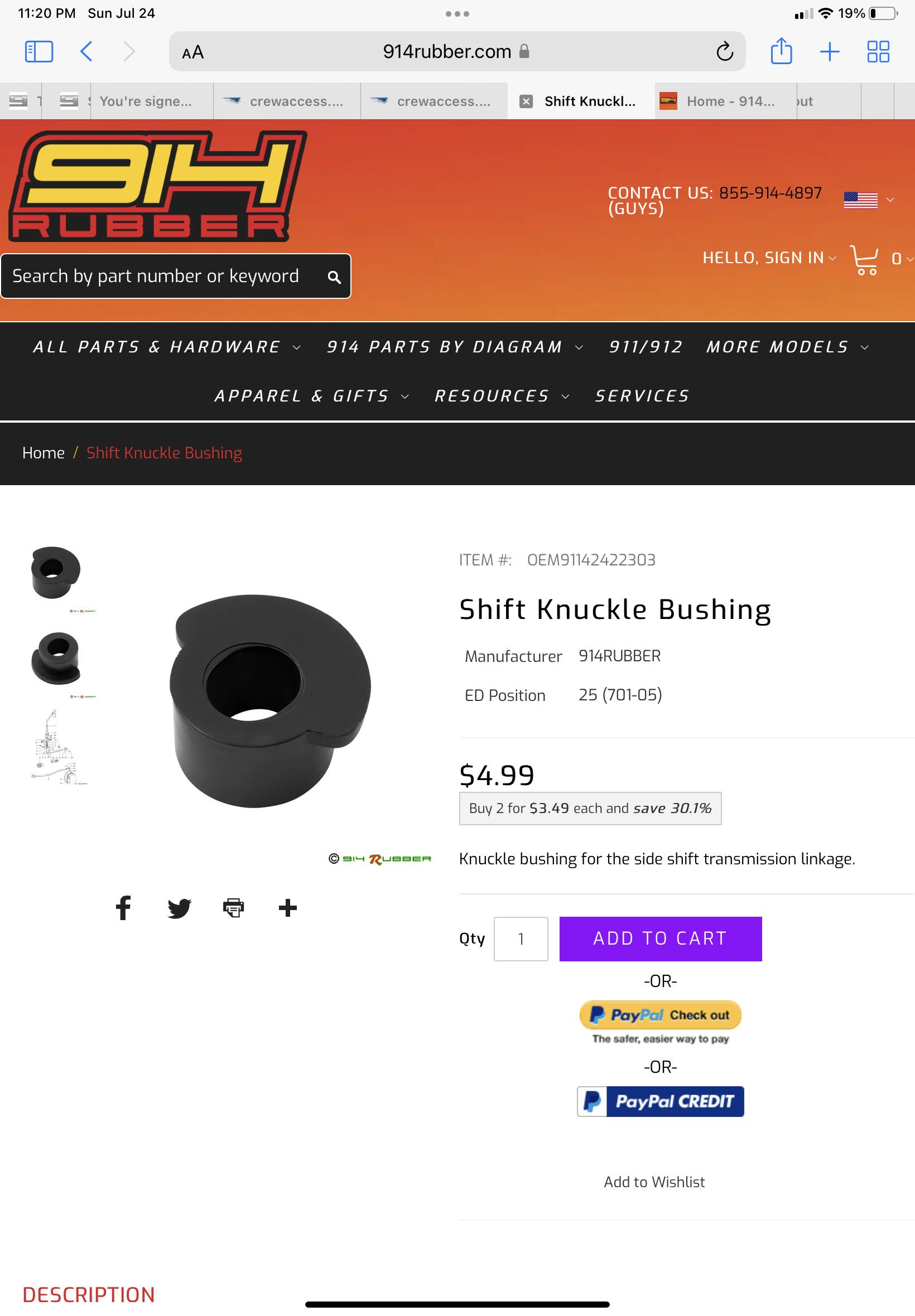

We have made a bushing that actually requires the slight elliptical hole to install and not put stress cracks on the aluminum housing. There has to be some give to allow it to flex slightly.
https://914rubber.com/shift-knuckle-bushing-1
The factory made these plastic for a reason.
But yes the gap you have is too large.
Drop me avPM I’ll drop you a set out.I think you will see the difference.

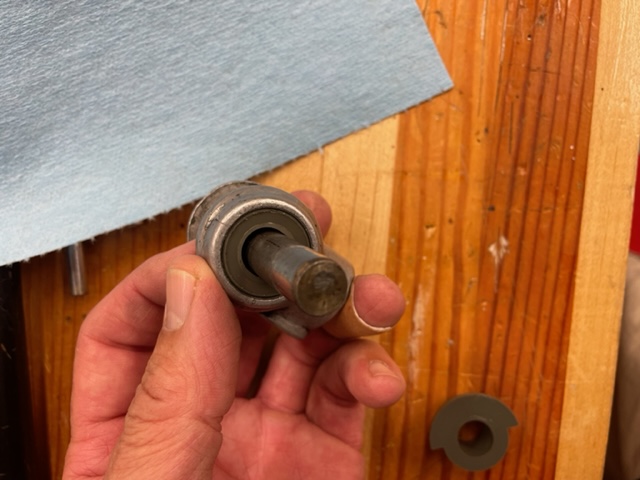

Hey Teeners, After waiting a week for parts and a chance to get to the shop I was excited to have proper bushings to get the coupler back together. NOT. The new bushings not only just about fell into the coupler but the pin holes are not round and much larger than the pin. In the new photo you can see the flats on the pin hole and daylight on the other side.
Bronze bushings next? Chris's coupler?
I may resort to putting the old bushings back in as they were better than the two sets I just bought.
These bushings were URO branded too.
AAAAARRRGGGGHHHHHH!Attached Image
Rob
