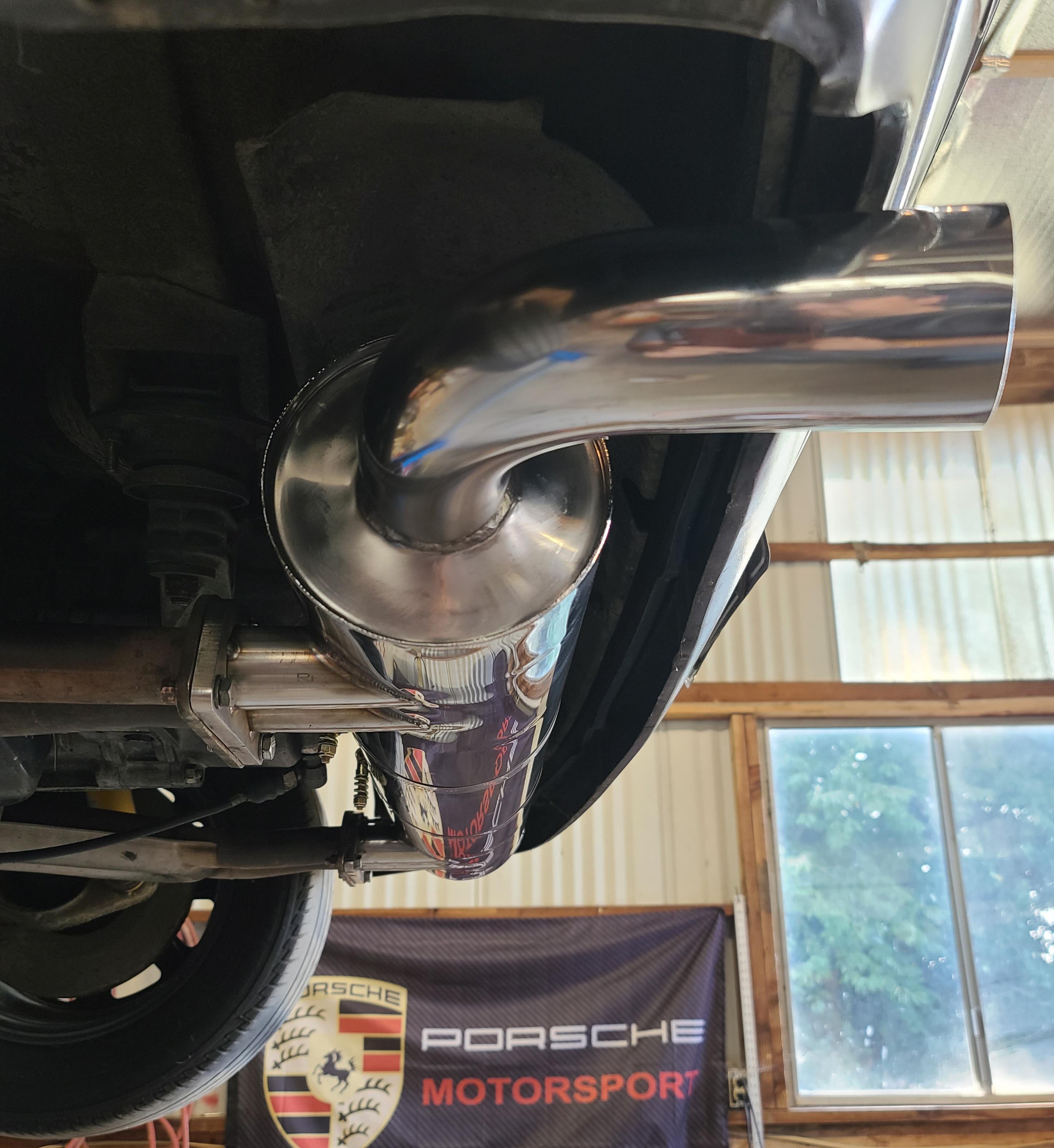

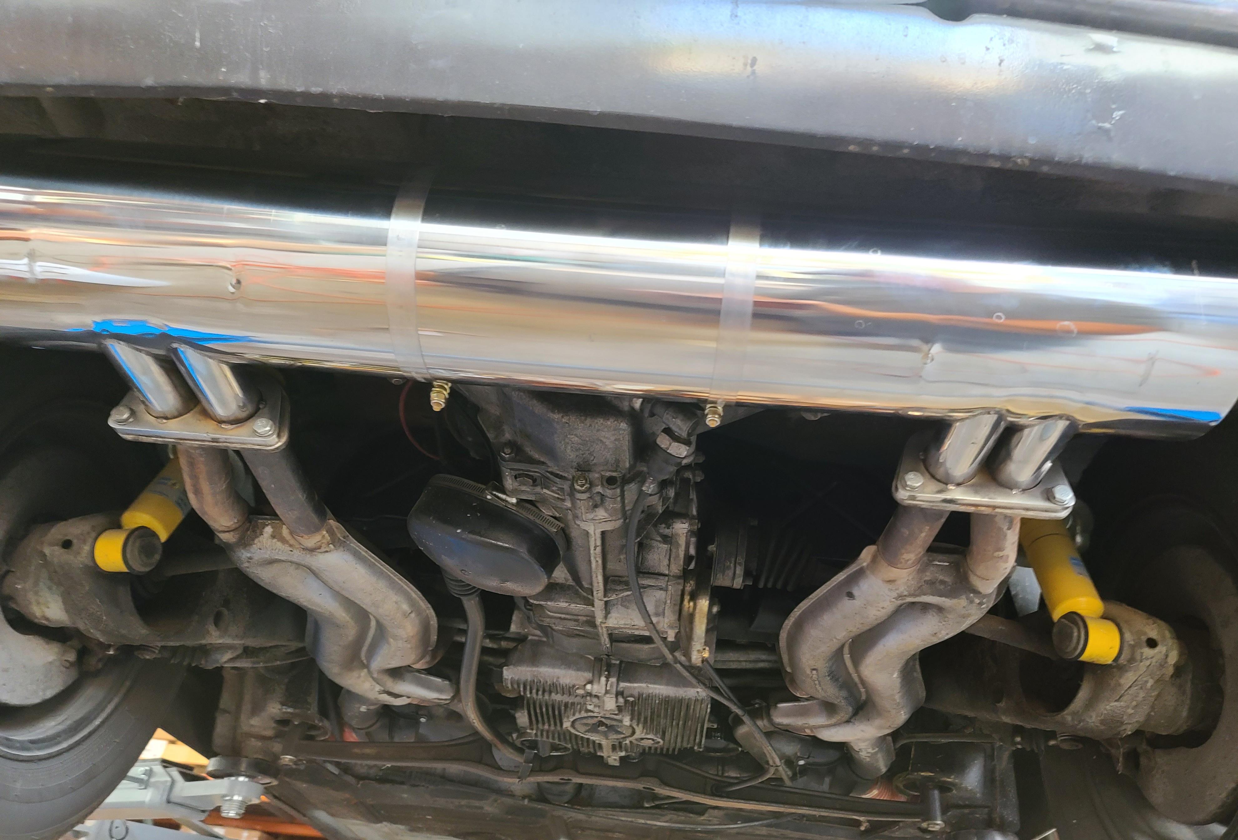

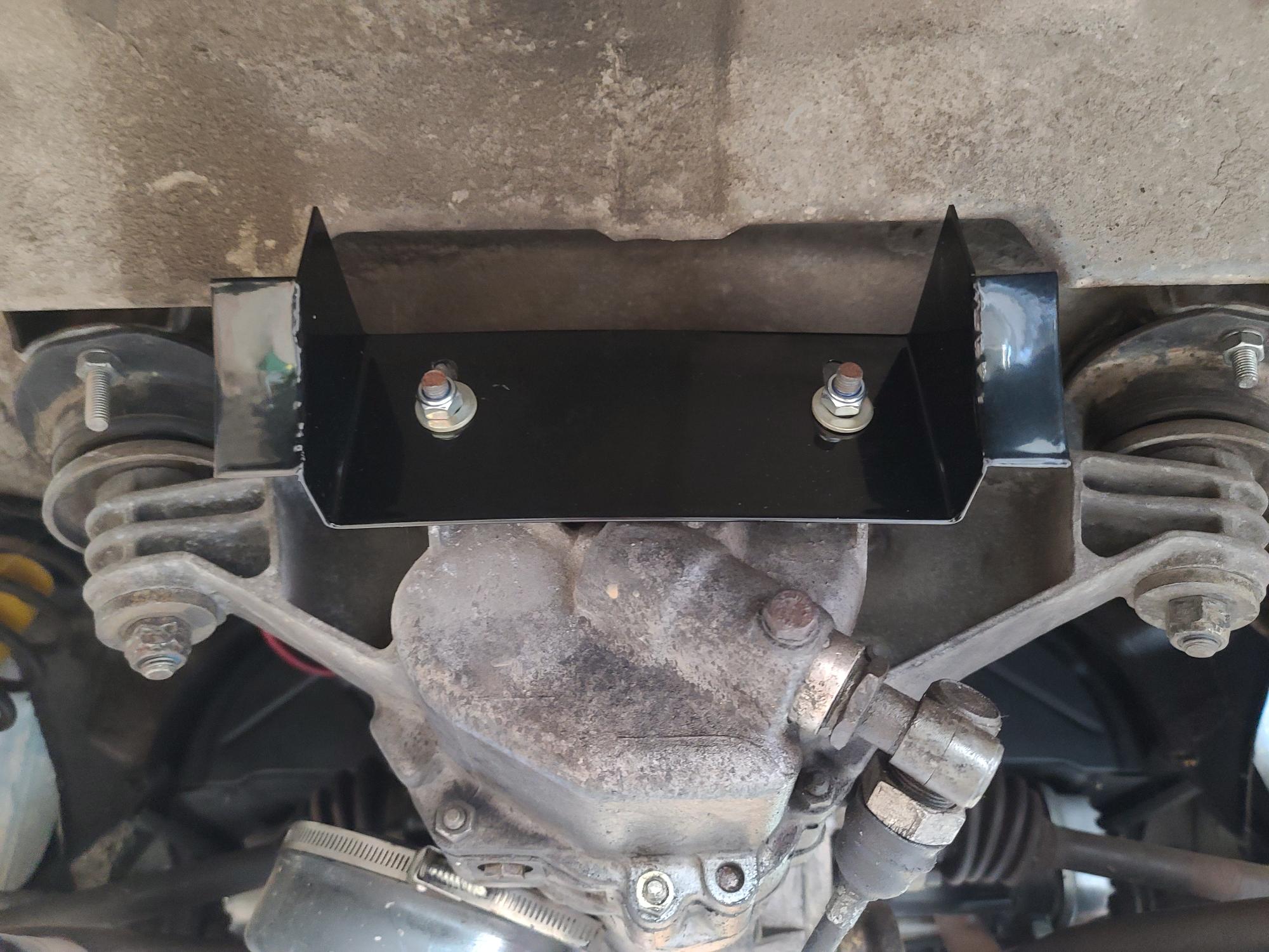

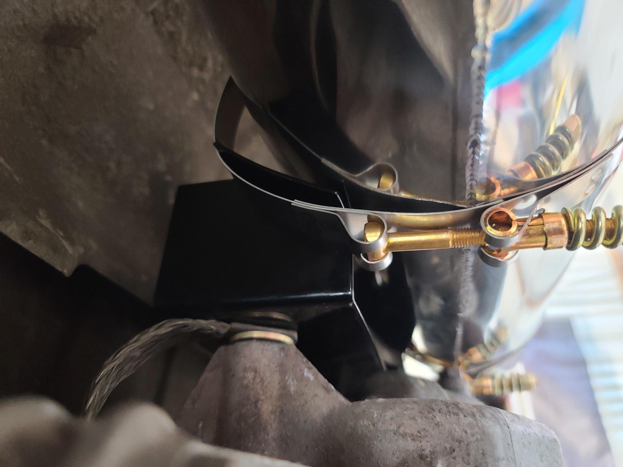

Working on a mount for the mufflers. Liking it so far but need to make some further adjustments.

looking good Mark...Are those transmission bolts in upside down?

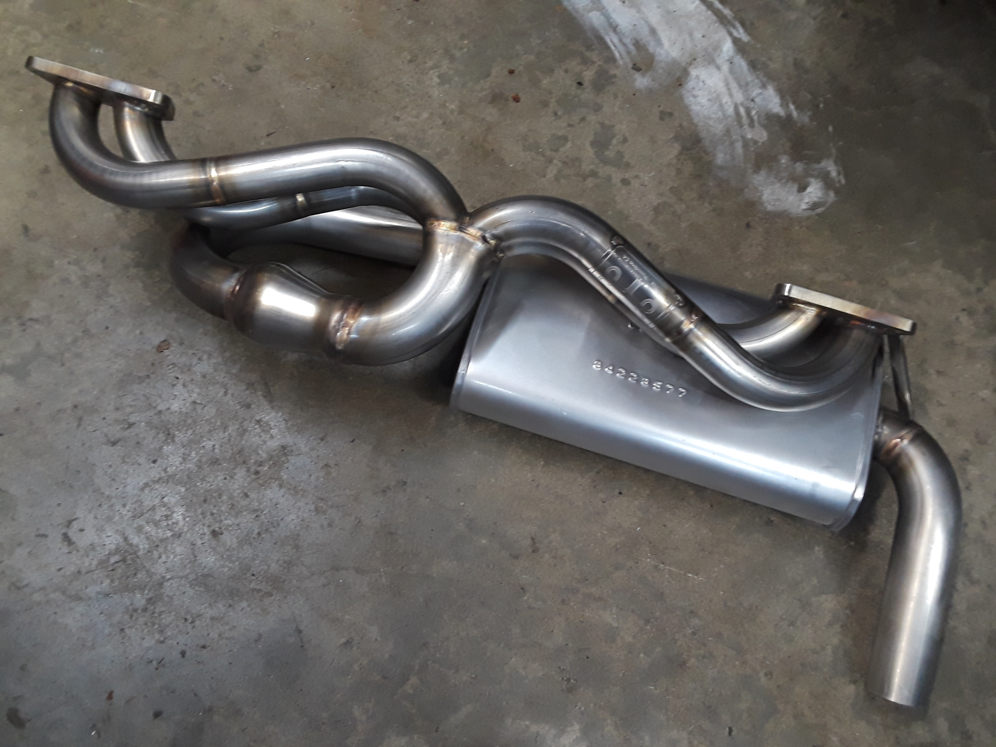

Heres one ...new Bursch

They finally figured out how to keep them from rusting the moment you fire up the car!

The muffler was the first place the rust started on mine; and that’s the same muffler previously used,. I have one and the number is the same

They make a stainless version.

That is the stainless version. That is all they sell now. That Im aware there is no option for a mild steel version.
& Jim you are correct still a aluminized steel muffler section, which would be fine ... if the assembly was delivered flanged so the avg. guy w/o welder could buy a different unit & update it

You need to consider differential thermal expansion as the H/E's expand lots more than the engine & tranny cases when at operating temperatures.
Thats why the OEM brackets are somewhat free to swing fore & aft.
Don't clamp muffler directly to tranny case.

As for the mounting flange, I bent up some metal quickly and as you can see it fit's poorly. I need to improve the design to allow for flex and correct angles.

Our cost for the stainless is good enough that if you look at the savings for going to steel, it isn't a great value. The stainless is really the superior product. The bigest cost in labor.
