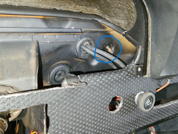

putting the dash gauges and switches back in the pumpkin (1970/4). Whilst looking around I see this (pic) and am wondering what the heck went here. Looks like something was bolted there but....... I got not a clue. Anyone know.

Is that the 6x1.0 stud that holds the heater control in the dash?

No this is to the left of that.

Is it a ground stud?

Don't think so. Should be three grounds. one up by fuse box, one on trani, and one on engine block.

That looks like the end of the rubber support for the windshield wiper assembly.
It just needs a washer and a nut on it. The rest of it is under the cowl. It is the same as the fuel pump rubber mount.
FYI.. on most cars this is broken from age.

That would be it! Thanks so much!
