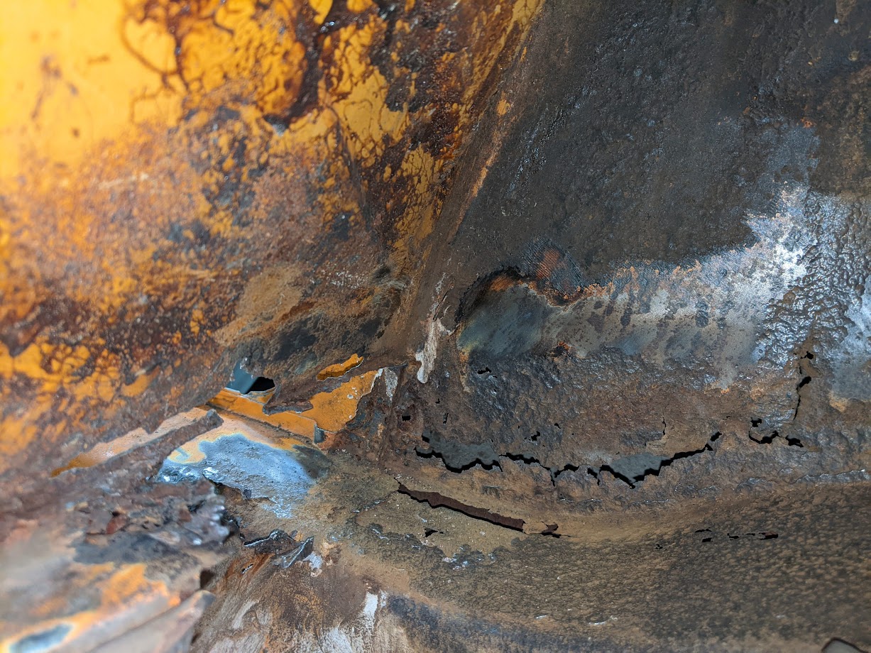

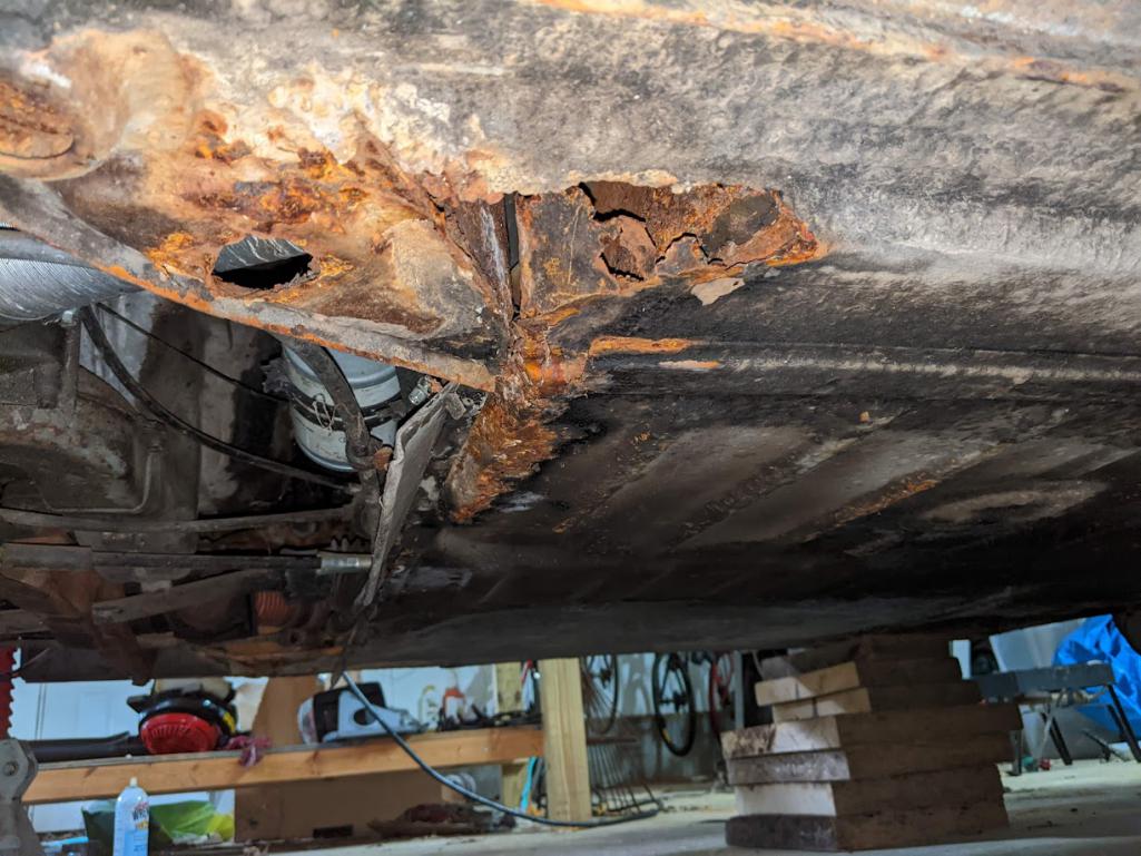

Wow guys, thanks for all the attention and references. A common theme looks to be to strip the car, put it on a frame and remove a lot of body panels. A few of the cars didn't look as bad as mine. So, I'm starting to come out of denial. I'm a bit nervous about exterior body work, but maybe if I work for the inside out, I'll have some skills by then.
I tend to be a finisher of projects. My steam hours say I have time to divert from video games. I don't do the mindless ones either. But I'm also frugal. I've been telling myself that video games are cheaper than project cars. But I couldn't resist the low cost of entry into this. I hope that the car will be worth more than the sum of the parts (and tools?). I do want to retire soon...

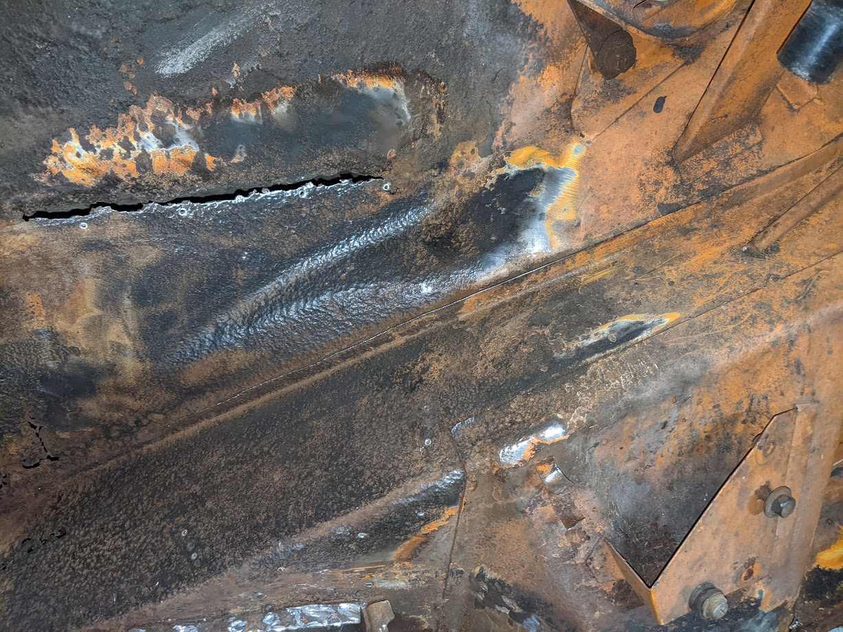

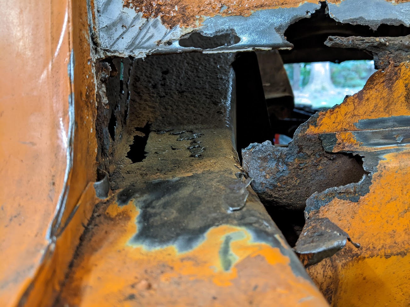

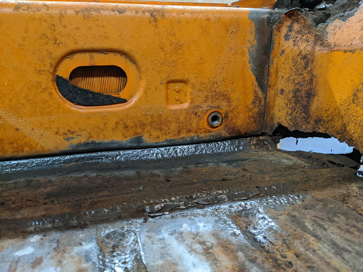

Ok so enough introductions. Here's some photos after playing with the new grinder and attachments:
So do we say all this pitted stuff is bad stuff? Looks like it has been coated in rust converter a while back.
I guess the floor just has to come totally out.
I've seen pictures where there is an inside piece towards outside but there looks to be a piece inside towards the inside.

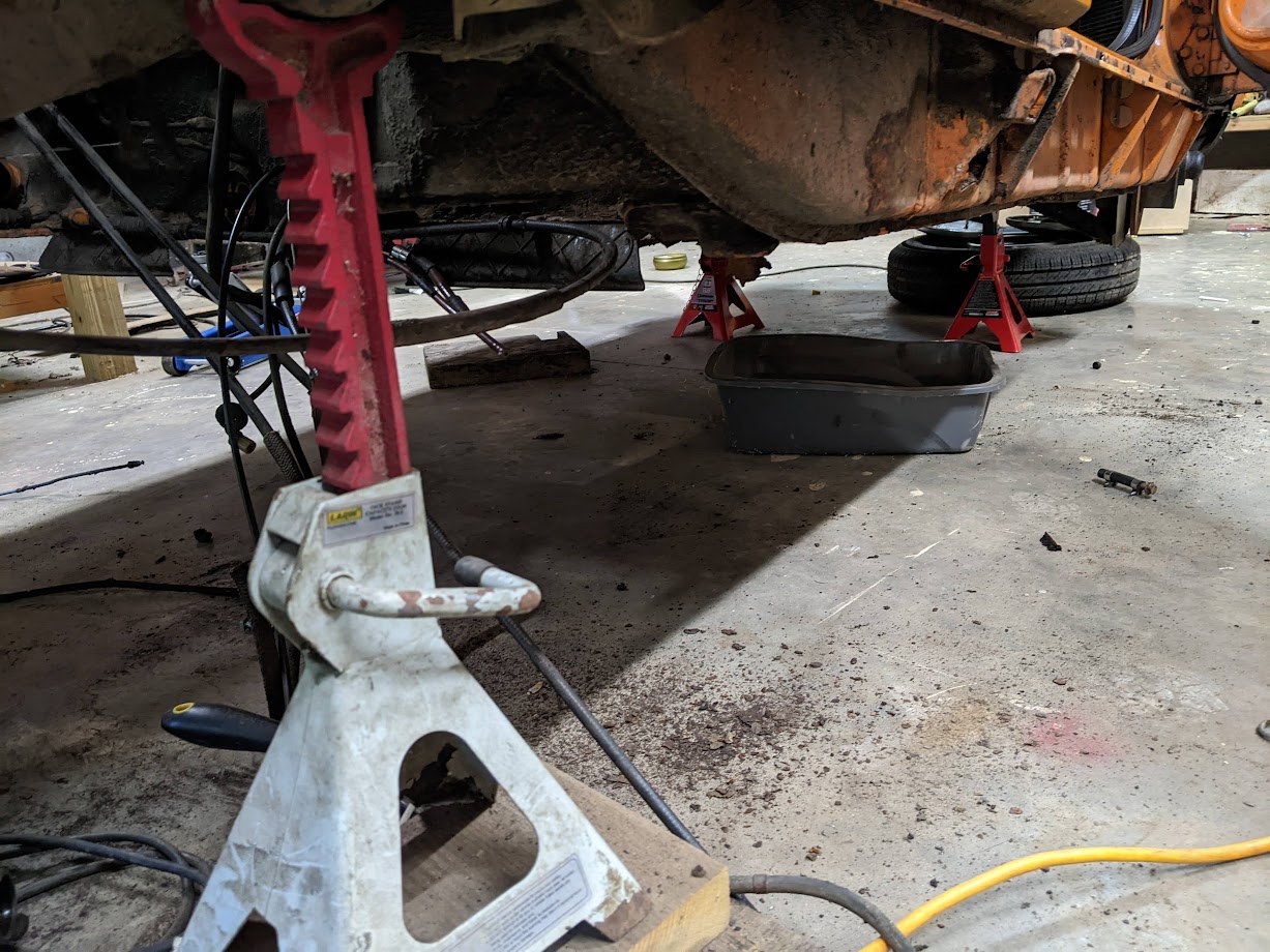

I guess I need a better support strategy before cutting? I saw someone argue against a rotisserie when the car needs structural repair. So has someone made the octagon rotisserie with structural support?

I believe the octagonal rotisserie is both a support frame and rotisserie, so if you have room in your shop to use one, go for it. Can't remember details of the design off the top of my head, but you should be able to easily add additional support points if needed.
The longs are key for your success. You don't want to do much panel replacement until those are solid and straight. You could probably get away with your lower firewall repair to hone your skills before diving in on the longs. I had front and rear trunk floors to repair so used those for polishing skills before hitting the longs. Just remember it is a uni-body chassis so almost all panels are structural and work together to create a strong and rigid body, but the longs are the closest component to a "frame" in the structure and receive a lot of the stresses transferred from other panels. If those aren't right when you replace floors, etc., then you are just baking problems into the structure.
The pitted metal is a little complicated and has to be evaluated on case by case. You aren't going to be able to weld into it, so if it is in a place where patches need to be done, it has to go. It will just vaporize when you try to weld. You need to get it to shiny clean metal - at least for MIG. It can still be pretty structurally sound so in some places, it might be okay to leave if you can live with it cosmetically. Most of what you are showing either has layers rotted through/flaking off, or will need to be cut out to weld in repair panels. The pitted floor along the inner long for example will likely be replaced when repairing the floor. It is much easier (and cheaper) to plug weld in a new floor piece along those flanges than butt weld in patches. Replacing a full or half floor with the RD pieces is the most satisfying part of a project like this. Don't deny yourself that joy. Seriously. That is the point you look at your project and are VERY happy.
Lastly, don't get too carried away with cutting yet. You just want to strip/cut back enough to get a good inventory of what needs replaced, and make a game plan for repairs. From there, I recommend removing and replacing pieces one at a time to keep as much structural integrity in the car as you work. If you have a nice frame bed, that's a different story.
