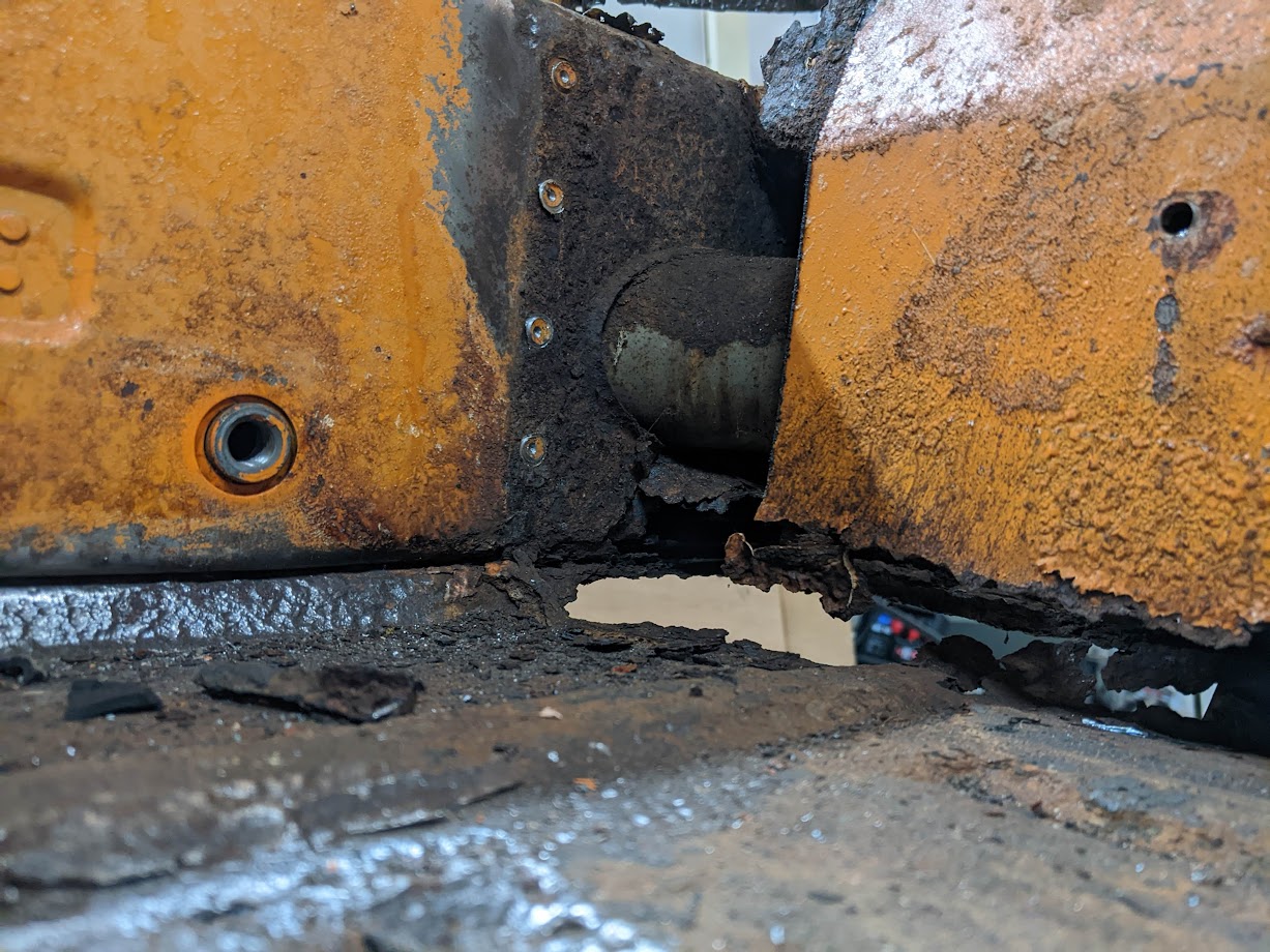

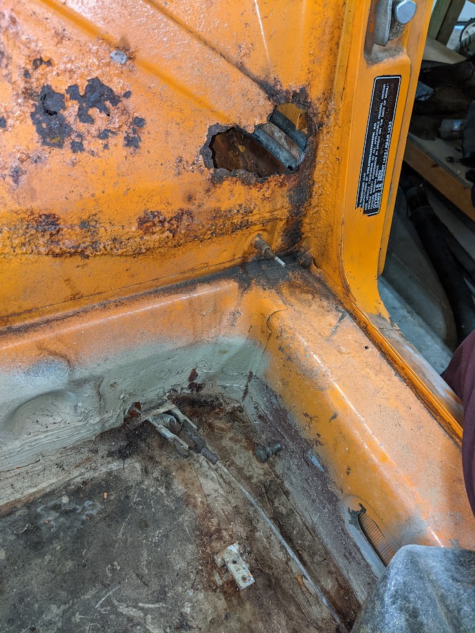

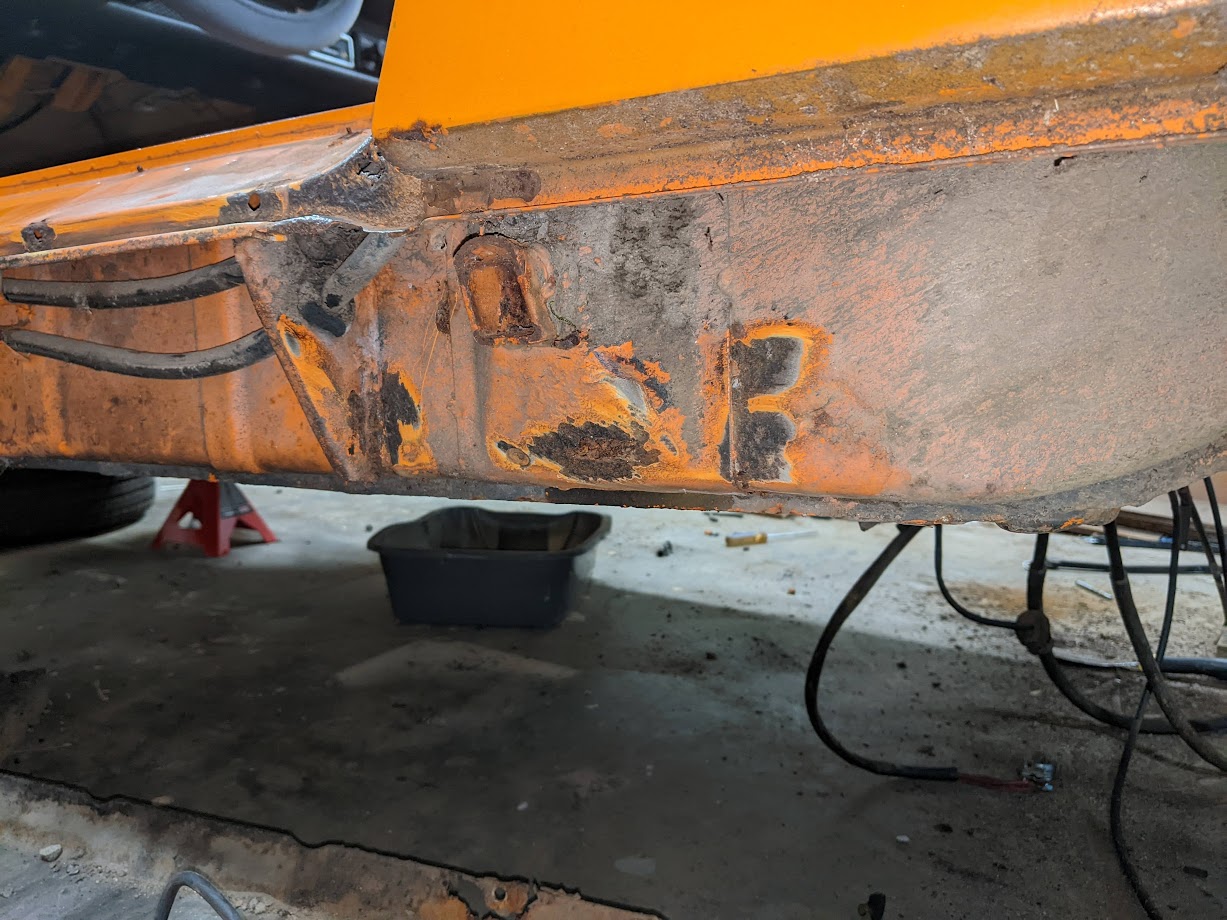

So I now pulled of the sill on the driver side. Some rust around the jack point.
Could wonder what's under all this bondo. but the top side of the long looks good all the way back.
There was a puddle here but I don't see problem on the long there.

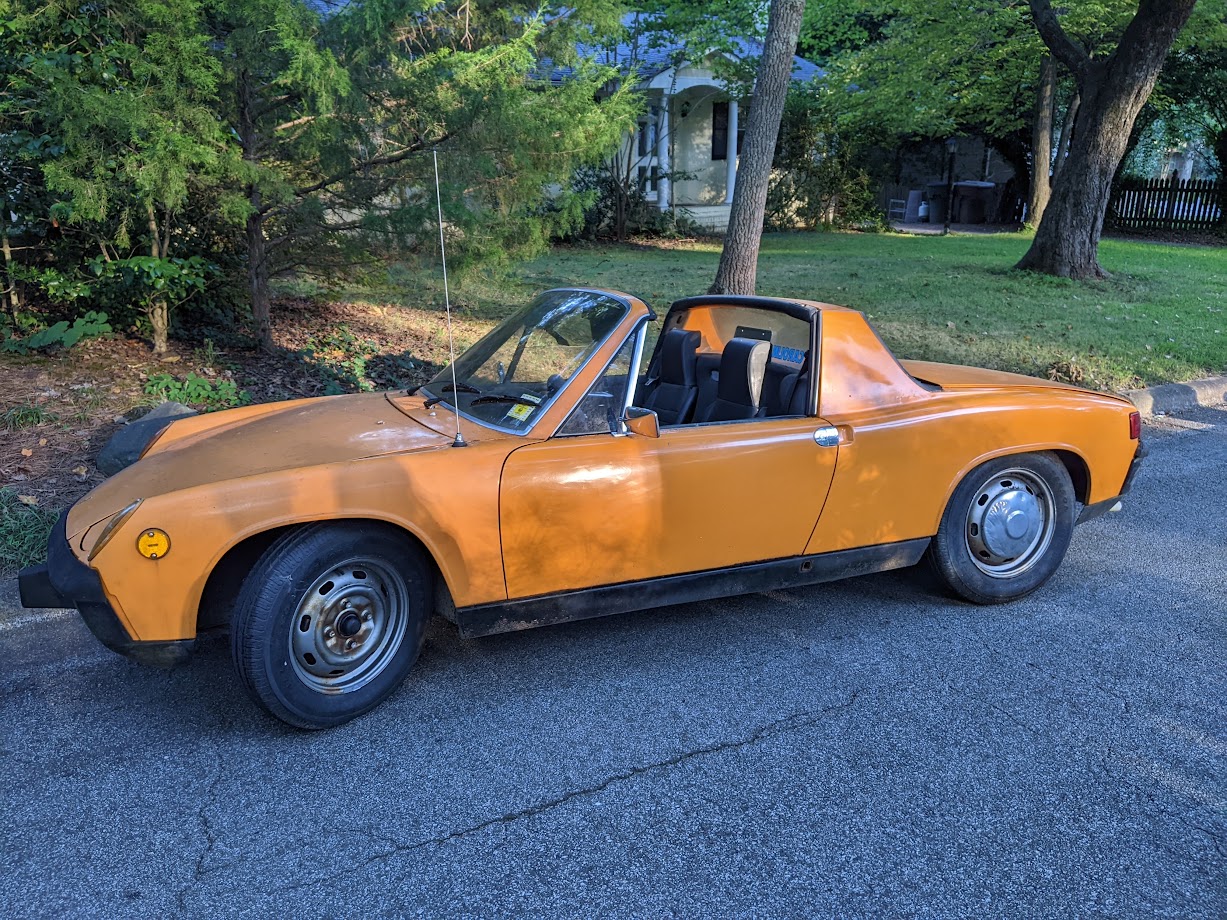

And by the way, here is the outside. I should have introduced this in the beginning. There was some patchwork at the sail near the door where I can see rust under the fender. Rear trunk floor will need some attention.

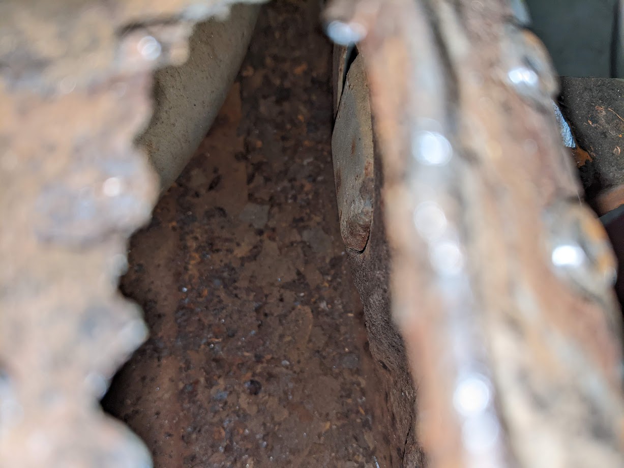

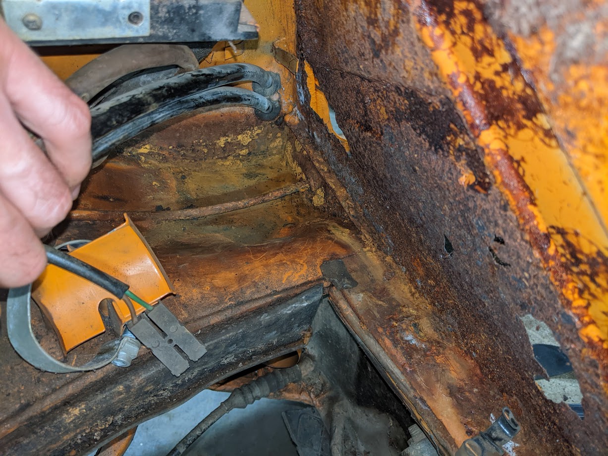

Poking at this slowly. I cut away more so I could see.
The jack post is missing a layer around the bottom.
It's bad all around the heater tube.

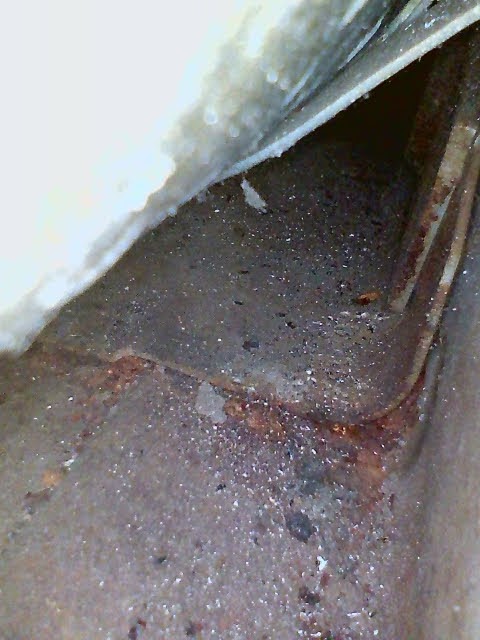

I also got a snake camera to look around. Not sure it helps much. But looks like the jack point has some metal.
The seatbelt mount and forward look ok. Though maybe it's not special to say it's only bad toward the bottom on the back end.
Is there something to do short of using a whole new inner wheelhouse and engine compartment longitudinal member and replacing the suspension and engine mounts? ...even though there looks to be a lot of good metal around the hole?
I don't think I could feasibly fab the metal around the heater tube. Most of the rustoration threads show a reinforcement layer on the inner long there, but I don't see that the restoration design part comes with one. Is that right?
