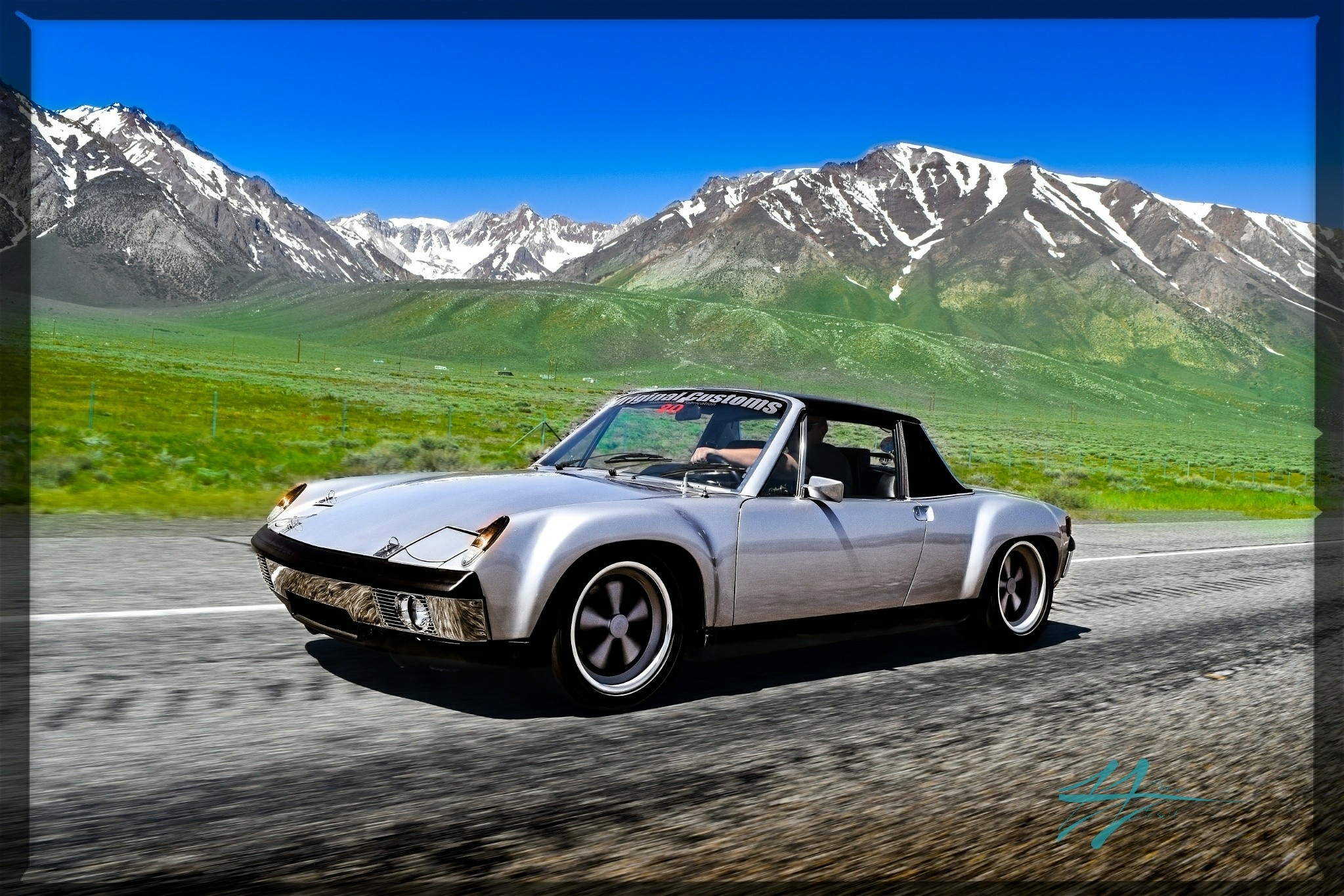

Mine has been both a 4 and a 6 with the Rennshift And shift rod And McMark mod.

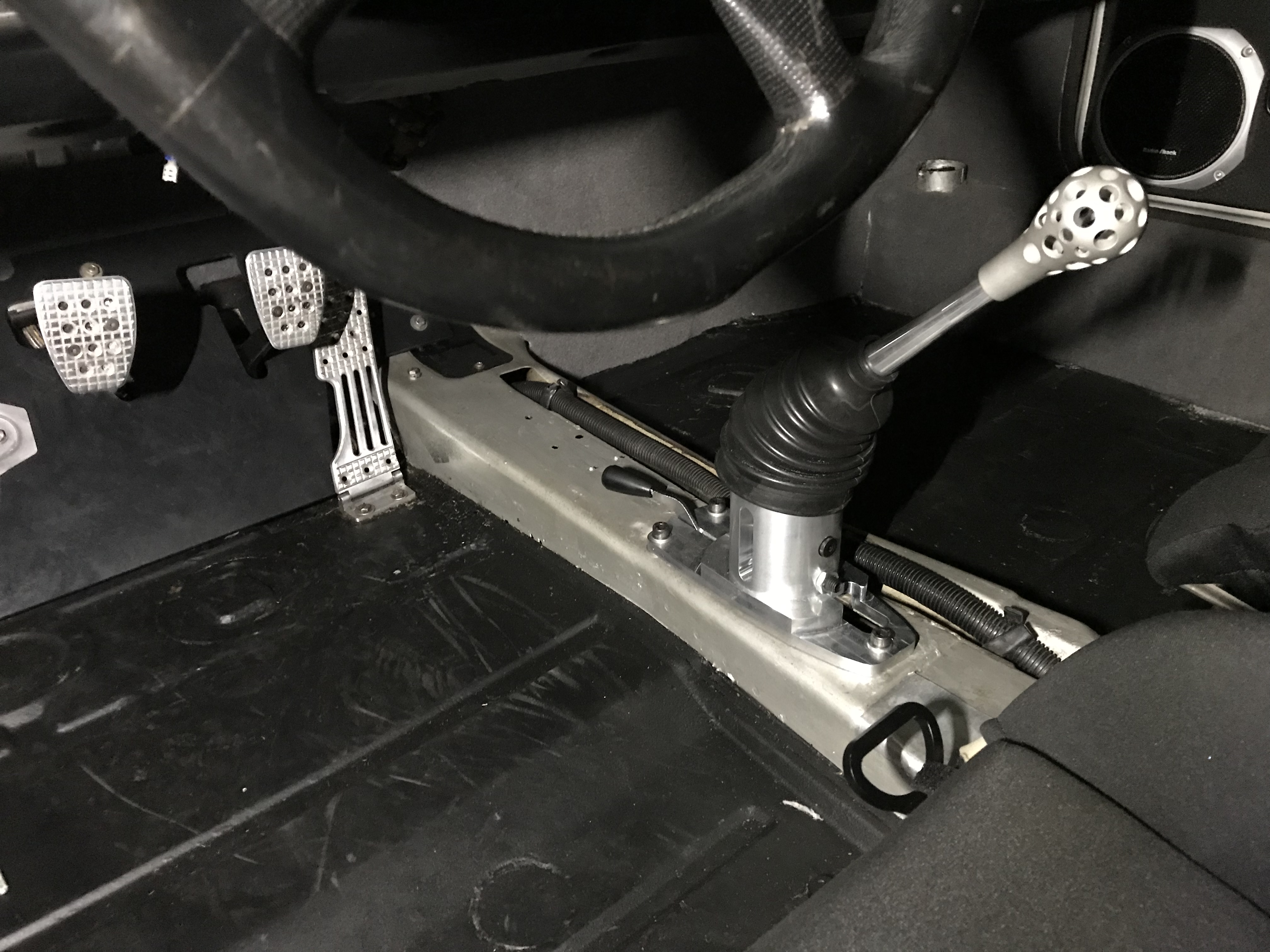

I installed a Rennshift earlier this year. It was an improvement, but wasn’t as dramatic as I hoped. But I’ve felt others and they were superb. Perhaps I need some more adjustment?
Regarding the slot for a hand throttle? It wasn’t hard at all to cut one into the baseplate and install the hand throttle per usual. Mine works great. I also used the Wevo knob, but I elected for the one that slips on with a crush sleeve.

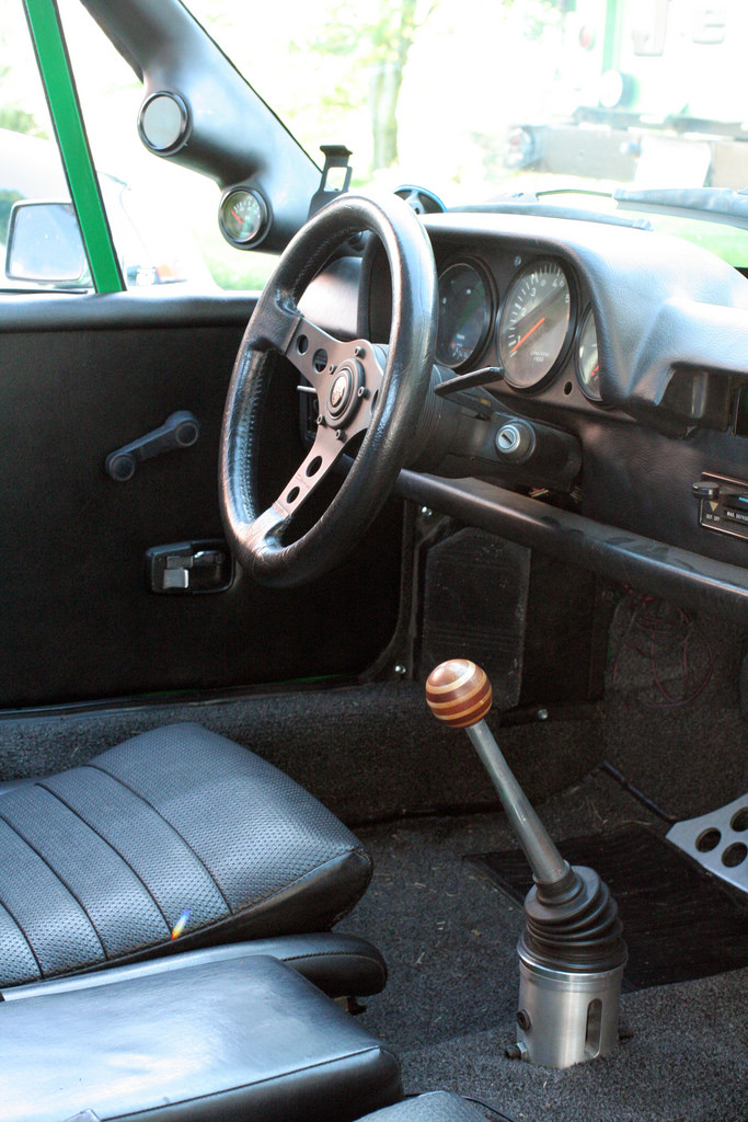

(IMG:http://www.914world.com/bbs2/uploads_offsite/c1.staticflickr.com-1435-1514858545.1.jpg)
Yeah, worth every penny.

QUOTE(ConeDodger @ Dec 31 2017, 04:40 PM) *
Is that a real picture or some photoshop creation? It looks AWESOME!!! (IMG:style_emoticons/default/smilie_pokal.gif)

QUOTE(plays with cars @ Jan 1 2018, 01:45 PM) *
Beautiful setup. What pedal are those?

Looks like Rennline.
