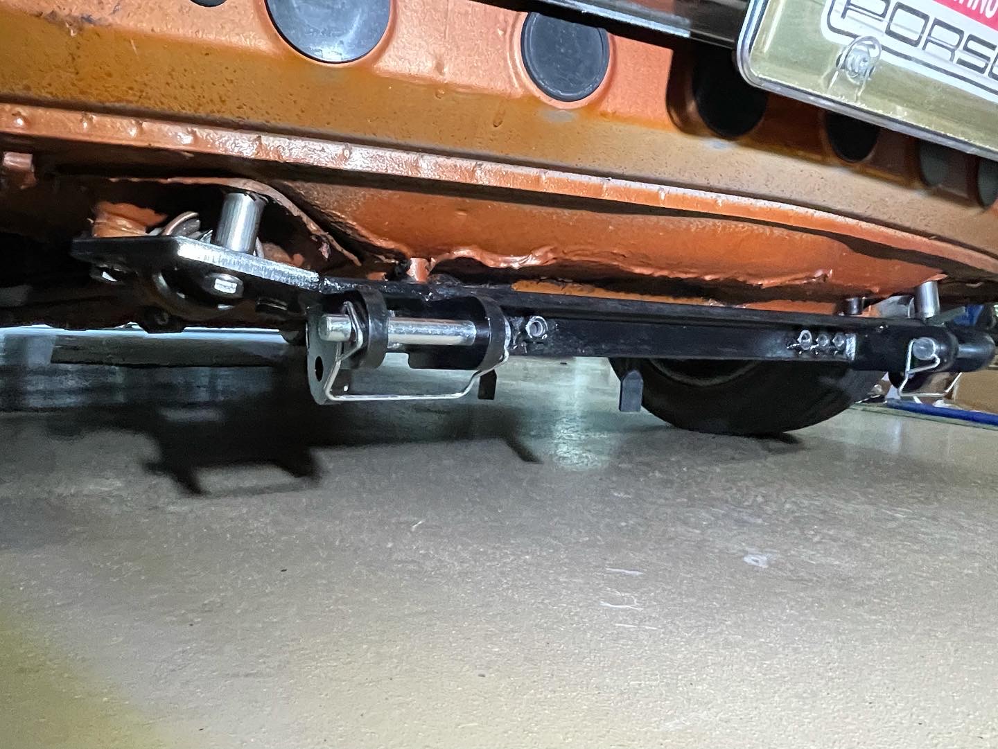

(IMG:style_emoticons/default/smile.gif) HERE is the bracket
You also need the tow bar itself. Any of the 5K lb adjustable "V" bars will work. I usually recommend getting a coupon & picking up
one of the HF ones if you have a store local. Or if you are kinda remote, Amazon has a host of offerings, just shop for one with free shipping.
A 2" ball on your hitch, a set of magnetic tow lights (also a item HF carries) & you are set up.

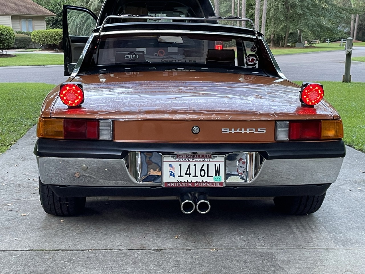

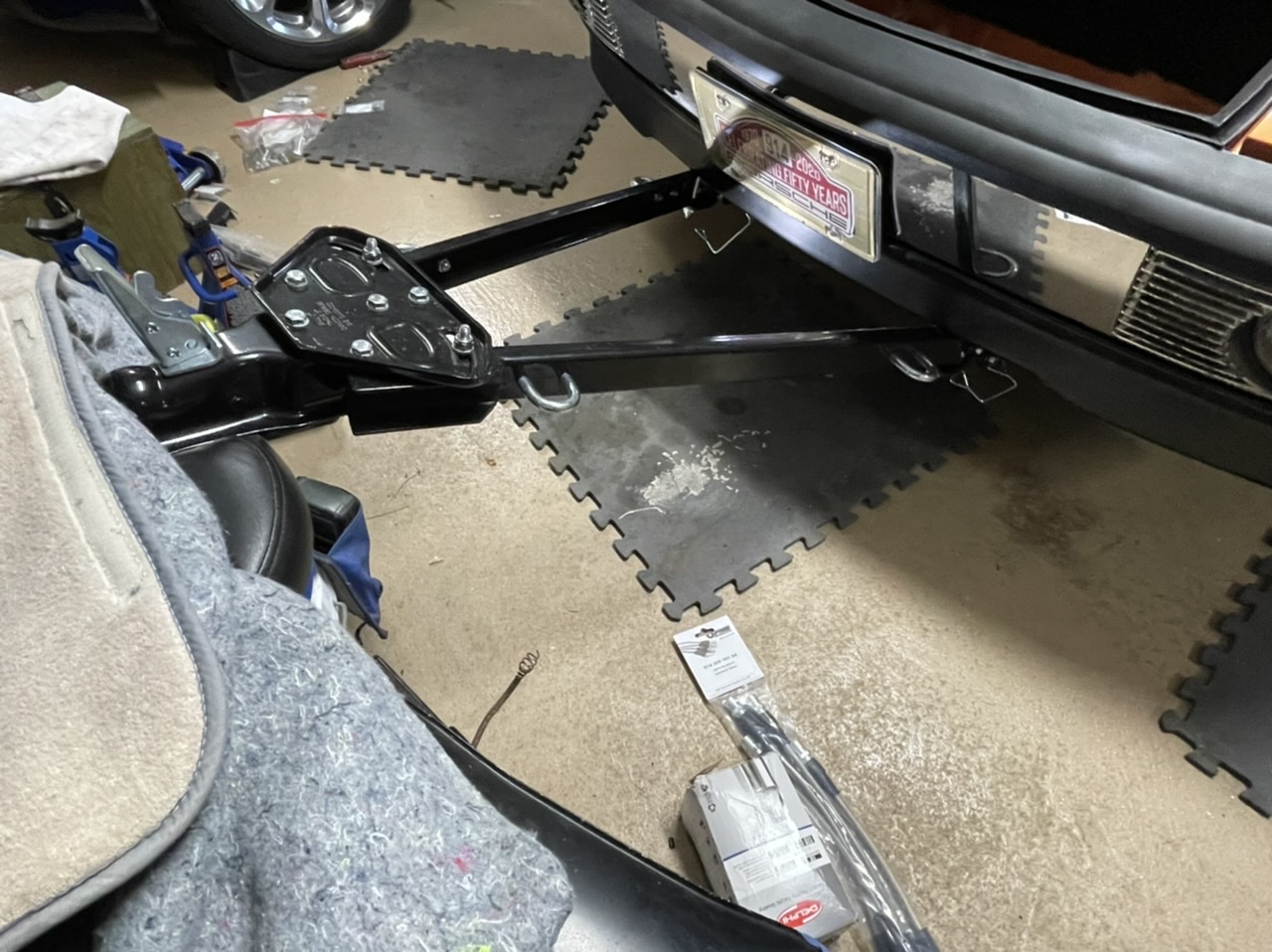

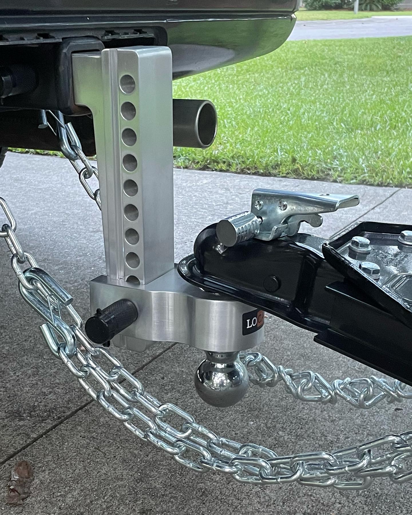

Get Rich's tow bar, remove front valance and mount that bar, get a helper its easier with 2 people. - get HF tow hitch set up with safety chains or cables, also get an adjustable drop hitch with 2"ball, i got mine on amazon , it was kind of $$ but nice and will slide up and down so you can get the tow bar level or very close to level, with my Navigator as th the tow vehicle i had to use the lowest setting about a 10"drop.
Also Amazon, got the wirelsess blue tooth tow lights, magnetic, i put some felt nder the magnets on the back deck lid and they didnt move or scratch, no wires to run, ,
I think thats about it. I posted some pictures on the octeenerfest thread and on my thread, or maybe it was the "what did you do to your 914 today" thread.
Towed this 6 hours and didnt even feel it back there. way better than a u-haul trailer whic is heavy my gas mileage was about 5mpg better flat tow than with trailer.

here’s are a few pictures of the bar, hitch and set up .
get an LE valance and mount it you don’t have to remove it, but the stock valance has to be removed .

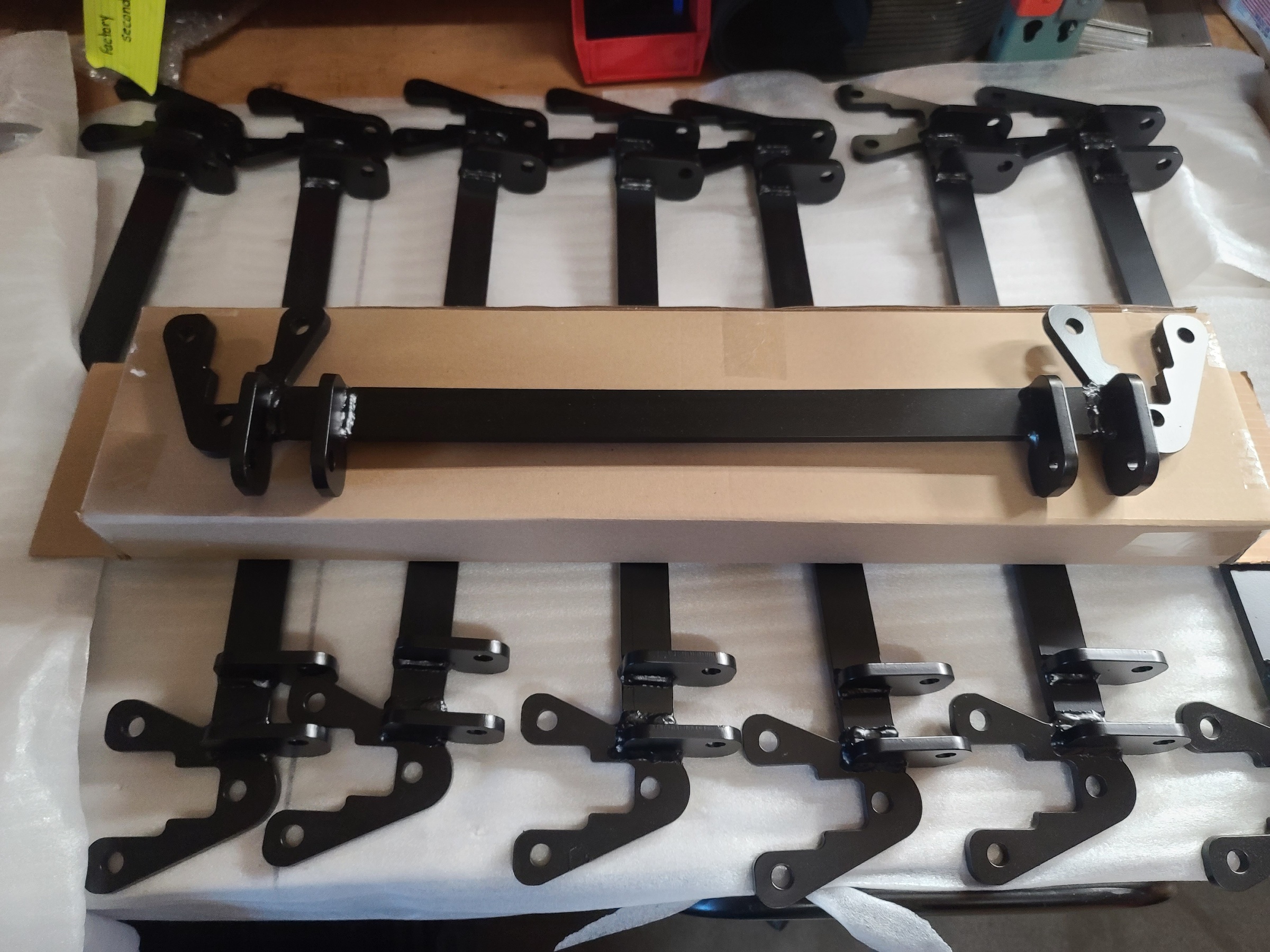

Well I guess its time to announce the new variation we are making. Just back from powder coat. We are offering an option to get our towbars with the modification that allows for using the Harbor freight bars. Saving some money for those that don't have the Empi bar.
Same price as the Empi version aa the only real modification needed was opening up the space between the 2 brackets. Still just $125.
Will be up on the site shortly.

Figured it was a simple tweak, so why not create a variant. I do like the EMPI set up best, but it's sometimes harder to find.

A few things I’ve learned flat towing a 914 to the track and back for a few seasons:
- don’t back up - front wheels jackknife quickly
- HF mag lights do not stick very well to trunk lid, the move a lot and tip over on LA freeways.
- mag lights and wires easily scratch paint with wind and vibration
- if it wasn’t for my ducktail, magnet lights would’ve slipped off end of trunk
- at night people do not see the 914 behind you, especially when you pass them and they want to change lanes to get behind you - after a day at the track, driving home at night I would leave parking lights on for better visibility of little car behind you, but that was because I could get home and it immediately got hooked up to charger in storage
- you can pull a 914 pretty quickly behind you, but remember your pull vehicle are the brakes for both, and the weakest link in the tow assembly is what you need to worry about
- best solution I had for brake lights was solidly mounting the hf mag lights to a plate that mounts to the ski rack holes under the targa bar (just a flat piece of aluminum or other metal with a few holes drilled in it). It placed the lights higher and more visible to cars behind AND to the side of me (it solved the night visibility issue I was having, so no more running with parking lights on)

Has anyone found a bar besides the EMPI/super beetle bar that has the step so that we dont have to use as much of a drop hitch like i am now? i have only found the Blue Ox and one other brand but those are super expensive, in the $500-$1000 range (IMG:style_emoticons/default/blink.gif)
Phil
