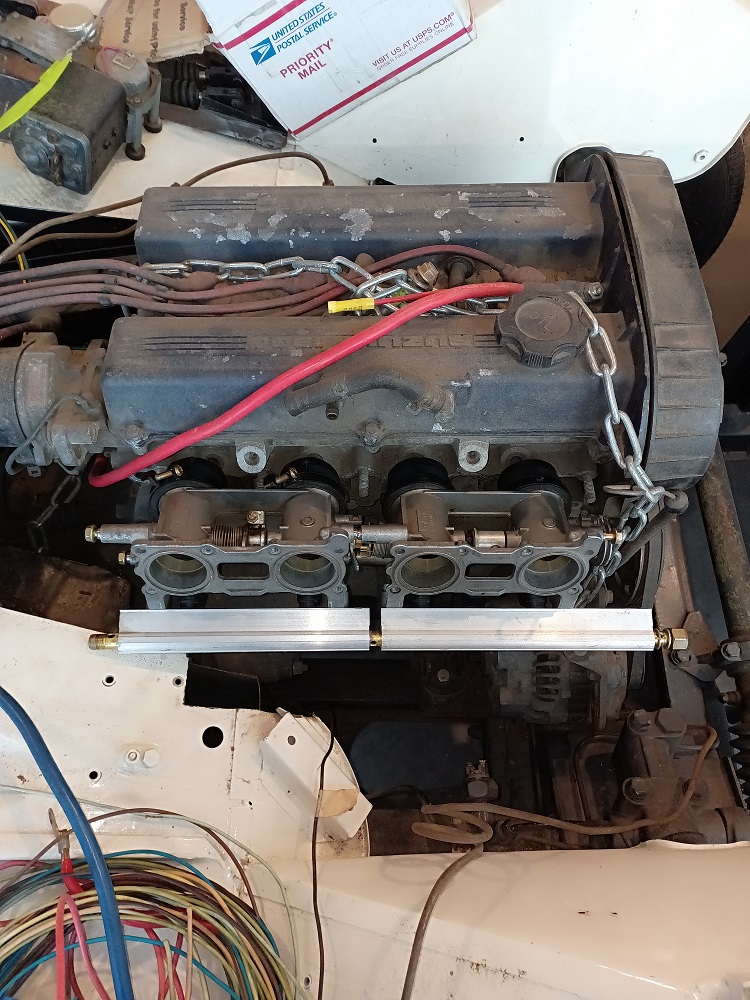

Well this is for another future project I have had on the back burner for a long time. I am still building the Shealey. 1959 Austin Healey Bugeye with a 1300 cc Suzuki Swift GTI twin cam engine. It is mated to a Suzuki Samurai 5 sp. The engine is rated at 100 hp. it comes from a front wheel drive car and is factory FI with a single TB.
O picked this engine because it resembles the Lotus Twin Cam. I have these ITB's from a motor cycle and was thinking the look would be closer to side draft Webers.
I was looking on line for a management system I could use to run 4 ITB's. I have to admit I did not spend too much time searching before it became obvious I should ask some questions from guys that do crazy stuff. Like Chis for instance. (IMG:style_emoticons/default/biggrin.gif)

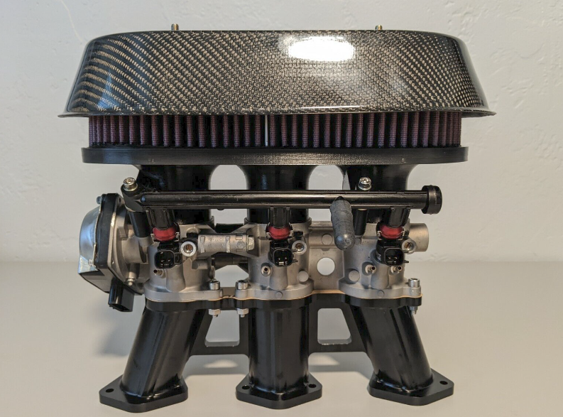

I'm using electronic itb's with motec. I have no clue what to do with it but Peter Dawe's son Kelly can program it in his sleep so that's what we are using.

QUOTE(mepstein @ Nov 6 2022, 05:04 PM) *
Super curious if this setup would work under a factory airbox? Looks like it might, given your filter setup.
