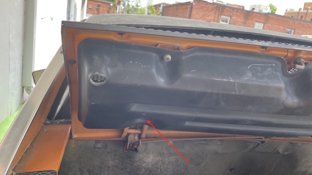

had a scout through files from EC-A EC-B research.
this is best i could do for a photo.
its from a car that was sold on BAT about 6 months back that was down, but pretty unmolested. had all sorts of original stuff on it including recall sticker. reliable i would say.
you can only see the screw retaining rain tray on truck lid edge.
mine look similar to this. possibly were cadmium once but its oxidised.
the bolt i am talking about being like rain funnel bolts is in the rear recess either side.
where arrow points.
nothing anywhere in my files had a clear view of it on any cars. its just recessed far enough it never appears visible on any photos. (IMG:style_emoticons/default/sad.gif)
have drawn a blank there.
logic tells me they should all be screws.
but then again....we sure have found plenty of odd bits of logic when it comes to the 1.8s. anyway i wouldn't swear on mine.
interesting prompt from you. never taken a close look at those rain tray fixings before.
(IMG:style_emoticons/default/confused24.gif) (IMG:style_emoticons/default/beer.gif)

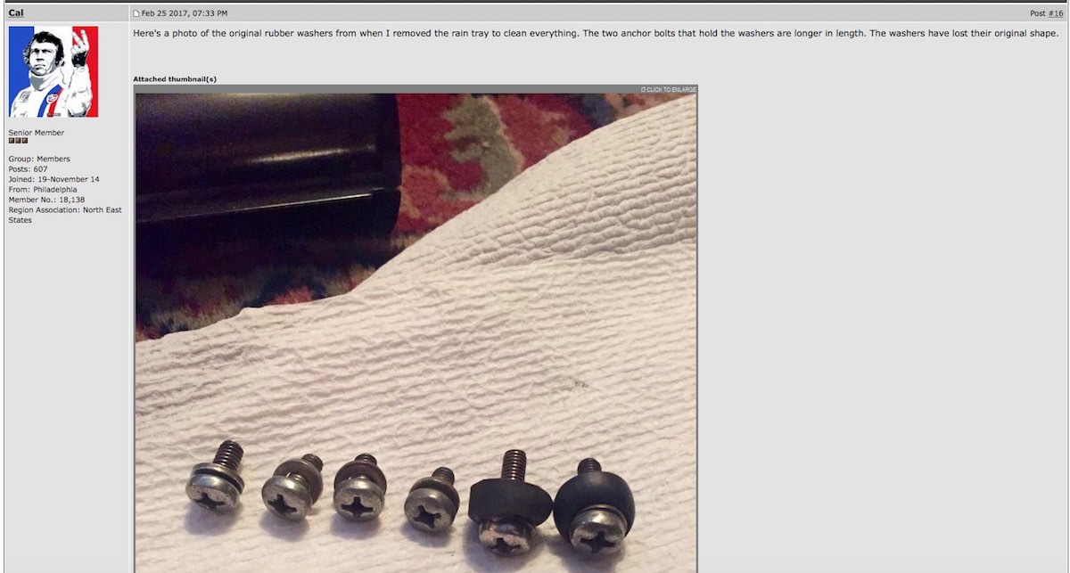

i found this on a thread here.
http://www.914world.com/bbs2/index.php?showtopic=305228
i would say the two longer screws with washers and 1 shorter screw match mine across the trunk side. i can still see the rubber spacers in mine. they are a bit perished.
and i'm going to guess that the 3 M6 bolts on mine across the cabin side probably are not original. someone maybe took the rain tray off before i got the car 33 years ago and maybe lost the screws?
or heinrich ran out of screws at the karmann factory 50 years ago and walked across to the funnel box and borrowed some of those M6 bolts before he knocked off for a pilsner. (IMG:style_emoticons/default/beer.gif)

@wonkipop Now those two longer screws make sense. I think I have an extra pair of those valence spacers; mine are gone.

I checked and believe the comment in the thread that these spacers are different than the rocker spacers. The bolts are much thicker so the holes in my pair of spare rocker panel spacers were much too small. Seems right as the rocker panel bolts are much thinner. Can’t speak to the valence spacers as I’ve not compared to them.
No problem, though. Worked with my assistant Makita and got the job done!
