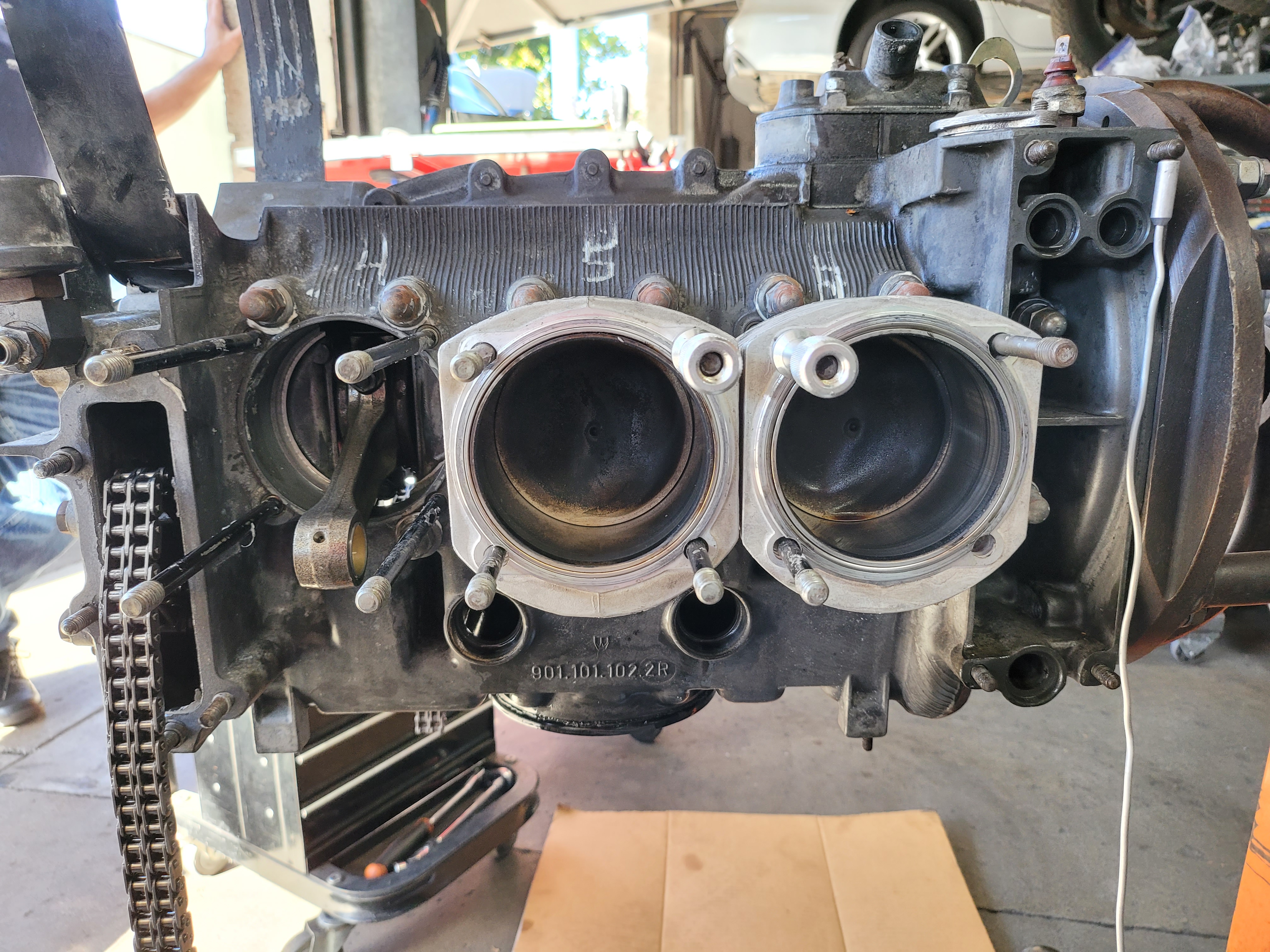

thanks the pistons in the engine now look like this and was thinking keep these or get new ones since the engine is openAttached Image

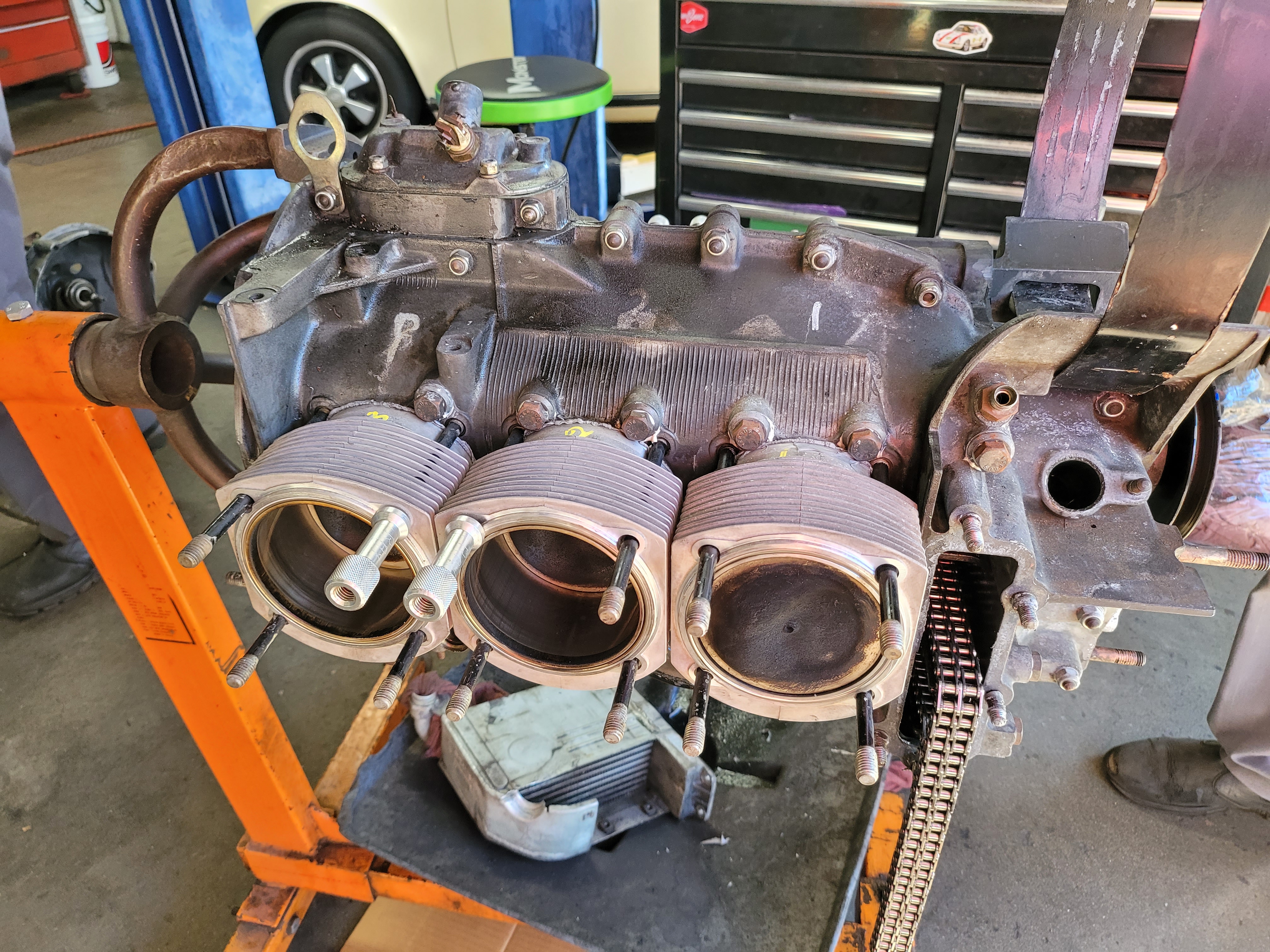

another picture

Pistons for the CIS fuel injection are not a great choice for carbs.
As stated previously - Mahle is the gold standard and bump the compression ratio. You should also ditch the mild CIS cams - your leaving HP on the table there too.

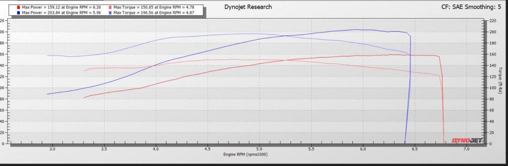

While the 2.7 RS pistons and Cylinder do not have the best compression they can still be used to make good power. This is a dyno is of my friends engine. It had the larger port 2.7 heads and used 2.7 RS P&C that while used were still in spec. Cams were MOD S. Intake was Weber 40's and headers for exhaust. I bit more compression would have helped., but not bad. Blue lines are 2.7 red are 2.4 with E cams same port heads with 9.5 compression, same car, same dyno. I think most would want the 2.7.
