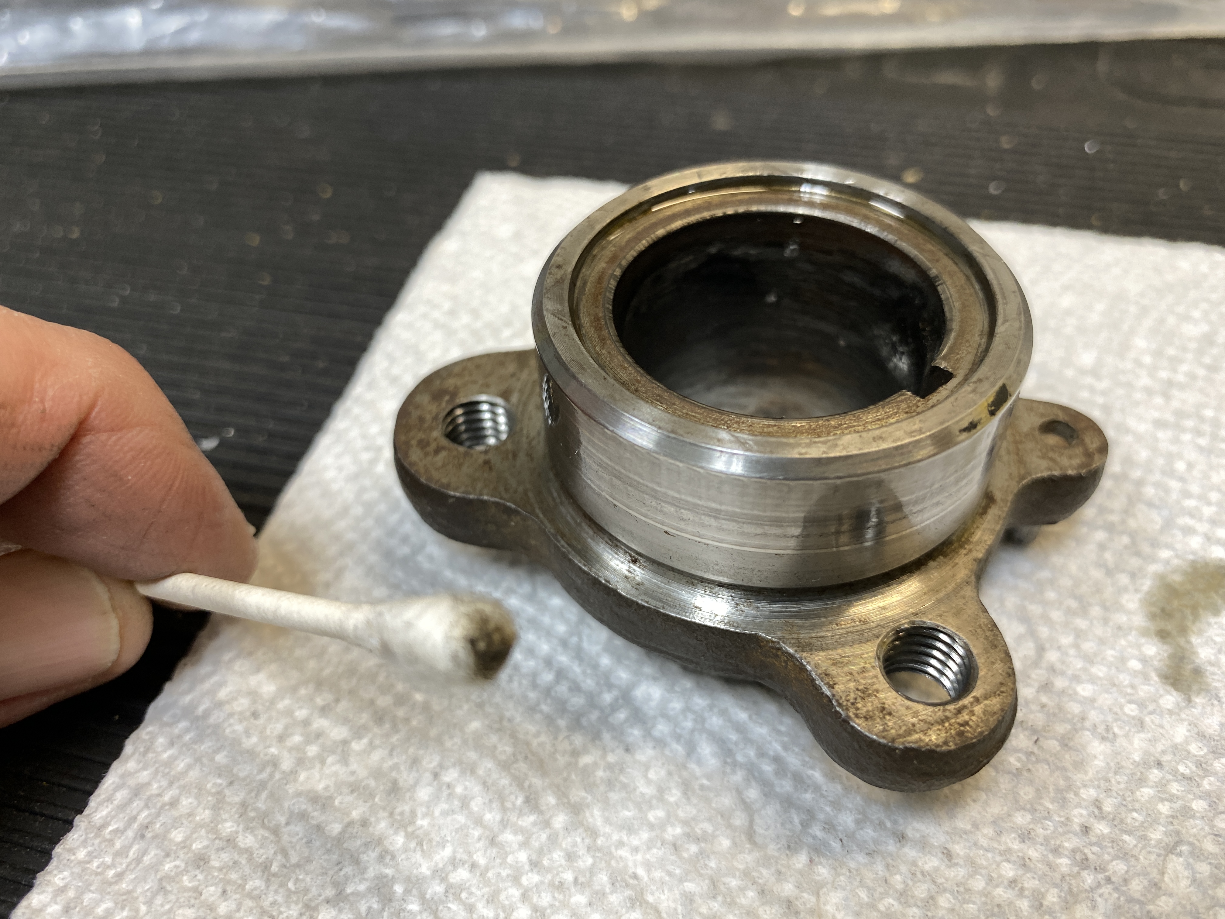

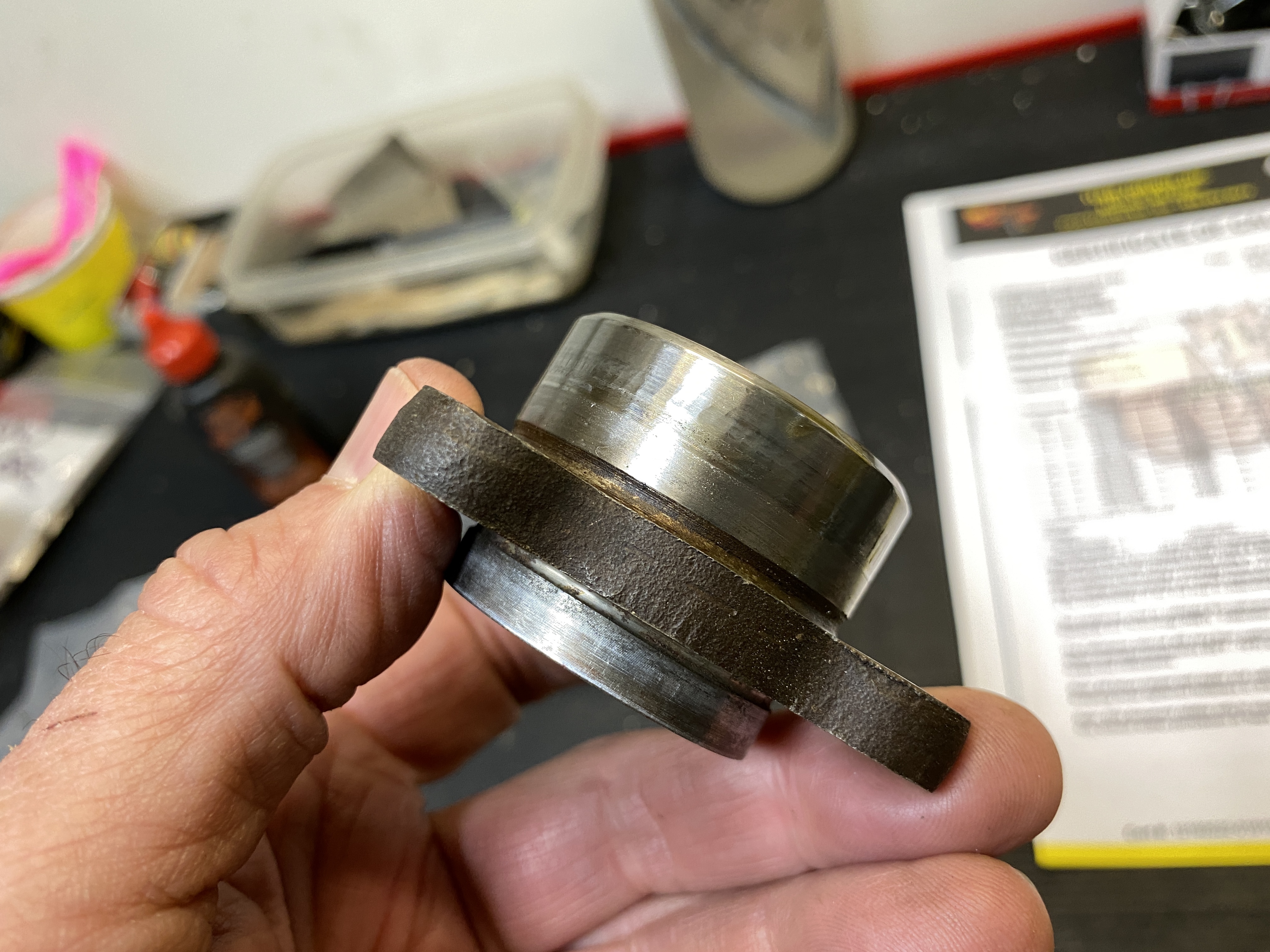

OK, more info. And in my quest for the right answer, I embrace all shame and reveal potential stupid. (IMG:style_emoticons/default/screwy.gif)
I took off the blower hub. The area behind the flange actually looks dry.
bkrantz
post Jan 9 2023, 08:15 PM
Post #31
Posts: 8,646
Joined: 3-August 19
From: SW Colorado
Member No.: 23,343
I confirmed this by running a Qtip around the base of the flange (on the engine side). A but of dirt but no oil. I assume if oil leaked past the front seal, this would be wet.

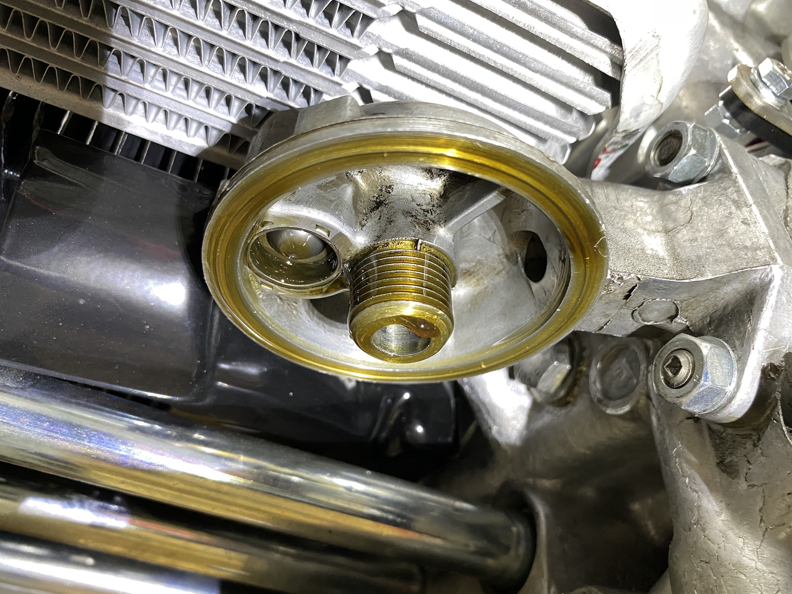

From: SW Colorado
Member No.: 23,343
First stupid: when I went to unscrew the oil filter, it was barely tight. I mean, all it took to start unscrewing it was gentle finger grip.

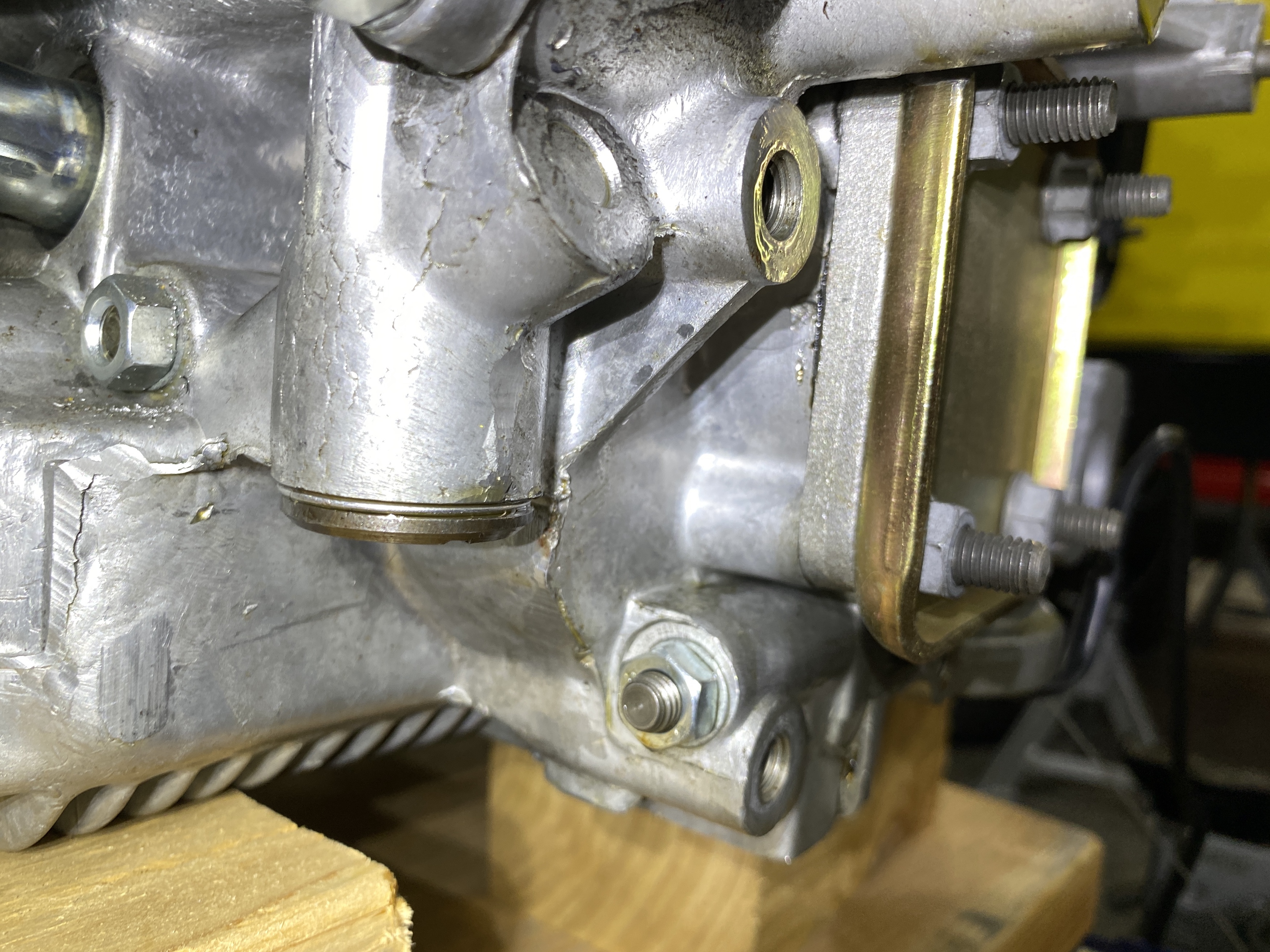

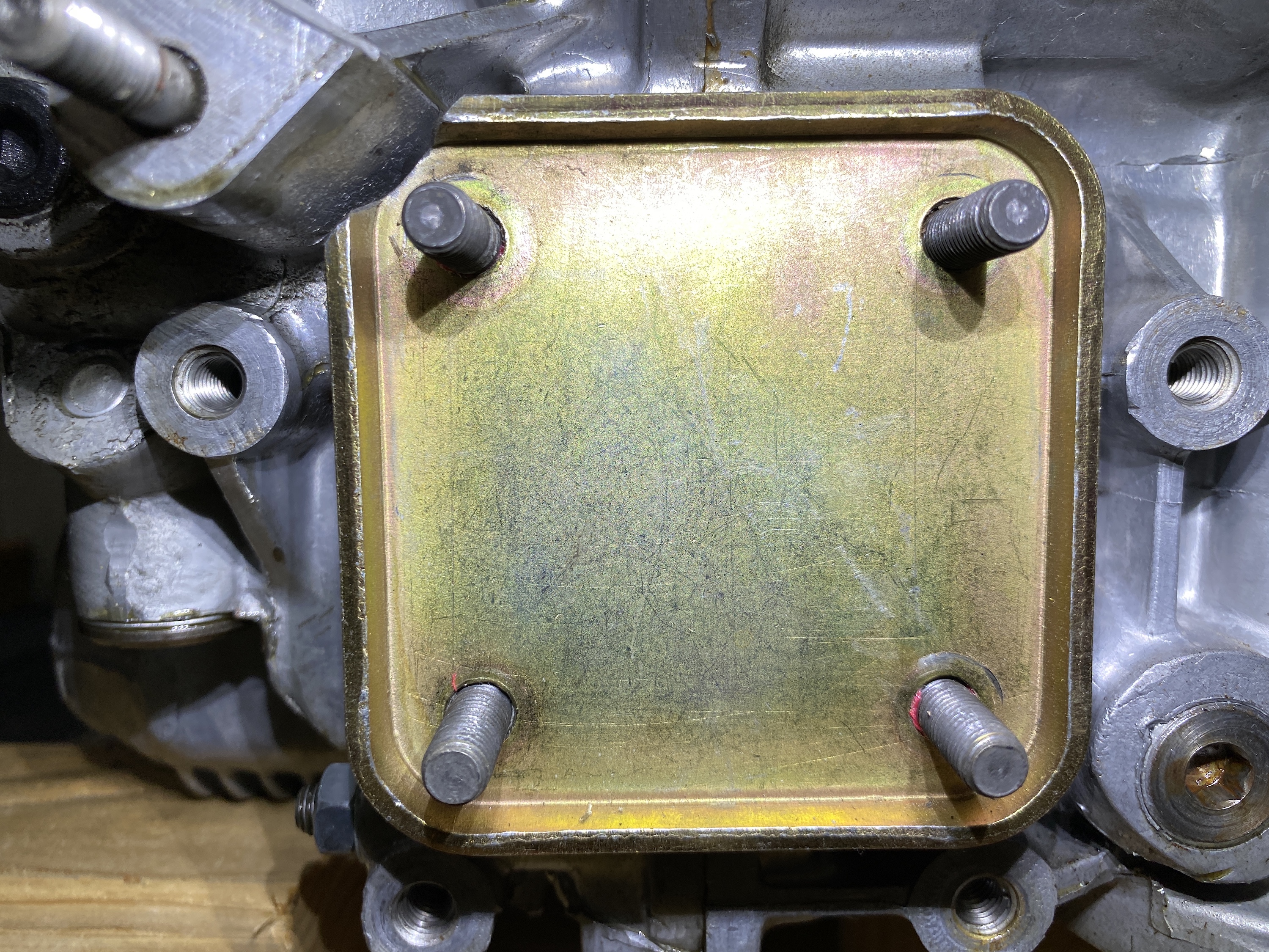

Member No.: 23,343
No obvious leak point around the pump cover.

Member No.: 23,343
No leaks around the studs.

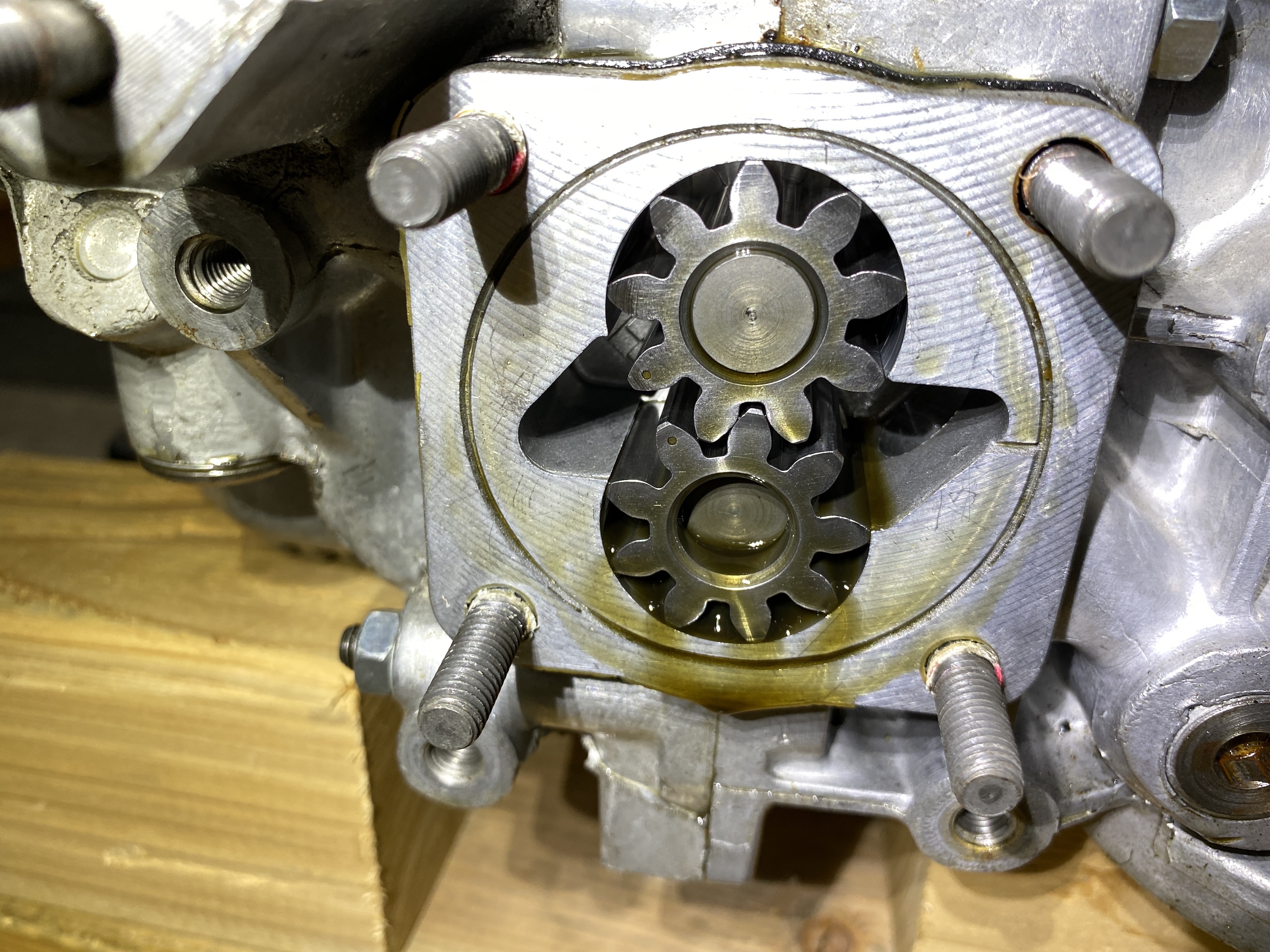

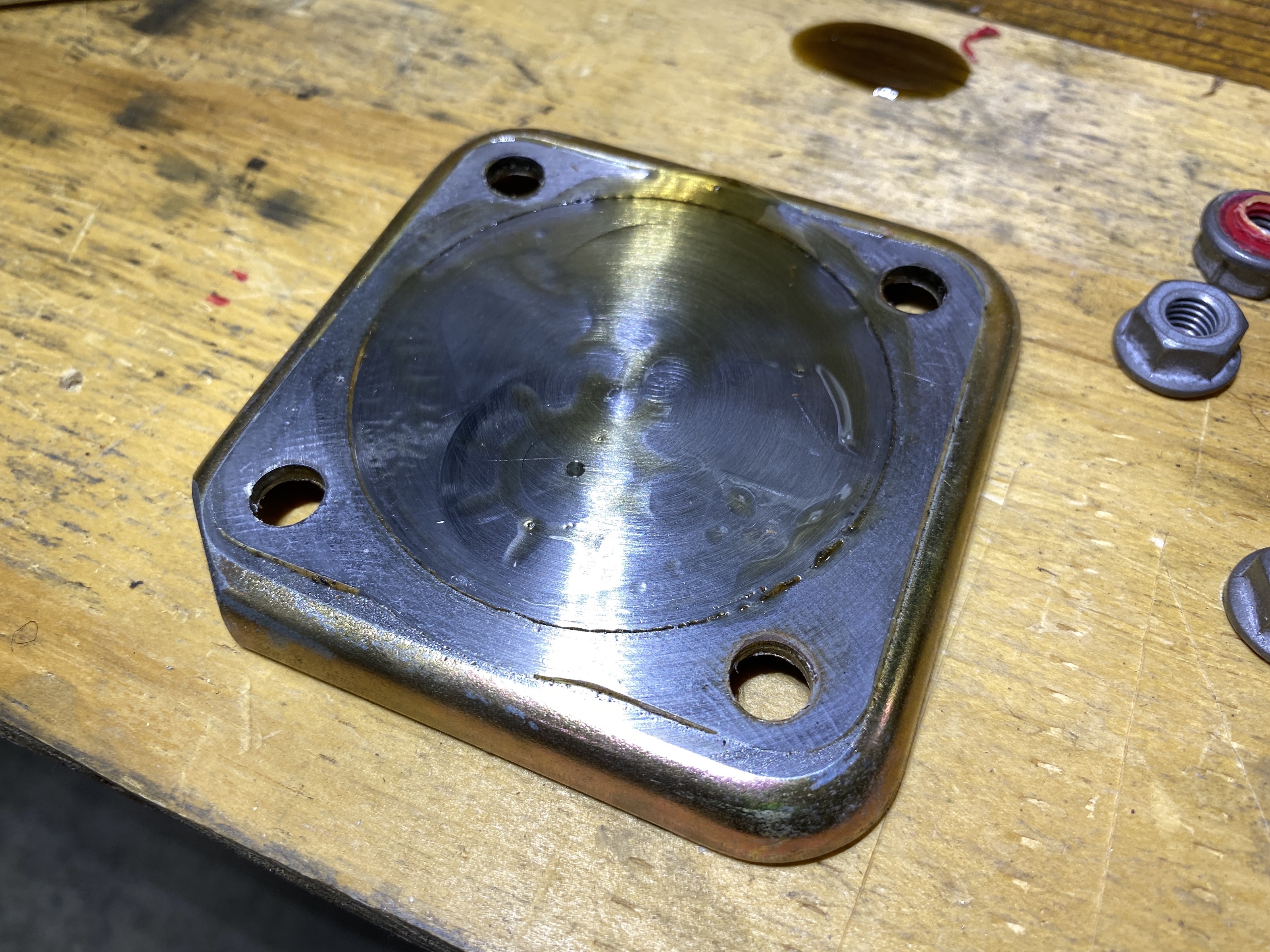

Here's the cover off. No dramatic scoring. Also no gasket. I am trying to remember if I did this on purpose. Stupid #2?
bkrantz
post Jan 9 2023, 08:26 PM
Post #36
Posts: 8,646
Joined: 3-August 19
From: SW Colorado
Member No.: 23,343
And the pump itself.
BTW, if I need to pull this, any clever way to extract it from the case?

I have the same oil pump cover and it was farrrr from flat out of the box. Took me an hour of wet sanding it on glass to get it flat. If you need to pull the pump, one of these works well. Just go slowly or the t-bar bends…
https://www.amazon.com/Puller-Aircooled-Mot...bf6a&nodl=1

QUOTE(bkrantz @ Jan 9 2023, 09:25 PM) *
No gasket, but it does appear some residue of a sealer. When she was running how was the oil pressure, cold and hot? What pump is this?
