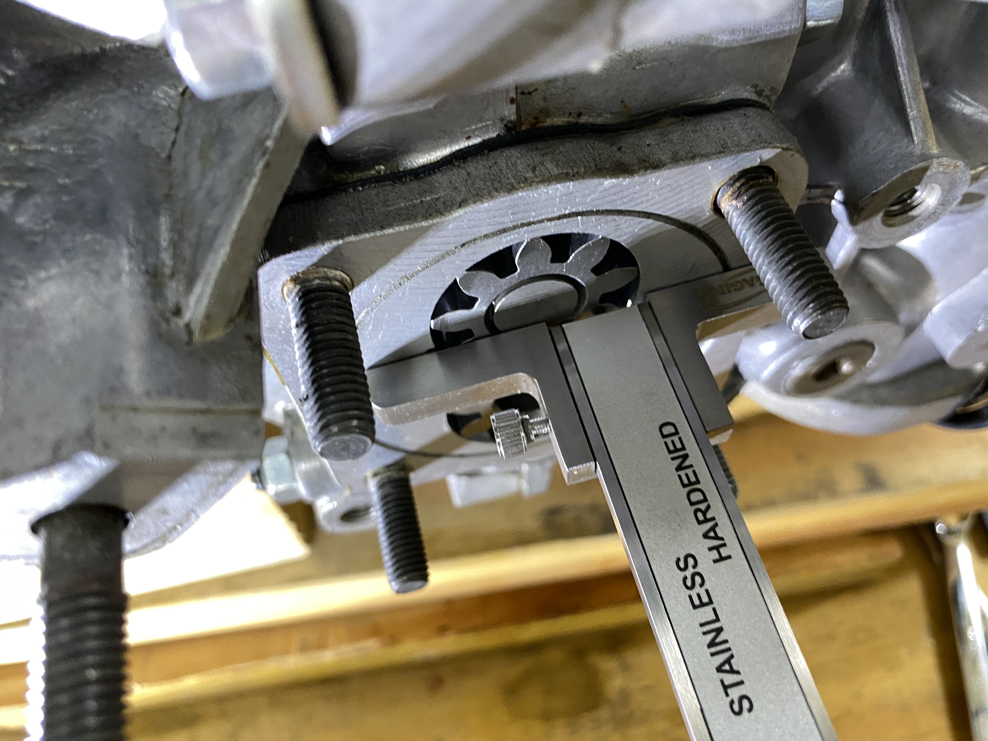

Thanks. I did lap the cover, which was not flat but is now. And I will check the end play on the pump gears.

Let me check my understanding. Optimum gear clearance is .003". I measured my pump gears (relative to the face of the pump) and got mostly .0005 to .001.
The only gasket I have in my stock measures .0045". That would give me clearance of .005 to .006, which might be too much. Are there gaskets only .0025 thick?

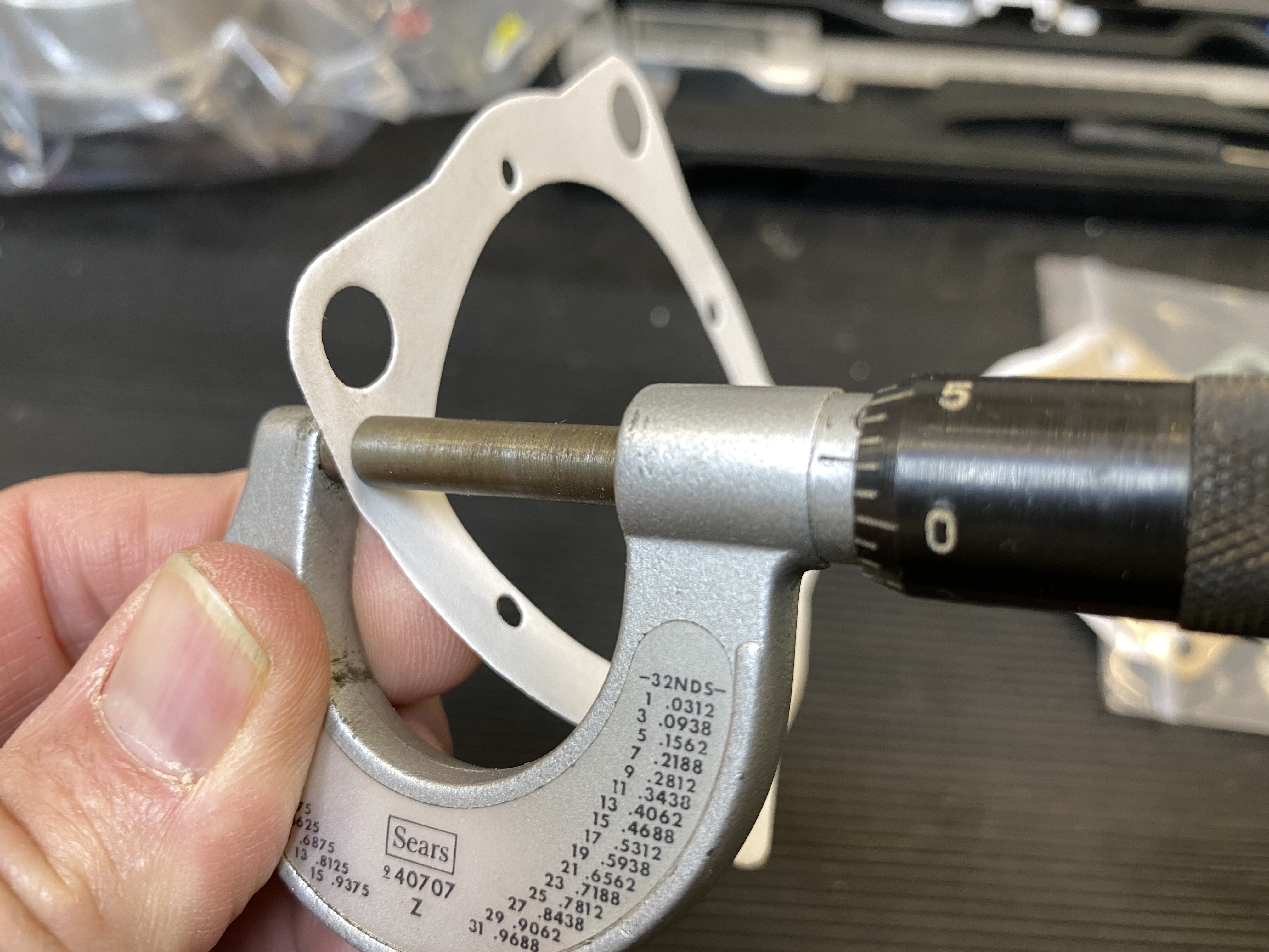

I got out my micrometer, and remeasured the gasket I have.
With no pressure, I got .0035". That's .001 less than I got with calipers.

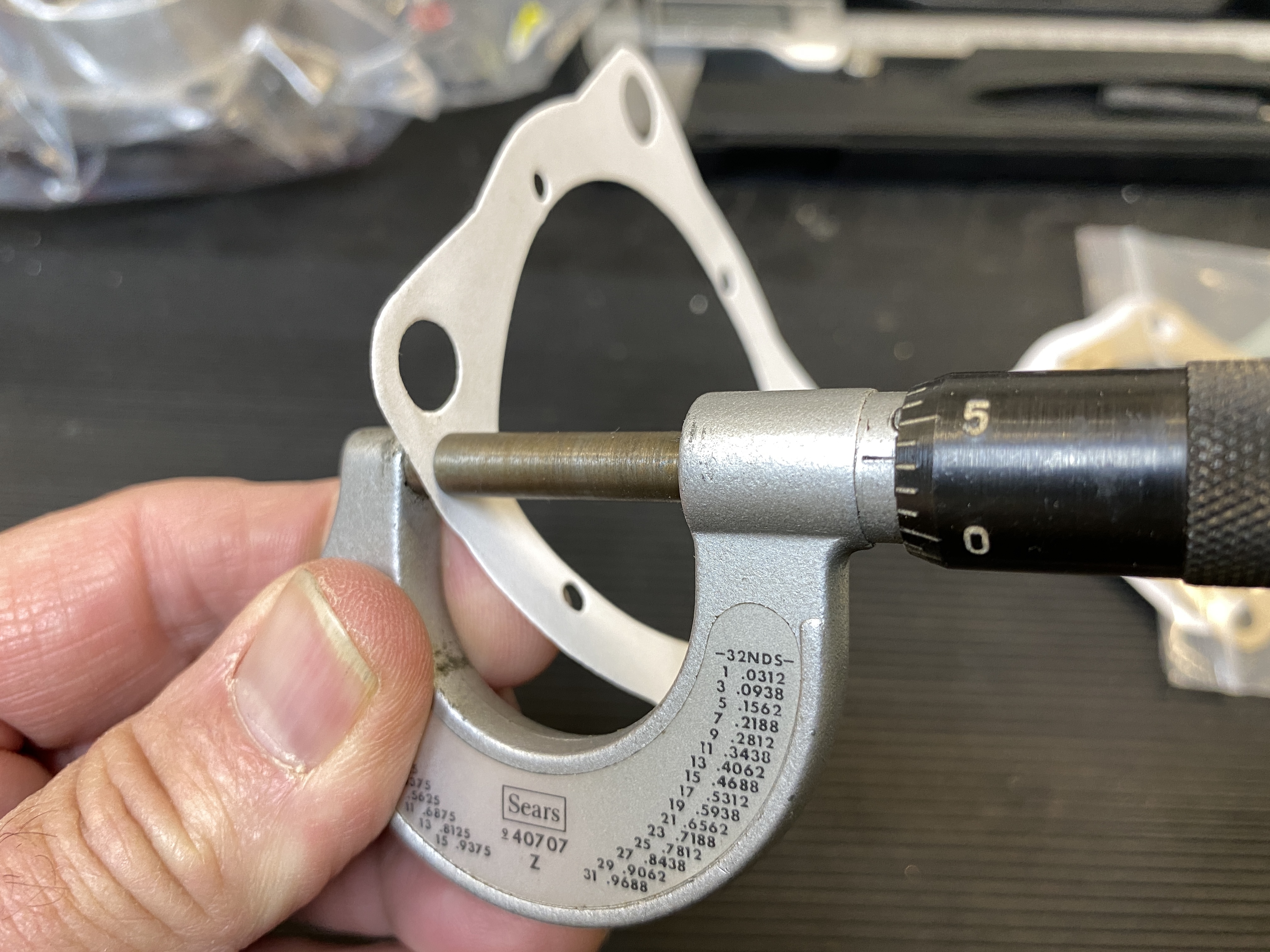

bkrantz
post Jan 25 2023, 08:44 PM
Posts: 8,646
Joined: 3-August 19
From: SW Colorado
Member No.: 23,343
With a moderate amount of pressure, I got a thickness of .0025.
If I have gear clearance in the pump, relative to the pump face of around .001, that give me .0035 total clearance with the gasket installed and compressed. I think that should be right. Right?

930cabman
post Jan 26 2023, 06:00 AM
Posts: 4,572
Joined: 12-November 20
From: Buffalo
Member No.: 24,877
QUOTE(bkrantz @ Jan 25 2023, 09:44 PM) *
I would say you are right on the money. get it together and hopefully that was your leakage issue.
