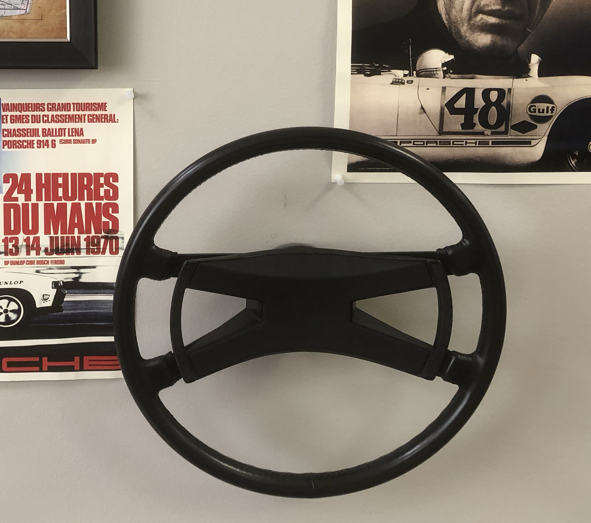

I have seen this before on old leather on steering wheels. You need to refinish the wheel with a 2 step wheel leather refinisher. I got a wheel from one of the guys here and put the super cleaner on it and then sanded it with a 220 wet silicon carbide sheet.
(wet Dry ) and you have to sand off some of the dirt and sweat and then put the finisher on. Like coloring any leather. The picture is not so great, but the wheel looks very good on my wall in my man cave. I got the kit from Amazon not much.

Well that is my exact steering wheel and yours looks great! Please post the brand name so I can search for it .... sounds like what I am looking for....thank you very much!

Are you sure it’s leather and not foam? Foam looks really similar. Leather will deteriorate, especially where the sun hits it. Foam will split, crumble, etc.
I can’t tell you without really good pics if you have foam or leather but the difference fools a lot of people.

What is the meaning del number on the face and f the wheel?
914 347 809 00 Is foam but there might also be another model number as well.

QUOTE(mepstein @ Feb 2 2023, 04:56 PM) *
You know I've been wondering that myself for 13 years?? It has stitching on the inside of the wheel but I am not sure if it is leather or foam? How can you tell? I am leaning foam since I understand leather but I don't know about foam....how can I check and if foam how can I preserve it? Thank you very much!
gg
post Feb 2 2023, 10:20 PM
914-6 GT in waiting
Posts: 20,587
Joined: 19-September 09
Member No.: 10,825
QUOTE(second wind @ Feb 2 2023, 11:11 PM) *
gg
The stitching on the foam wheel looks very authentic. Half of the way to tell is if there’s no split stitching, it might be foam. The leather tends to split the stitching in the spoke corners. The foam rim also has tiny pits in the foam. Broken air bubbles.

QUOTE(mepstein @ Feb 2 2023, 08:20 PM) *
gg
That really sounds like my wheel....I will try to get a picture here on the board....how do you treat the foam properly? Thank you,

Nothing you can do to “fix” a foam wheel other than send it out for a leather wrap ~$500 or a wheel skin cover ~$50
