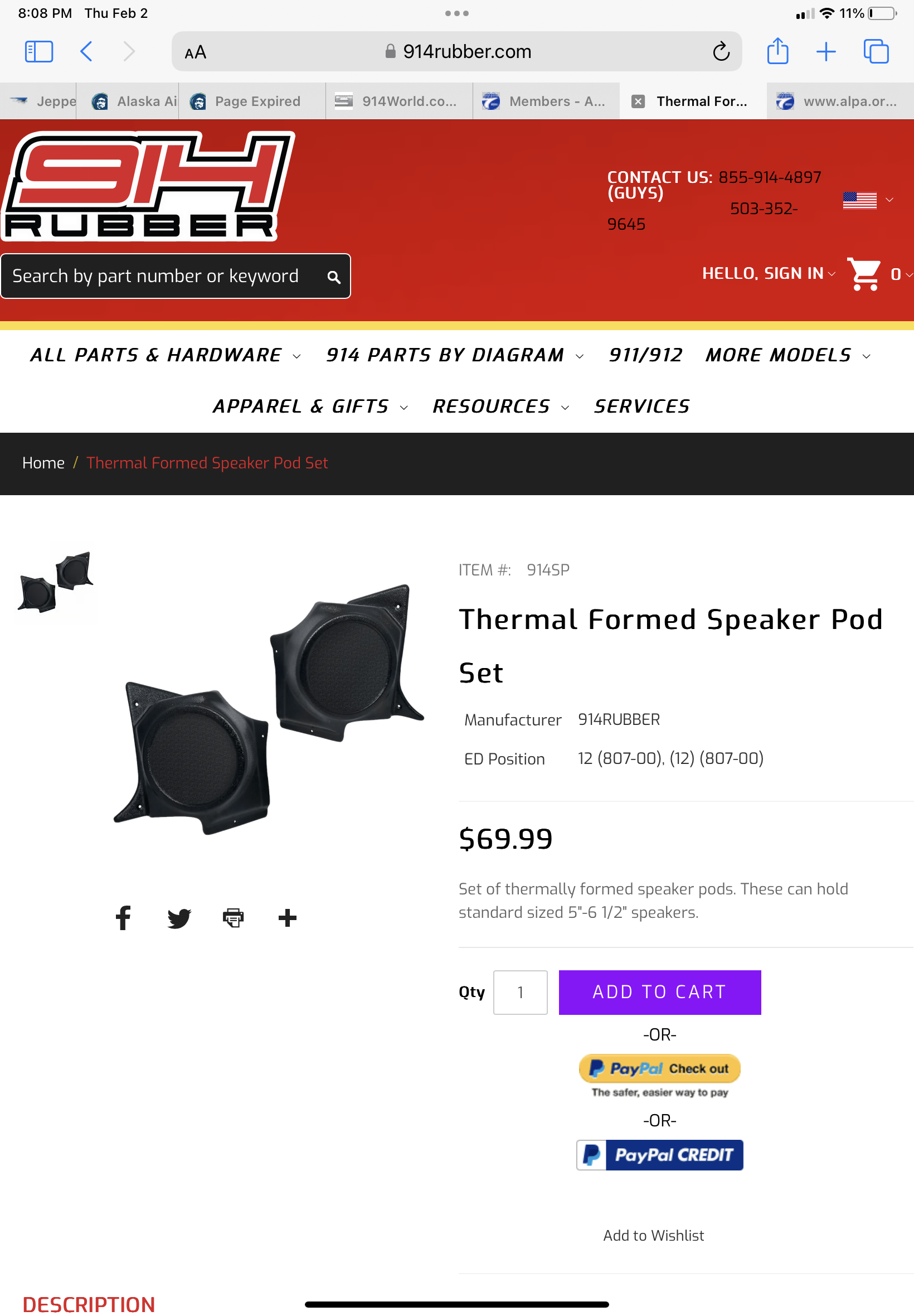

You can just put speakers back in if the door panels are nice. If you are thinking about swapping out door panels, we are doing up more now so can cover that for you if needed.
We do offer a pod that replaces the stock one that allows for 6.5 rounds with decent size magnets for better sound. We now even precut so you can mount easily
https://914rubber.com/uncut-thermal-formed-speaker-pod-set-1
This is not shown in the picture yet

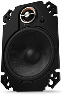

Pretty much any 4x6 will fit but the bolt spacing is usually off as factory is the no longer used metric size.
So options are the AA factory clones, get 6.5" pods, or fit aftermarket 4x6. The 6.5" will give you the fullest sound. You will hate a 4x6 if you enjoy music.

Alpine stereo Alpine speakers fitted to 914rubber covers. Nice and tight! (IMG:style_emoticons/default/biggrin.gif)
