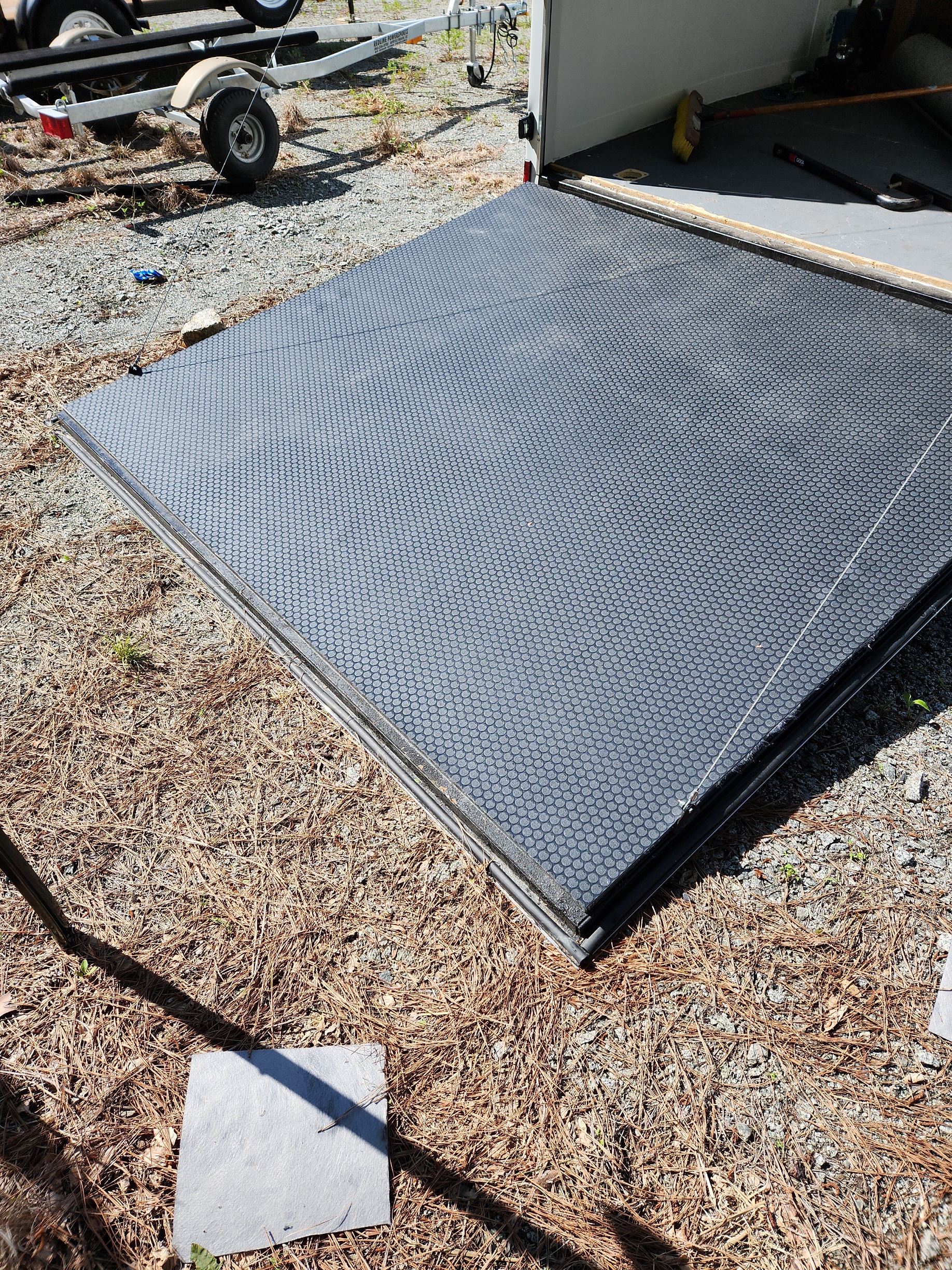

2. Roll vinyl coin pattern in black on floor and tailgate. Ordered and coming next week. Plan to not glue it but use flashing on perimeter to keep it from curling. Also between the d rings and other accessories i think it will stay down. May get some.double sided tape as a precaution... Fingers crossed.

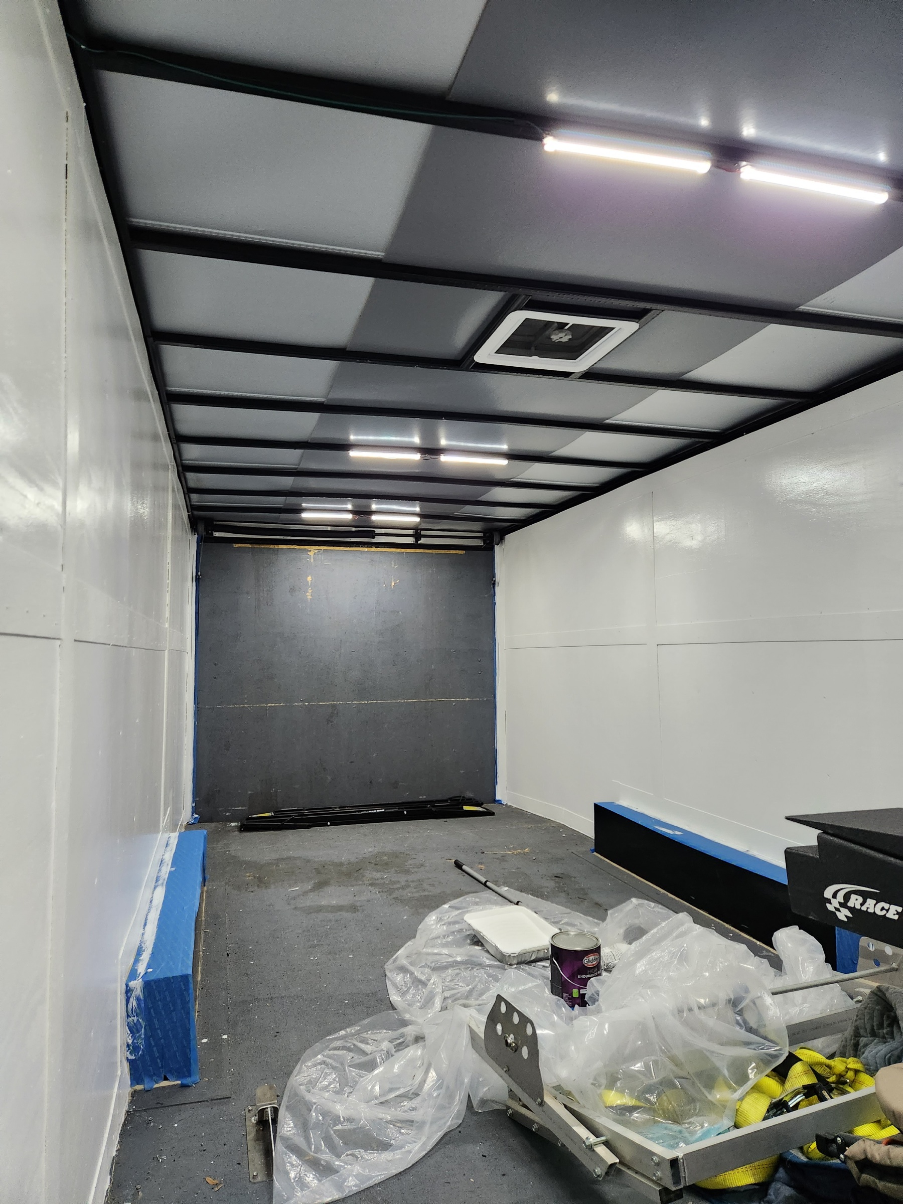

Walls are now painted and as you can see the floors already look trashed.

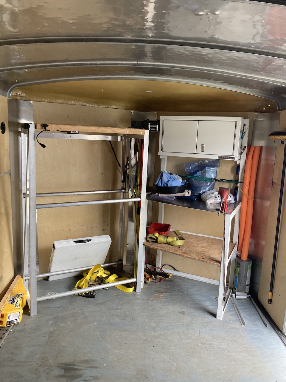

Oh and that pic reminds me. I have an aluminum tire rack that mounts on the wall. This makes me quite nervous even if i run bolts all the way through the studs to outer skin. Thoughts?

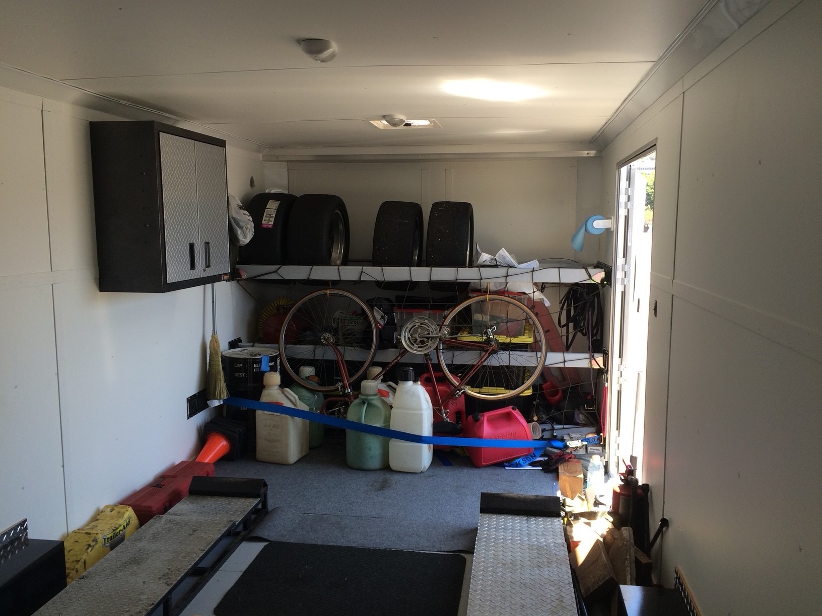

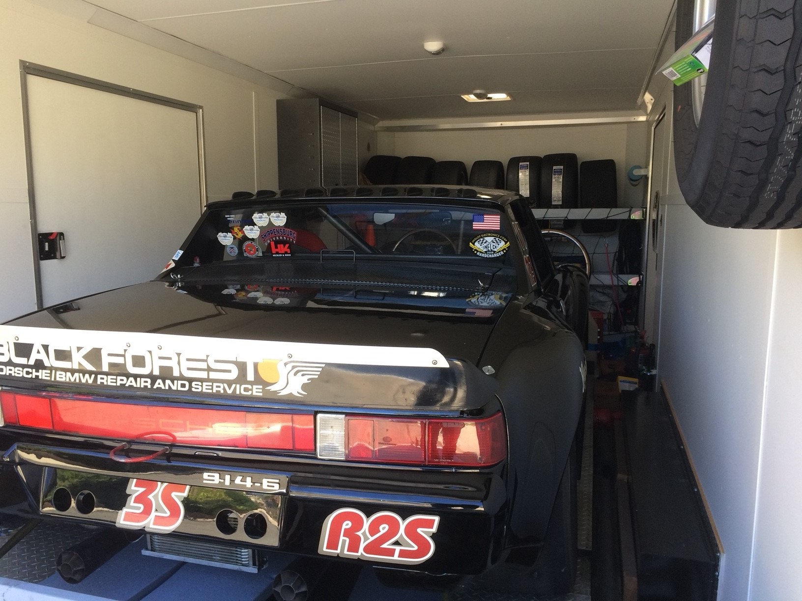

Looks similar to mine, but mine is 20'. Three photos before racks and three equipped for racing.

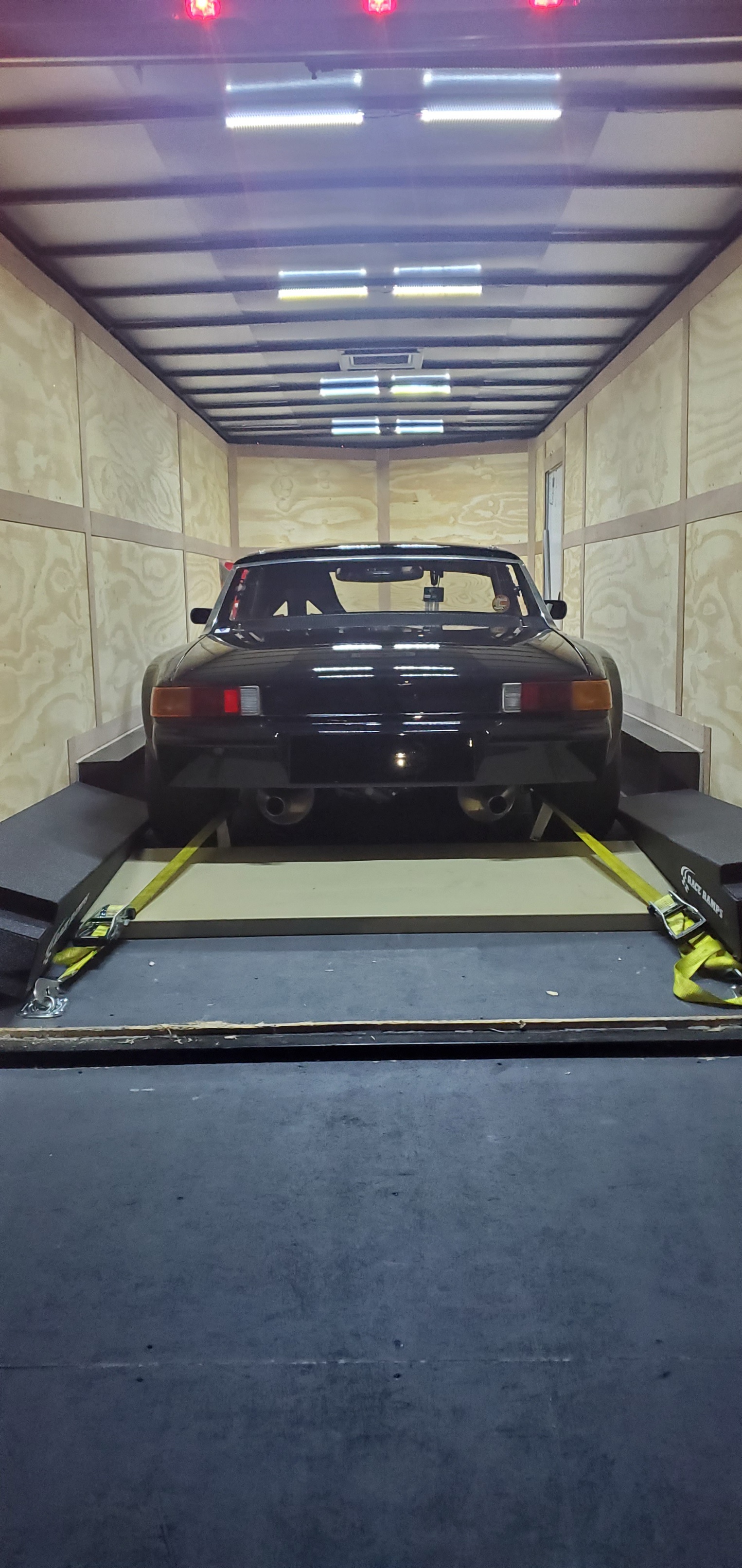

We have a 24/V nose also

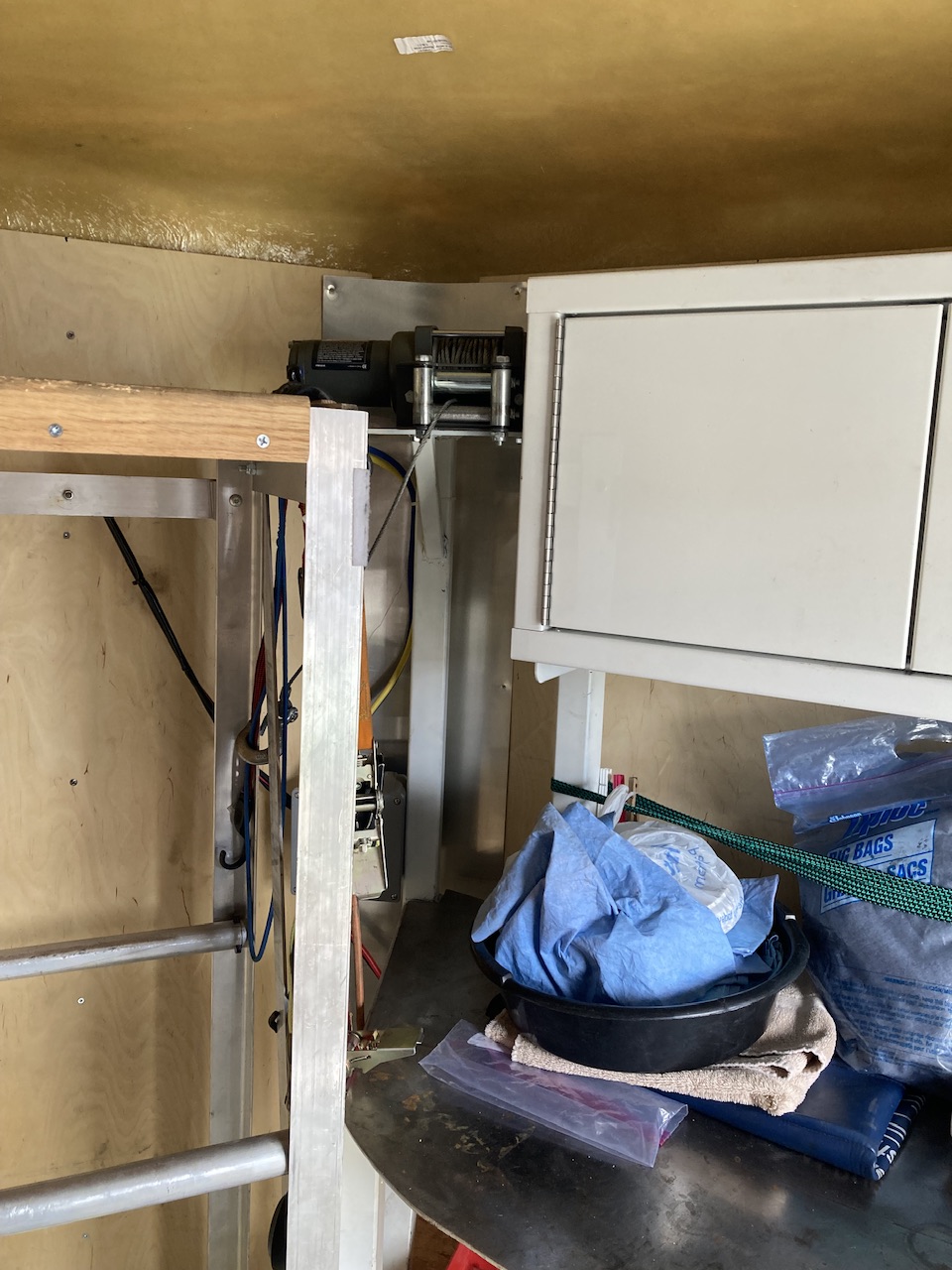

Tied the winch into a large-heavy built cabinet structure
Angled everything to fit the V. Winch up high

My winch is centered on the floor in the front. Is it better having the winch located high?
I only ever had to use my winch once when the transmission failed.

Having a winch is great. All the ones I’ve ever used are low. That way they don’t pull off a front spoiler. You might have a protruding tow eye on the front bumper but you want to make it possible to pull in any car (in my mind) Also, I bet it’s easier to reinforce the mounting point on the floor.

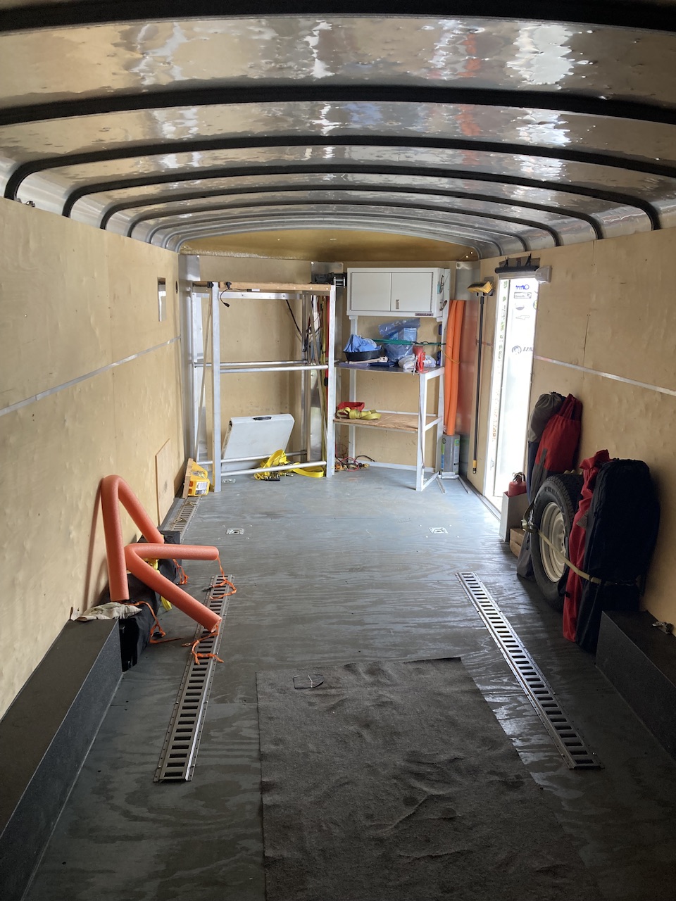

Am thinking maybe i should go with the etrack and crossbeams for the two spare sets of wheels and tires. Will have to see where that would work. In current setup would probably have to do it in the very back. Meaning unloading every time...
Here is where i.made it to today. Was not fun assembling but once i figured out how to keep the frame frame falling apart constantly it got easier. Have the bottom shelf on upper cabinets to build then jump into the bottoms. So much to do!

I like it up high
Don’t have to bend down and crawl under the bench to get the cable. Everything is at arm length and eye level
It isn’t blocked by tool boxes on the floor
I exclusively use the winch to load and unload the car every time
2.0/ tall first gear and a 5.5 inch clutch that will not withstand slipping
It’s a straight shot for the cable without dragging on the ramp lip at the door
And have never struggled with a low car but could use a pulley in the E track if I needed to

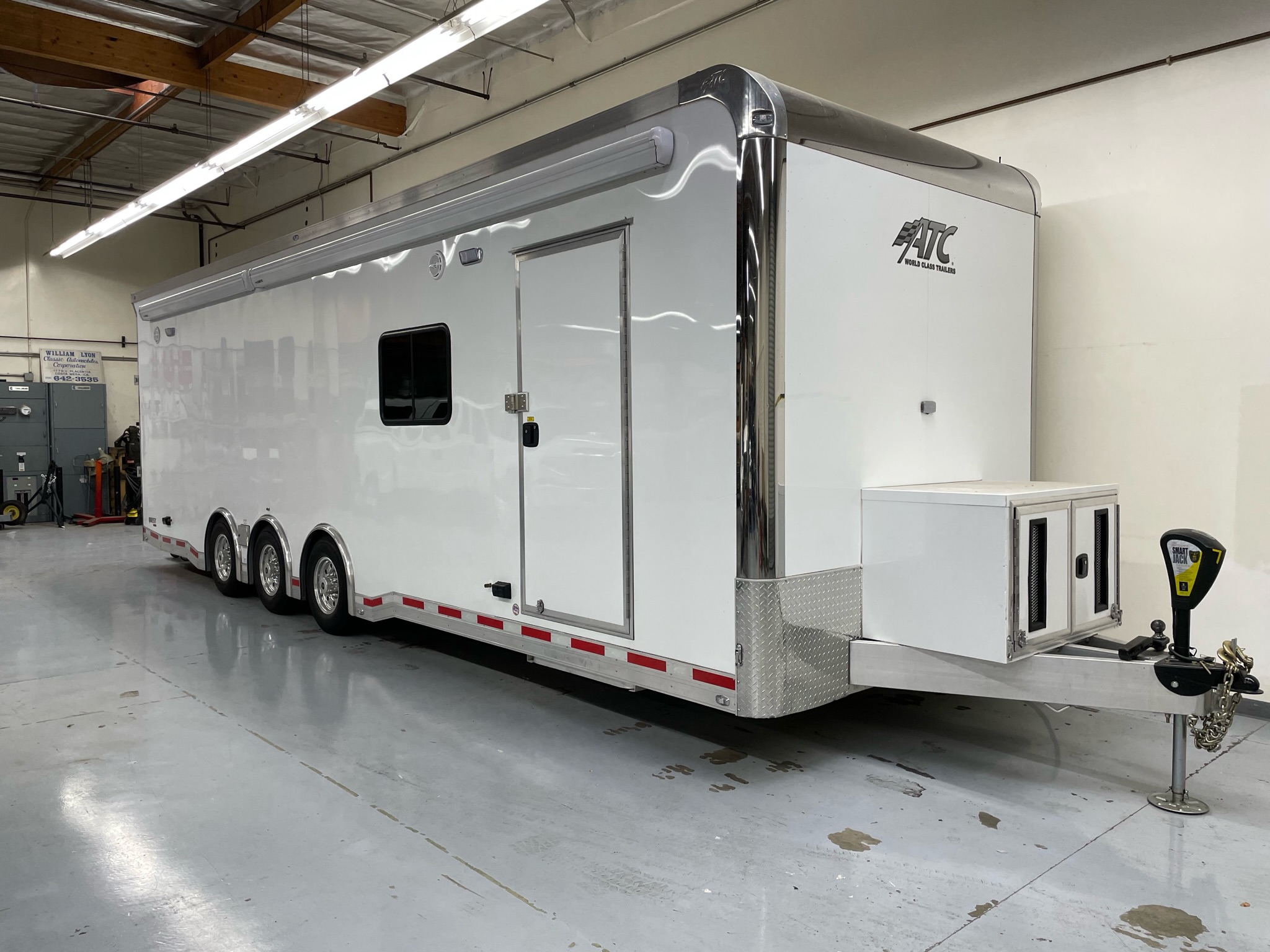

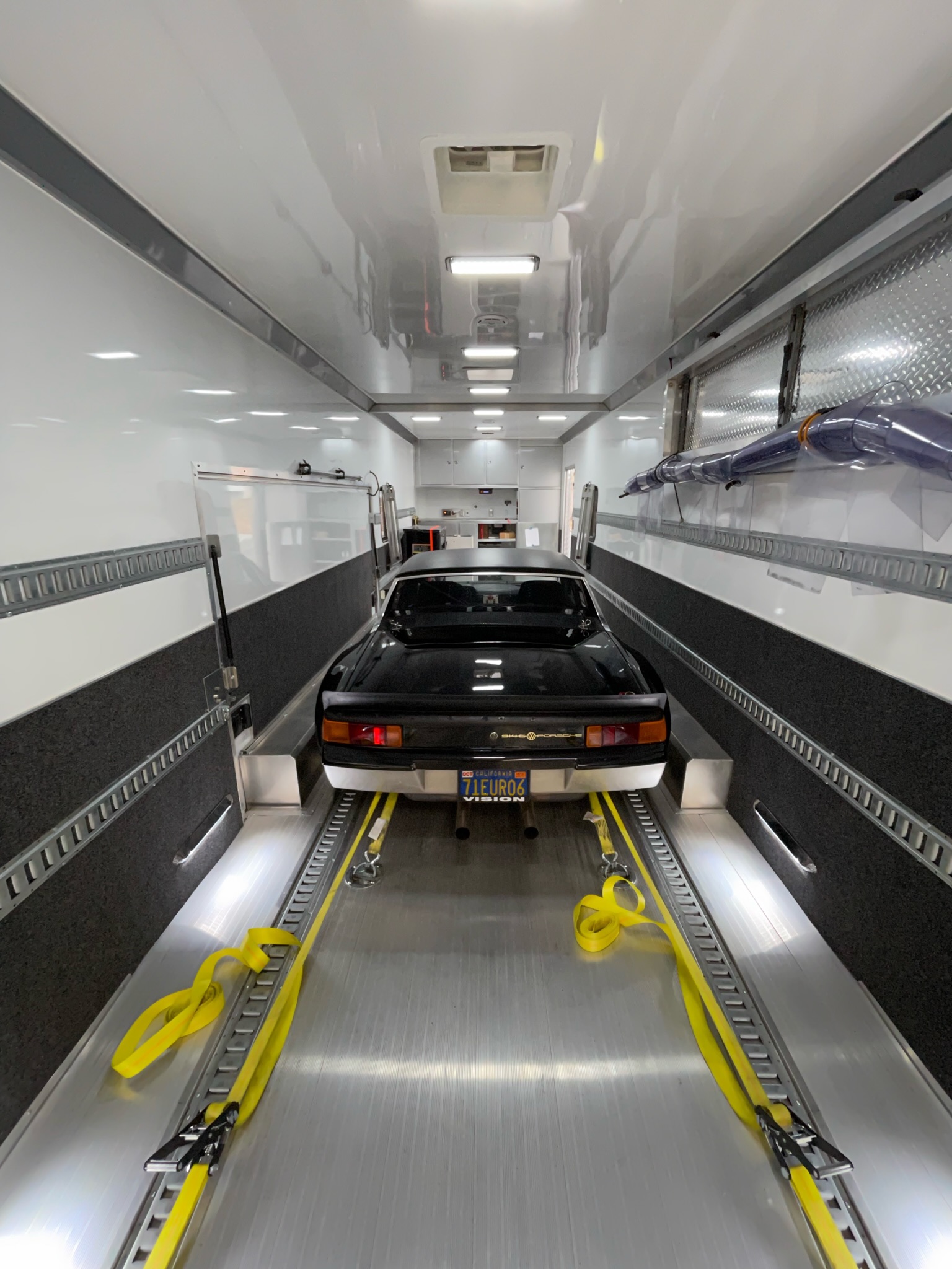

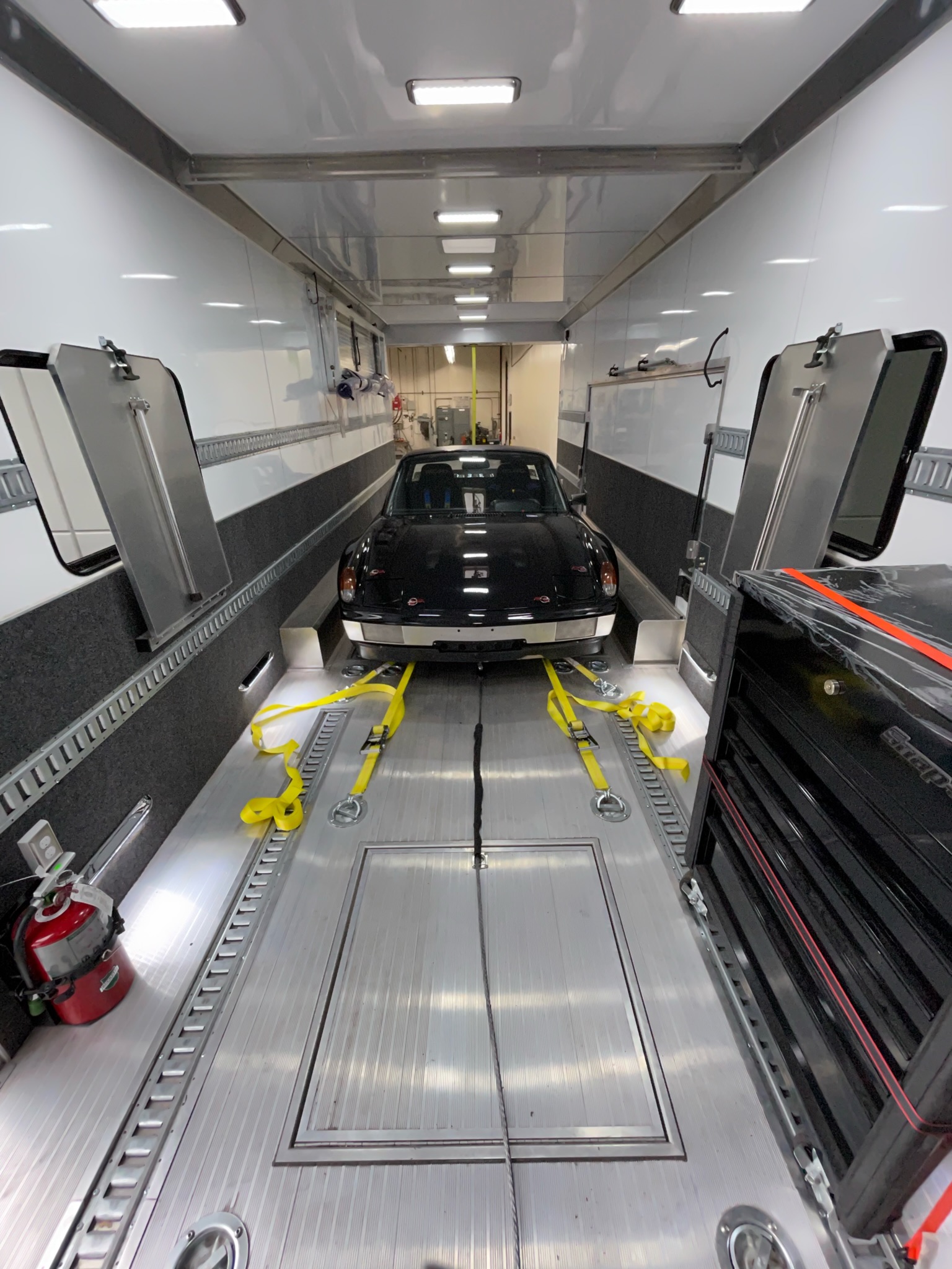

E track on walls and floor sure make it handy to strap down other stuff, tables chars toolboxes etc…. Don’t forget outside the trailer, a retractable awning is nice, easier to set up and stow than an ezup. Lights, speakers, etc. definitely endless…
Here’s a no expense spared 35-40 footer my friend lets me use, heavier than shit, but it’s got most everything… deep upper and lower cabinets and workbench behind me in the pic. Winch mounted low.

Yikes that really is gorgeous and way grander than i need for sure! Oh to have unlimited funds.

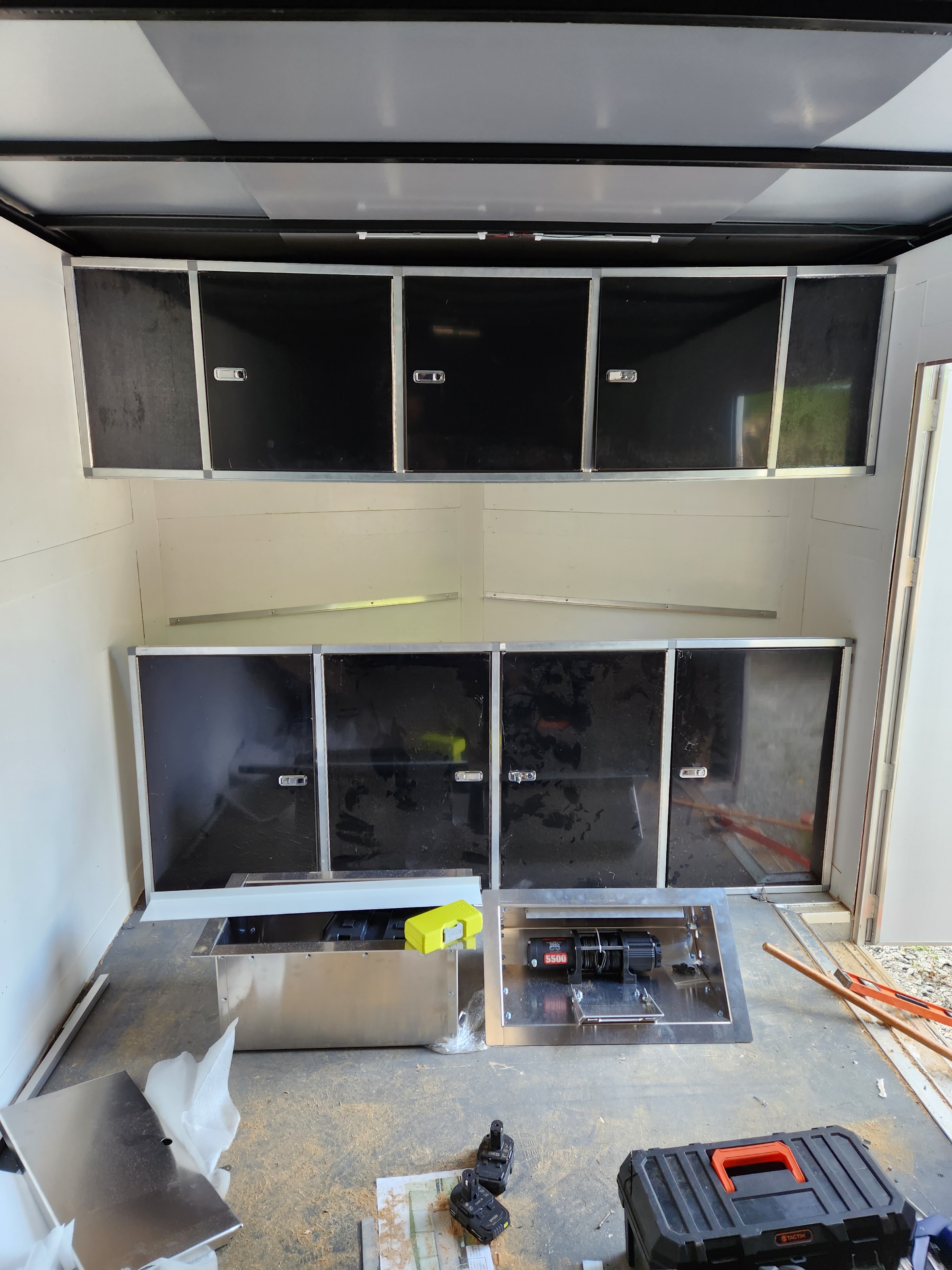

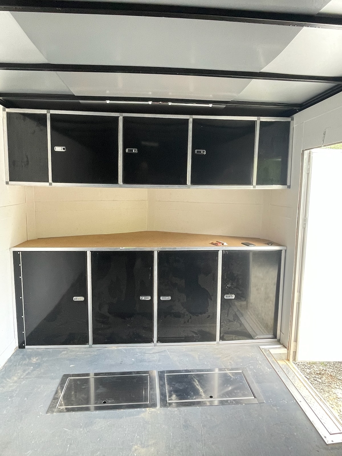

Made good progress on cabinets today. Have uppers done aside from.a couple extra braces under the floor. Have the counter for the bottom ready just need to finish securing the face and finishing the side panel.
The floor battery and winch boxes will go in place tomorrow but not fully secured as i still have to lay down the floor. Will cut the holes, drill for the through bolts, but not tighten it all down. Will pull up the d-rings and cut the flooring to fit, then spray glue and reinstall all the anchors and boxes.
Then there is all the wiring which i am an idiot on so will either try and get some help or sub it out. Maybe i can just follow the directions lol.

Cabinets and the battery and winch boxes installed!

Getting there! Today was really securing the cabinets and getting the battery/winch boxes installed properly. For cabinets added additional bracing and fine tuning. Going to take the trailer to a metal shop to get the floor of the upper cabinets done in 1/8 aluminum along with proper strap braces. Will likely do a double floor to minimize denting and keep things looking nice.
Also started in on flooring. Took out all the D-rings and the floor boxes are ready to pull back out. Did the big back door for just the flooring and will add L trim this week as i get time around the edges. I think it is gonna look great.
