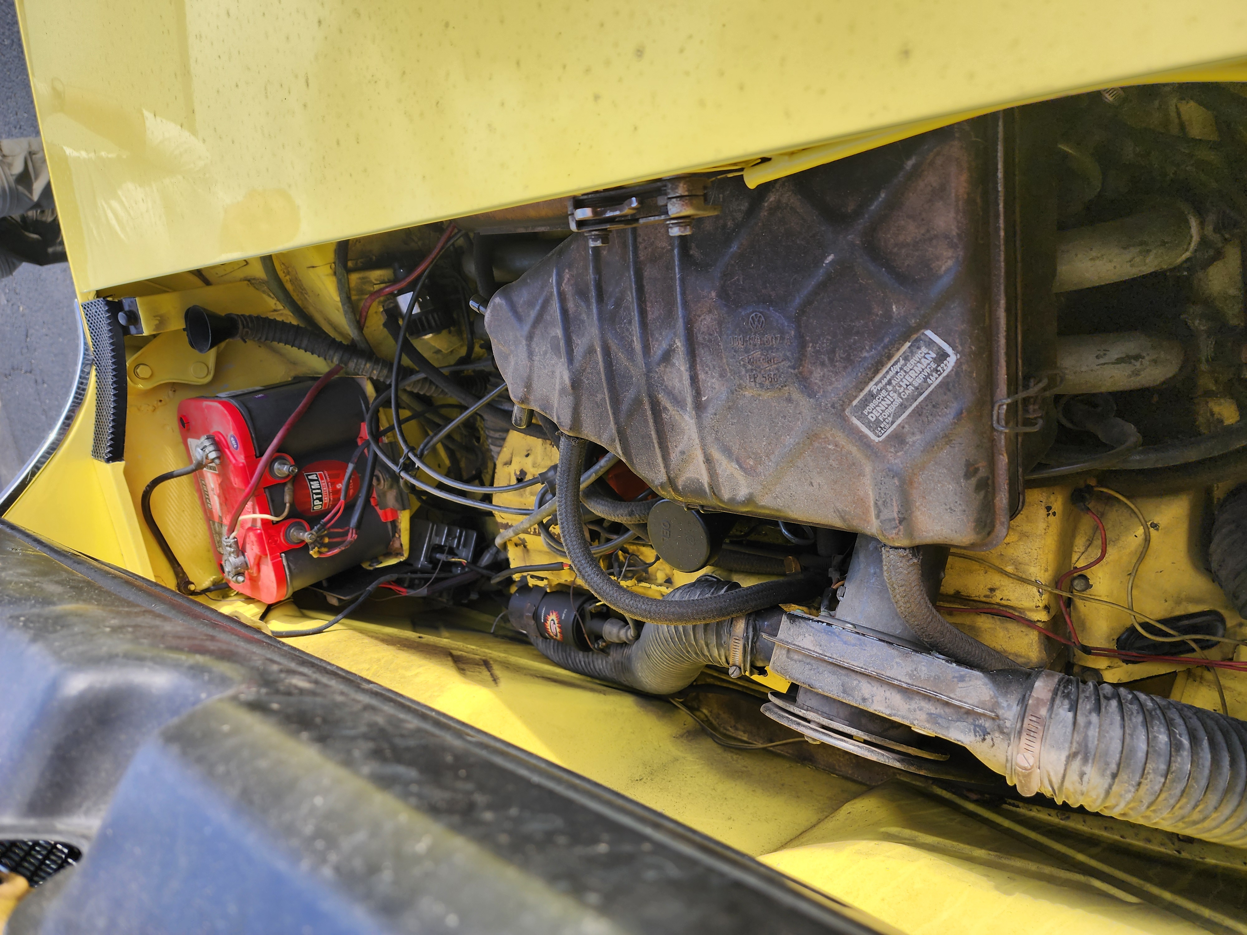

I have this system from PMB on my '73 2.0 liter. Self learning is a bit of a misnomer. You can't just drop it in and have it run while it learns. It takes someone like James to set up the tune.
I had my system installed by PMB last summer. I have been very pleased with it, but did have some starting issues. Since James was at RRC, he kindly hooked up rhe laptop and adjusted the tune. It is like a night & day difference! The first tune resulted in performance not that different from my well-running stock D-Jet system, but now my seat-of-the-pants observation is that the car is quicker for acceleration, pulls stronger, and runs smoother than ever.
Since I'm in the neighborhood, I'm headed to PMB tomorrow for James to install a firmware update and fine-tune the setup. I cannot recommend this setup highly enough!

Here is the picture for you
