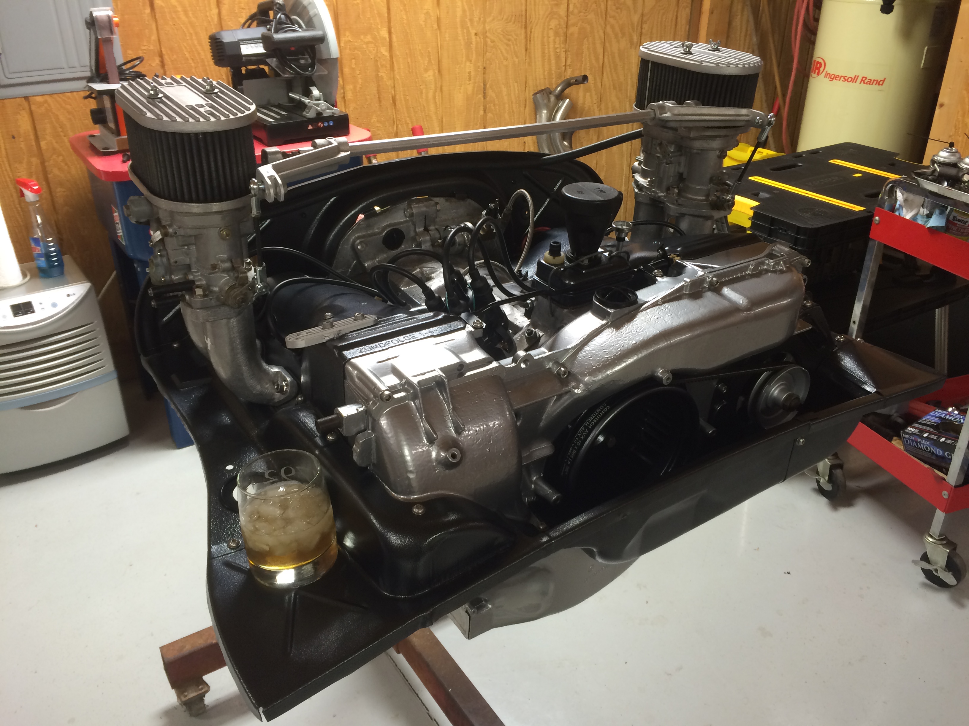

2056, dual Dellortos, has been running well for a few years, except in hot humid weather. When it gets hot out, she is hard to start once warm, gotta open throttles all the way. Leaving from a red light also difficult, gotta "clear" the carbs out by opening throttle. Runs fine in high RPM (throttles open(ish)).
Current set-up:
Idle Jet = 55
Main Jet = 150
Emulsion Tube = 64
Air Correction (jet stack holder) = 180
Venturis = I forget, but she runs well in mild temps.
I am thinking idle jets can go down a size to 50, or maybe 45?
Pic because pics help everything (and don't bash my hex bar linkage, I quite like it)...

First, get rid of that hex bar linkage.. (IMG:style_emoticons/default/smile.gif)

It will also show you why hexbar linkage is bad (IMG:style_emoticons/default/smile.gif)

Y'all bashed my hexbar linkage...
