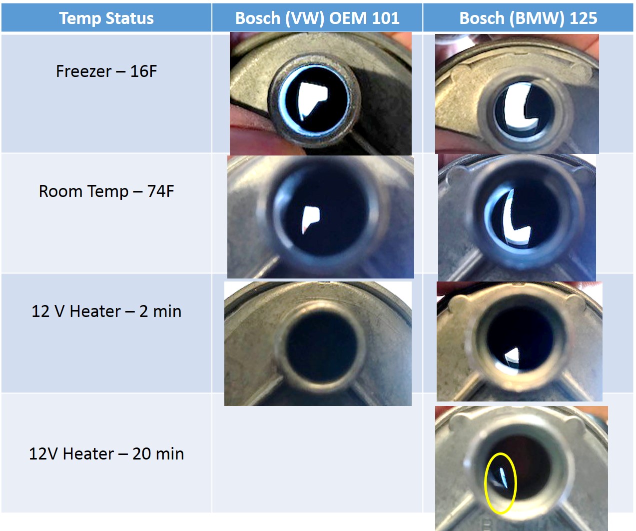

Here are the results of the AAR temp tests - OEM Bosch/VW 101 vs NOS Bosch/BMW 125 units:
The BMW unit starts with a much bigger opening (expected). When 12V source applied, while the 101 unit is closed completely at about 2 minutes the BMW unit is maybe 80% closed. In 20 minutes the BMW unit was still just a tad open, but that can be adjusted by the little screw on the backside (I didn't, as it's a borrowed unit).
Videos of warm up with Bosch 101 unit coming soon in another (or a few) post). Videos and results of Bosch BMW unit after I swap it in and fire it up.

Ok; second test, with bigger BMW AAR. What a difference!!!! Here’s the data:
Temp 84F; 45% humidity. In shade.
Started right up with authority. Way up to 1500 rpm. Turned TB idle screw down to 1000 rpm.
15 secs - 1200 rpm idle stable
1 min - 1000 rpm. Idle mostly stable; a bit of swinging.
2 min - 925 rpm. Idle stable.
3 min - 920 rpm. Idle stable. Opened TB screw 1/4 turn
4 min - 920 rpm. Idle stable. Opened TB screw another 1/4 turn
5 min - 940 rpm. Idle stable
6 min - 920 rpm. Idle stable. Opened TB screw another 1/4 turn
7 min - 880 rpm. Idle stable. Opened TB screw 1/2 turn
8 min - 900 rpm. Idle stable.
Opened TB screw to set at 1000 rpm.
Will let it cool a while then do a third test with the initial TB screw set at desired final idle rpm.
One thought - maybe this BoschBMW AAR is better aligned with my new Bosch AFM, while original AAR is better aligned with my original (failed temp sensor) AFM?
Stay tuned for the thrilling concluding episode!
