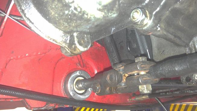

You can always replace the coupler with the steering U-Joint left over from a parted out 914 or 911.
(IMG:http://www.914world.com/bbs2/uploads/post-12023-1527460783_thumb.jpg)
Nice, tight shifting and you never have to worry about the coupler bushings falling apart again.
I did this on Betty's 914 years ago, and on mine when I still had a 901 transmission. Makes an incredible difference.

QUOTE(ClayPerrine @ Aug 7 2023, 11:20 AM) *
Slick, how do you keep it covered to prevent debris?

QUOTE(930cabman @ Aug 7 2023, 12:42 PM) *
I don't. And I have never had a problem with it.
And the picture is not either of my cars. I can't seem to find one of them. I am still looking.
