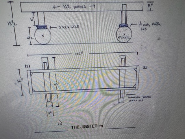

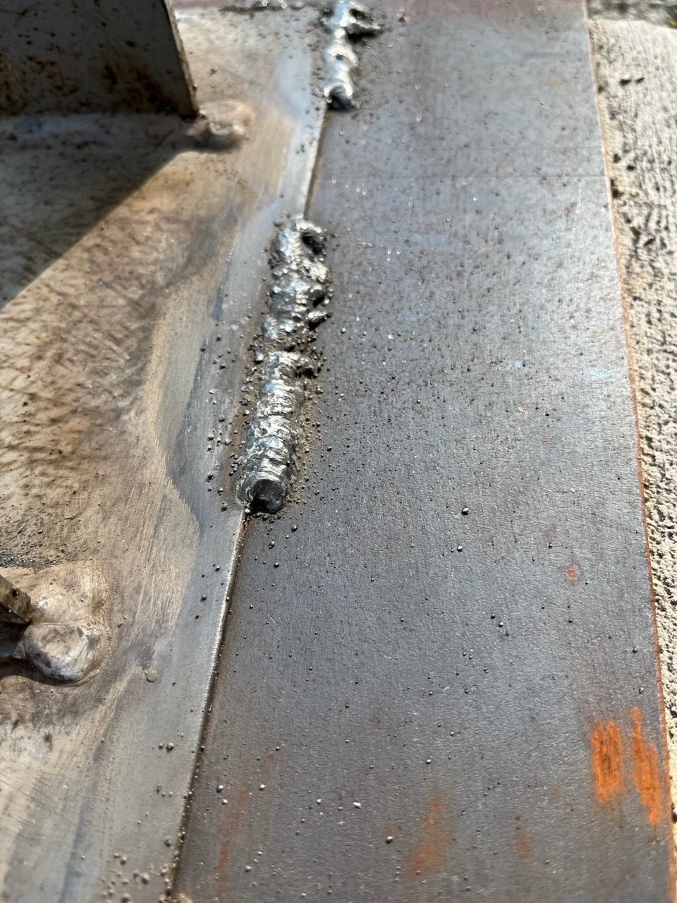

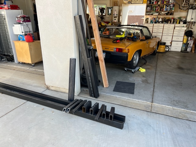

Hey Everyone. Based in no small part on the suggestions from my original thread about what order to do my restore I picked up some steel and pushed my Makita metal cut-off saw the limit. I'm ready to start putting this together. My question is I have a Weldpack 3200. I bought it a couple of years ago just to play with things. Some metal art, built a Santa Maria Style BBQ, etc. Per the instructions, the metal is .125 (so close to 11 gauge?) for the 2x4's. Am I fooling myself by thinking I could use this welder to put the jig together? The welder says it can handle 12ga to 1/4" with .035 gasless flux cored wire DC(-). I just don't know enough about the duty cycle, etc. to know if I should just suck it up and buy a bigger welder. I figure once I get into the car I should be fine as it's mostly 18ga sheet metal so I hate to buy one just for the jig but will if I need to I guess. Maybe find a buddy with one. Just wanted to get some expert's thoughts as my total welding time is about 2 hours. I plan on being an expert post-rebuild. (IMG:style_emoticons/default/unsure.gif)
Super appreciate any advice you can offer. Thank You!!

Try it or test on a similar gauge metal. If the weld sucks on your jig you can clean it up. You'll know if the welds are good. I'd agree, would be a shame to buy and different welder, especially if you've gotten comfortable with that one.

It will work
I just used a whimpy 120v welder to weld 3/16” bracket to 3/8” plate steel.
0.035 flux core.
Had to preheat the plate with MAPP gas. This minimises the cold start, lack of fusion when you 1st start the bead. Not my prettiest work but it is functional and that was the only welder I have available at the moment.
Worst case, preheat the tube with propane or MAPP gas but I don’t think you’ll need to with 1/8” tube.

I think the important part is you are not making a structural part where the weld needs to be as strong or stronger than the base metal. You might not get great penetration but it will be more than strong enough to make a cart to put a body on. I have made similar body transport mechanisms out of 2x4 and screws that worked fine. Made a similar structure to pull the drive train out of my turbo cayenne out of 4x4 and some harbor freight wheels to remove the drive train, worked fine.

With that 110V welder, I’d consider tapering the ends of your material to 45 degrees, making a root pass followed with a hot pass. That will be ensure penetration. There’s really no need to pre-heat. Tack it up then burn it in.
