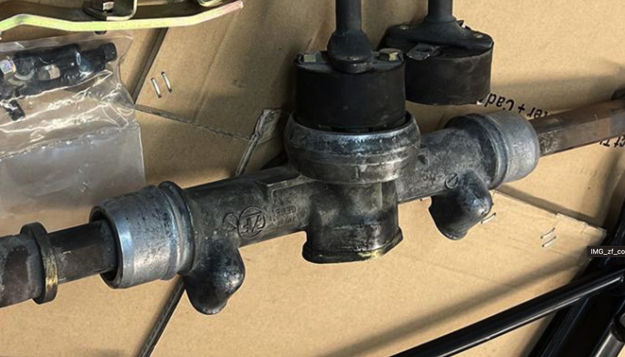

QUOTE(Al Meredith @ Aug 28 2023, 02:45 PM) *
Dennis, Does your rack and pinion come from a 914 or since it was assembled in the Porsche factory does it have a "ZF" box like a 911. My reason for asking is because our real 6 has been apart for 35 years and I have 3 914 R&Ps and three "ZF" with a large ZF on the casting. Al
Hi Al. Following up on your question. Here is a photo of the rack out of the car (1970 factory 914-6). You can see the "ZF" marking. Let me know if you're looking for something else.

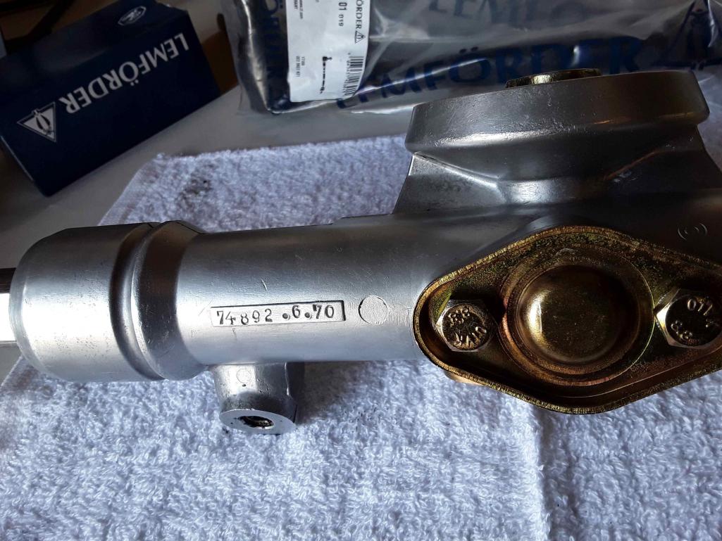

QUOTE(DennisV @ Sep 6 2023, 03:26 PM) *
Note: this is the one from my 85 carrera and the ZF is in the casting of body, not on the cover. I have no idea what it means?

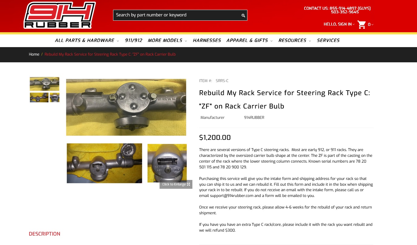

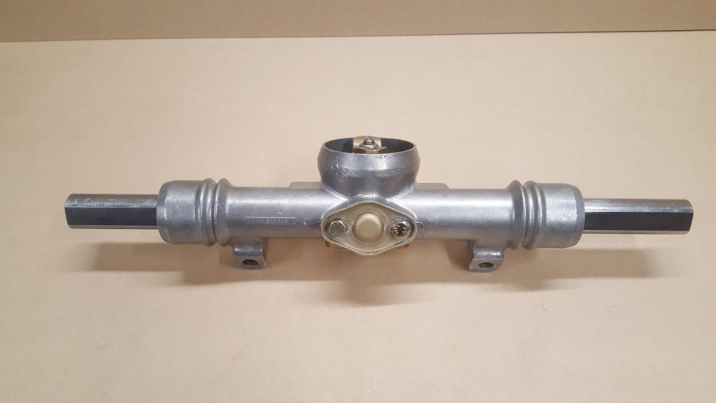

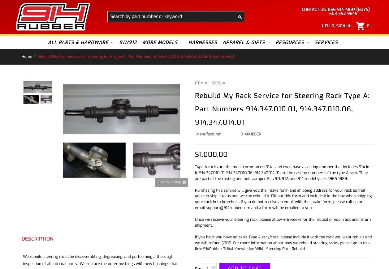

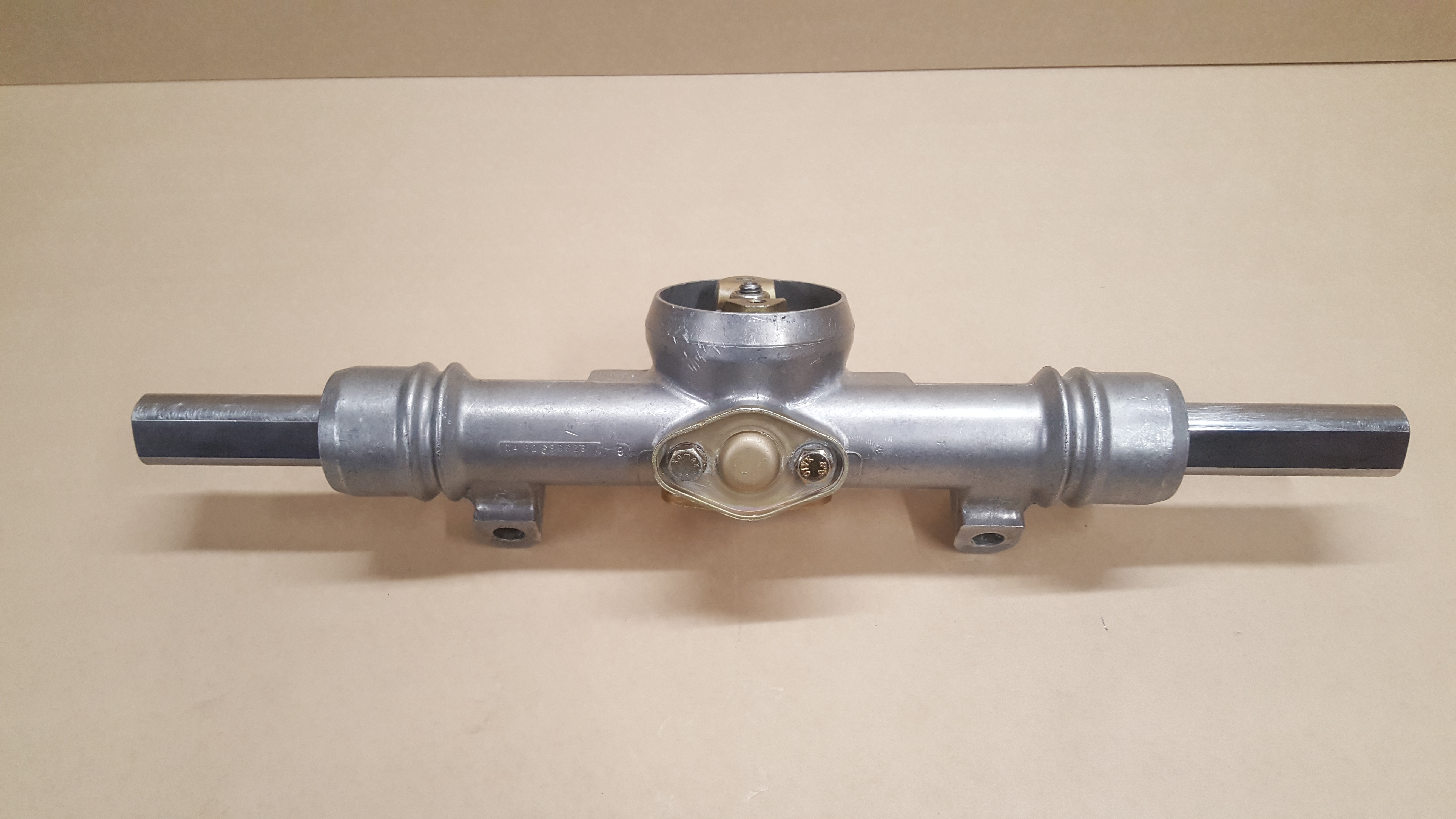

There are several versions of the racks. We have found there are 3 main types.
The type A which is most common in the 914, 4 different versions of it.
The type B which we find in 914's and 911's
The type C (which is the larger shown) more common in early 911's and 912's, again sever different variations, some include a stabilizer bar.
https://914rubber.com/search/?q=steering+rack
There are multiple variations on each of these, but they are easiest grouped into these 3 categories.
Please not the prices on the website include the core, we charge enough that returns are encouraged.
The 85 Carerra version shown below
Mikey914
post Sep 6 2023, 10:06 PM
Post #28
The rubber man
Posts: 12,772
Joined: 27-December 04
From: Hillsboro, OR
Member No.: 3,348

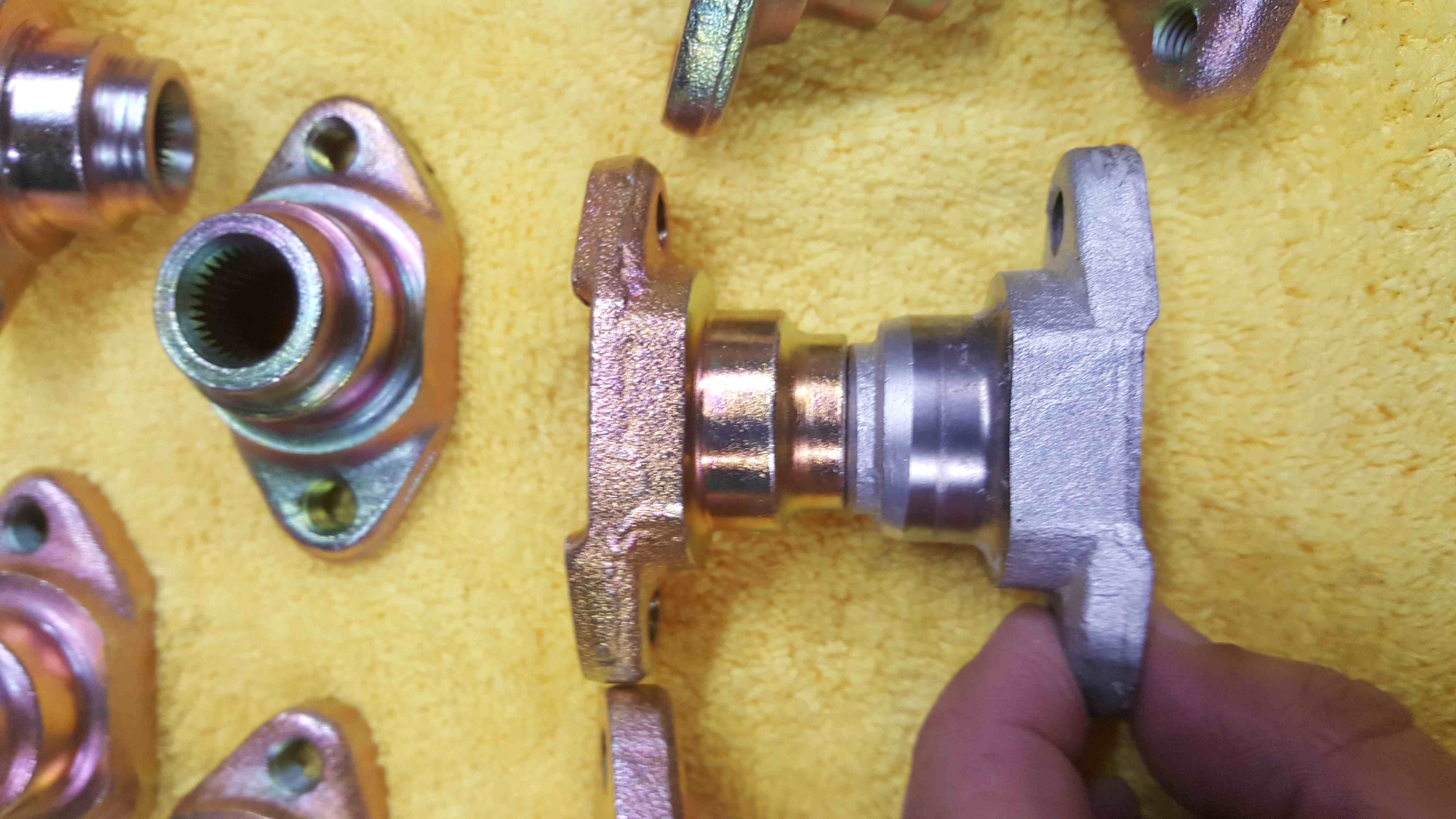

There are a few oddballs, but technically they are interchangeable. We even can do the Quaife gear reduction swaps too.
In addition we polish al lnternals and hold tighter tolerances than factory.
We originally wanted to sell these as kits, but found that there were some special tools and experience needed to put them together correctly with the higher tolerance parts
