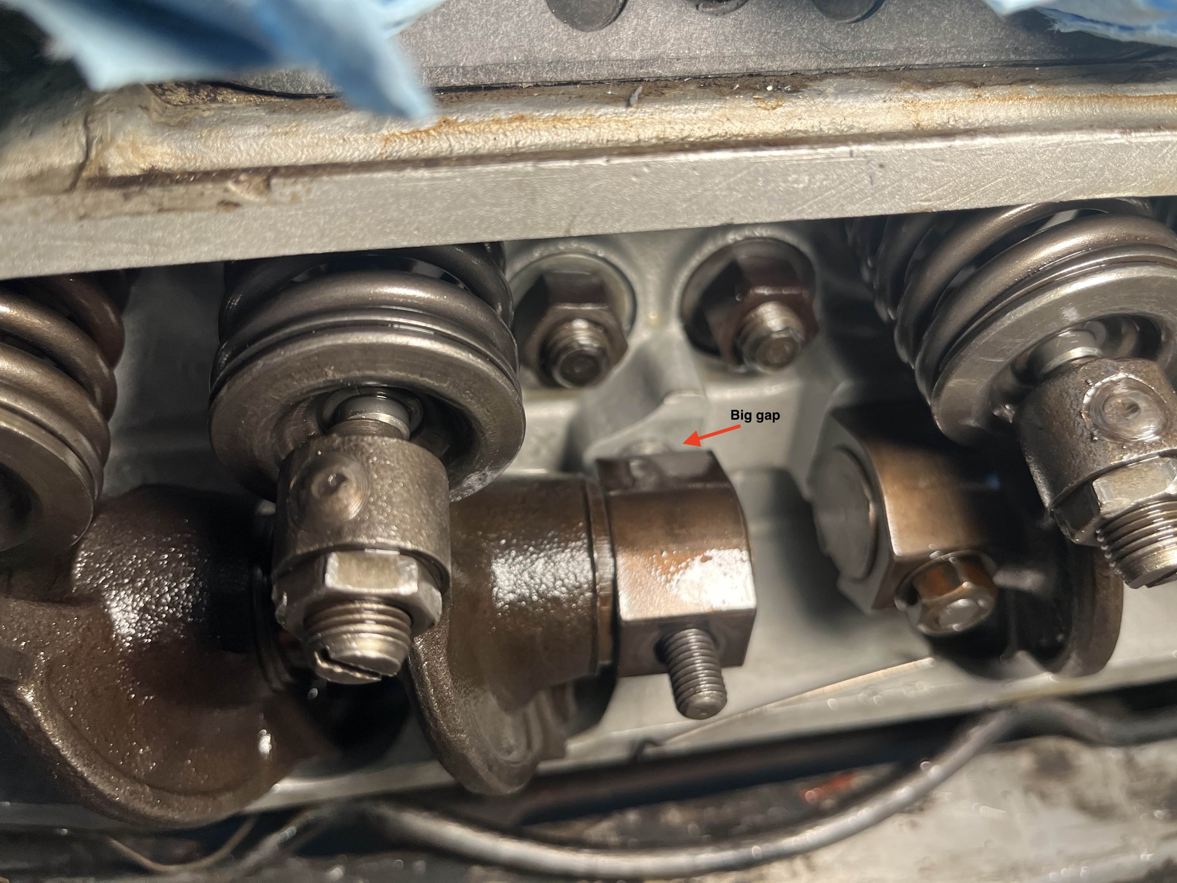

Yesterday just before getting home I heard a click from the engine then again. It wasn't steady, just every little bit I would hear it. I could feel that I lost power and it even stalled once at a stop light. Since I was only a couple block from home I just keep going.
I found that cylinder 3 could only produce 20 lbs of compression. A leak down test was 22% with most air coming out of the intake. For reference the other cylinders were 100 to 105 compression and the leak down was 18% to 20% with air noticed just in the oil filler hole. I don't know how accurate my testing tools are since they are cheap ones I got from amazon and harbor freight.
I took off of my valve cover for cylinders 3 and 4 and with cylinder 3 at TDC I have over 1/2 inch of play with both valves and the pushrods are of course way loose. I haven't removed the rockers to pull the pushrods out yet to see if they are bent. I will do that after I pulling the engine either tomorrow or this weekend.
How screwed am I? Thoughts on best and worse case?
Here's a video of my loose rocker Video of rockers

you may have dropped a valve seat which will wedge against the head and hold the valve down open.

I will check for that. That doesn't sound too bad unless the piston hit the valve and bent it.

Unfortunately, it's probably best to start saving $$$$ for a pair of new cylinder heads and potentially a set of new P&C's. A dropped valve seat or broken valve will likely ruin the piston on #3.

i agree its likely dropped valve seat,that #3 is the most common cylinder, it happened to me 2 years ago, and they dont always cause damage, mind didnt and i had my OEM heads sent out and rebuild with all new stuff, including upgraded new valve seats, new valves, guides springs etc. BUT you might be better off getting new head castings and ahve the same done to them. see what you have once you drop the motor . you can scope it , pull the plug and get an idea if thats the case but, you might as well drop the motor .

QUOTE(r_towle @ Aug 31 2023, 01:42 PM) *
Rich
I agree!
The other side is now suspect to happen soon
Rebuild time I’m guessing

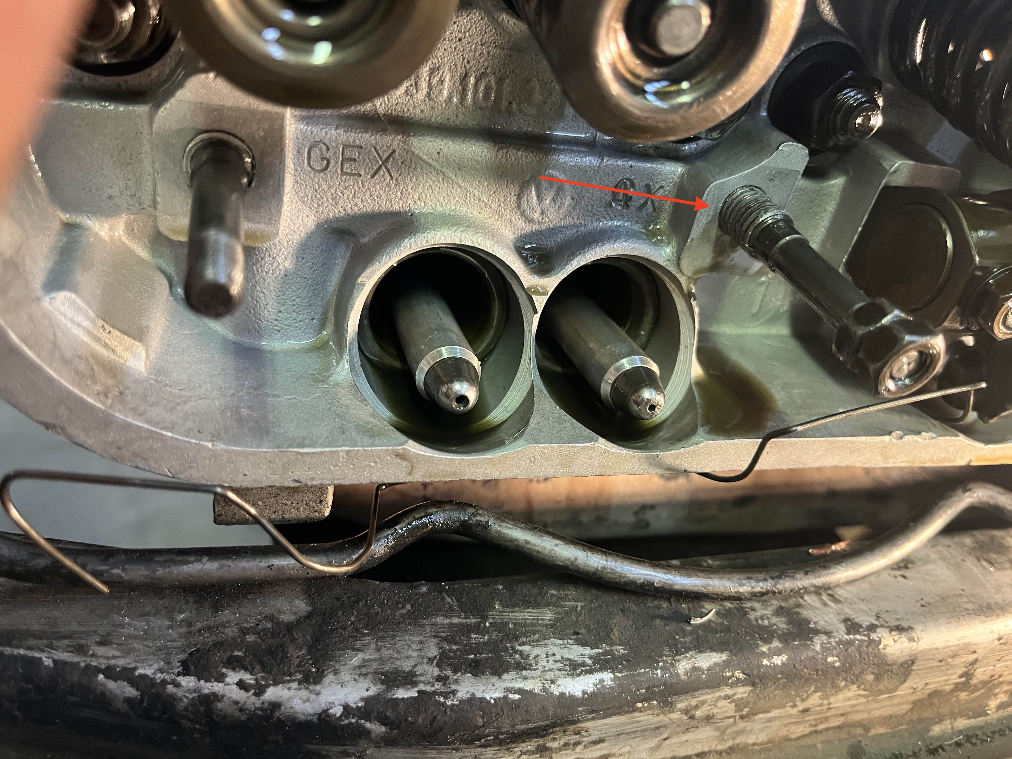

I've only had the car 10 months so I don't have all the info on the engine. The did give me the receipts for maintenance they had. The heads were redone in 2011 by Foreign Auto parts & Service in ST George, UT.
What I've found today after removing the engine and the tin around the head, the one of the rocker bolts appears to have blown out. A look through the spark plug hole shows nothing shinny but I'll see more when my scope comes. The valve pushrods are fine. I've got to research how this happened and if it can be repaired.

From: Orange County
Member No.: 13,474
Hoping that is the only issue and can be fix and able to drive the car again.
Probably over tighten that made it broke.

Looks like the engine was “rebuilt” by GEX. Go over to the Samba.com website and check out the Bay Window Forum by searching for GEX engines. GEX is the most reviled engine “rebuilder” on planet Earth. ☠️☠️☠️☠️ is the GEX kiss of death. Start saving money now because this episode is likely the first of many to come.

I retapped the bolt, put the rocker back on and set the gaps. Going to put it back in the car tomorrow. As long as the bolt holds, everything should be back to normal. I'd say that the reason I had no compression on that cylinder was due to the valve not getting pushed open and since the leak down test was descent the valve seat should be okay.
Did the retapped stud hold the correct torque ? ,looks like the other one has been helicoiled or some other insert.

I torqued them to 10ft/lbs. I put the engine back in today check compression and leak down before I started it. Compress was 95 and leak down was 22%. I started it up and it idle great and revving the engines was as well. It didn't seem to have its normal power while driving. I wasn't pushing it at all but could still tell something is still off. It seemed like it was running rich and missing a bit. After I got back I rechecked compression and leak down on all cylinders while still hot. Compression was, starting on cylinder 1: 102, 105, 100, 105. Leak down was 14, 18, 21, 16. That's normal for my engine since I got it. From that I think the engine is fine. Am I missing something?

Anyway back to my original issue.... I found my loss of power after rethreading the intake side of that rocker was the exhaust side blew out. The exhaust valve was not opening and all that heat was going back into the carb i guess. I did notice the carb was unusually hot after my test drive. I didn't think much about it at the time since I hadn't checked the carb temps after other rides to compare it to. I'm probably lucky it didn't start on fire.
I dropped the motor again yesterday and retreaded the exhaust side and put it back in the car. Today I started it up and let it idle for about 15 mins then took the valve cover off and checked the gaps. Looked good so I took it out for a 20 minute easy ride. Power was good and it ran great. Tomorrow I will give it a harder test then check the valve gaps again.
