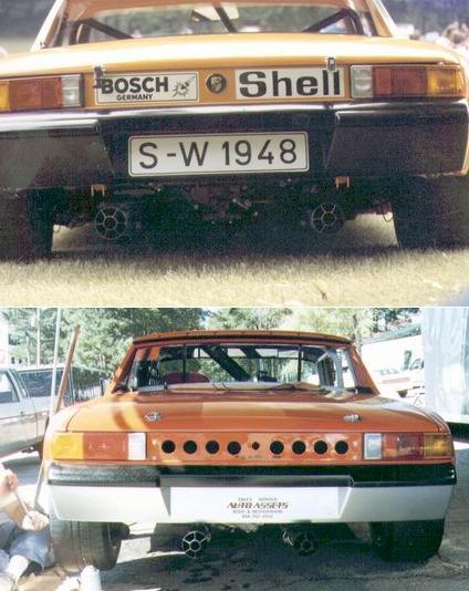

Gustl
post Jan 28 2005, 11:19 AM
914 enthusiast & historian
Posts: 12,084
Joined: 16-June 04
From: TIROL / Austria
Member No.: 2,212
Region Association: Austria
QUOTE (DougC @ Jan 28 2005, 06:07 PM)
I love the look of the Mega-phone exhausts with "cookiecutter" ends that were used on many Porsche race cars including 914/6 GTs.
(IMG:http://www.914world.com/bbs2/html/emoticons/agree.gif)
(IMG:http://www.914world.com/bbs2/uploads/post-2-1100979230.jpg)

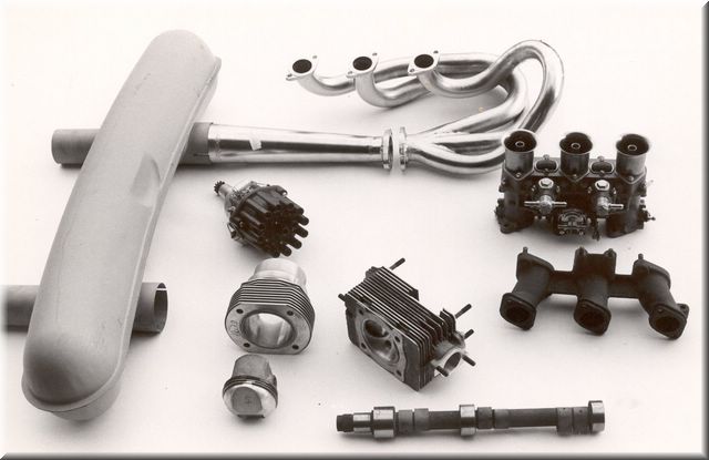

JmuRiz
post Jan 28 2005, 03:11 PM
Posts: 5,623
From: NoVA
Member No.: 50
I believe those are the GT parts for the 914 as listed in the factory Catalog.
Factory GT parts catalog
914 GT exhaust pics

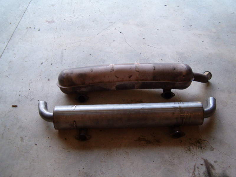

736conver
post Jan 28 2005, 03:30 PM
Posts: 2,117
Joined: 25-May 03
From: SE Wisconsin
Member No.: 736
Stainless steel GT muffler. Replica for sale.

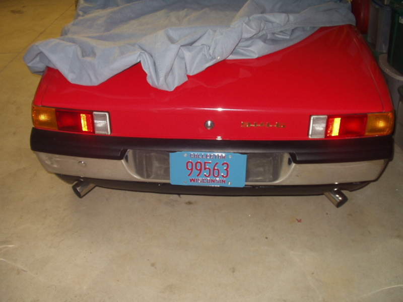

post Jan 28 2005, 03:41 PM
Posts: 2,117
Joined: 25-May 03
From: SE Wisconsin
Member No.: 736

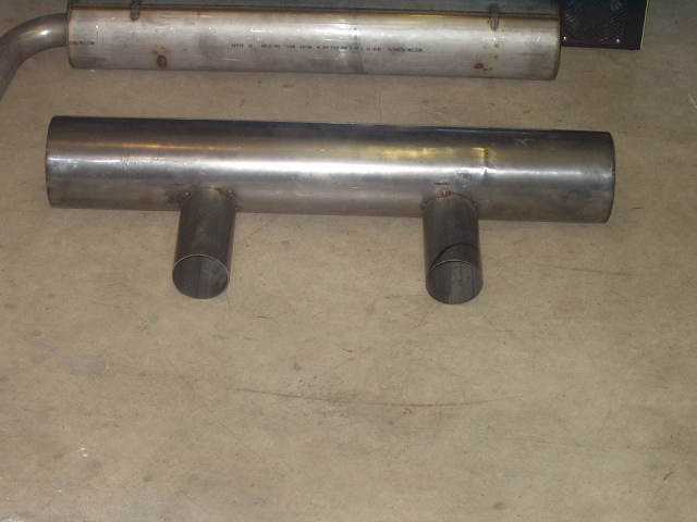

Here's a six muffler, stainless steel, that will bolt up to the 914-6 headers.
736conver
post Jan 28 2005, 03:42 PM
Posts: 2,117
Joined: 25-May 03
From: SE Wisconsin
Member No.: 736
736conver
post Jan 28 2005, 03:43 PM
Posts: 2,117
Joined: 25-May 03
From: SE Wisconsin
Member No.: 736
comparison to factory banana
