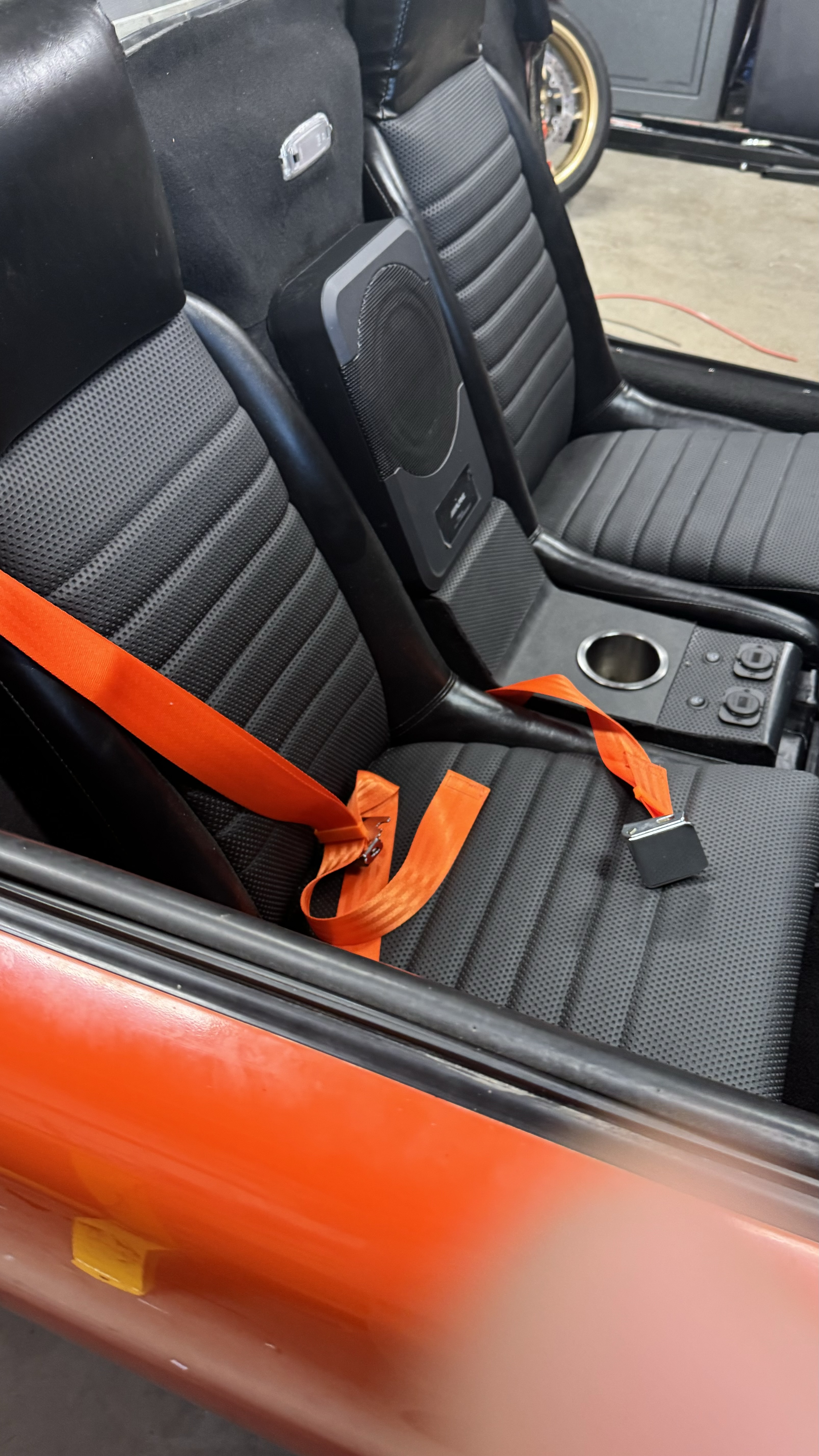

Specifically designed for passenger footwell location. See video on Crutchfield site. Amazing!

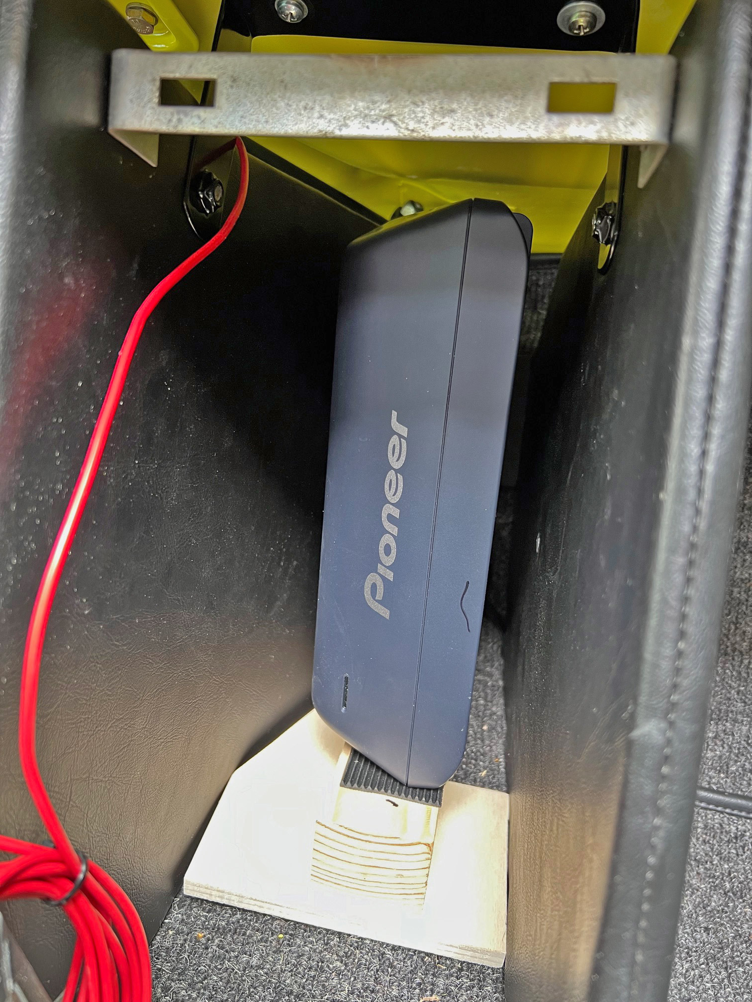

So, yes, it does fit in a stock center console nicely - just finished my installation!

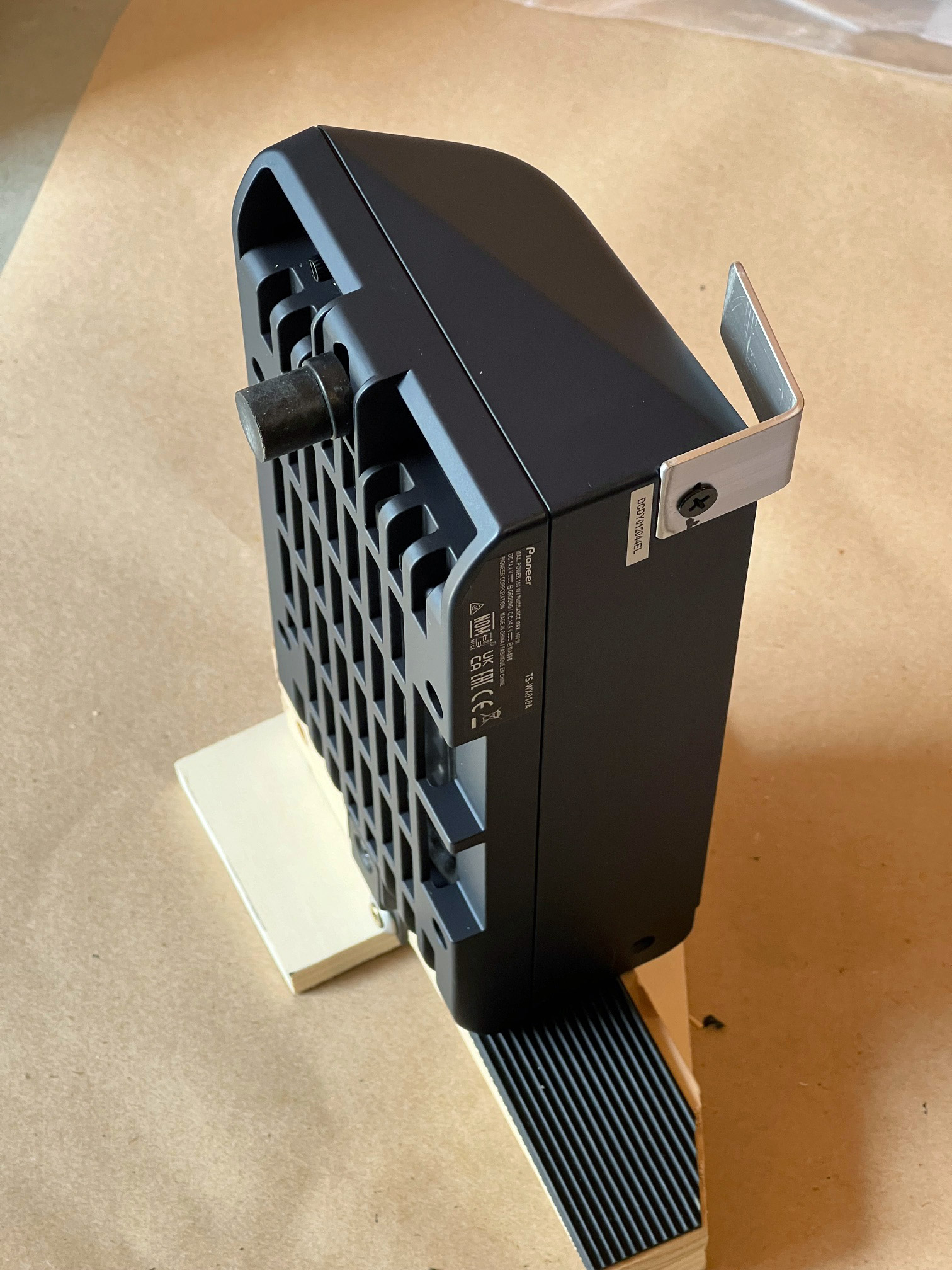

1. Made a wood block that fits inside the console to the rear, It's a little wedge-shaped horizontally as well to hold the unit more straight up. The unit is then screwed into the wood block with one of the supplied mounting brackets. This is the initial fit test:
2. Then I made a small bracket from an aluminum strip I had, found a rubber bumper about the right size I could screw into the other mounting hole so that the top of the unit lightly wedges inside the console when installed:

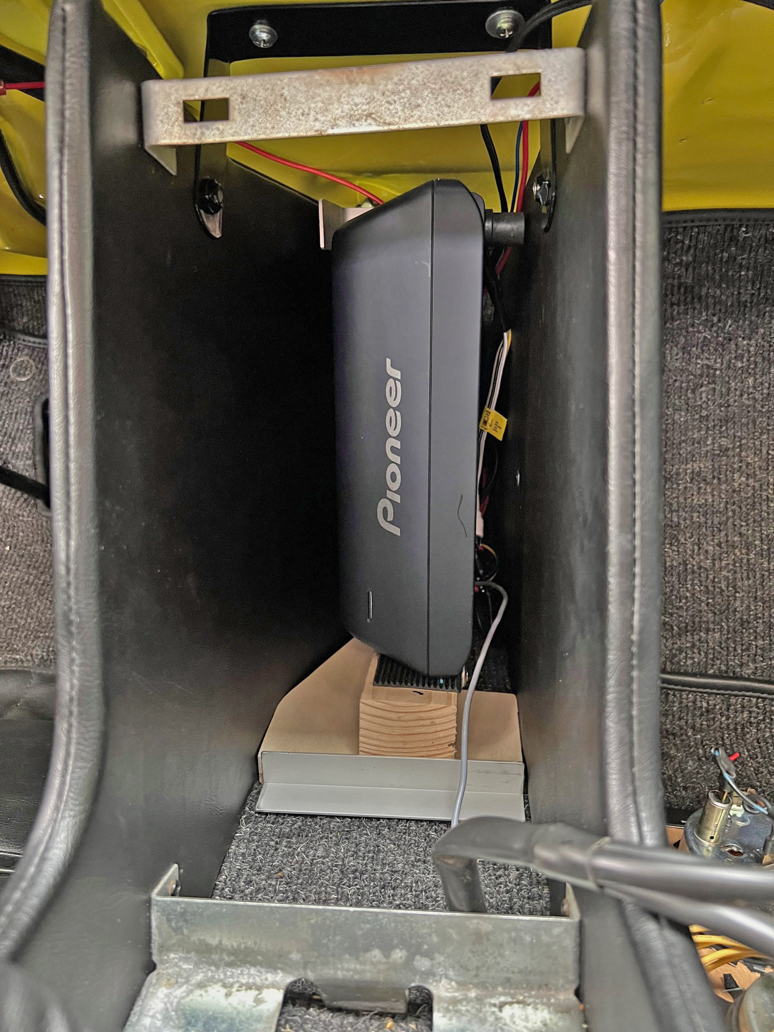

3. Did the cabling - very straightforward, the only thing not in the kit was an extension RCA cable, I had three or four lying around in my box of audio cables, so no problem. Yellow wire to Battery+. I have this on a separate line with a 15A fuse to supply both the radio head and the subwoofer. Blue wire to the radio antenna/accessory wire (turns the unit on and off with the radio), black wire to ground. RCA cable from the radio head to the subwoofer. Done. Finished install (the aluminum angle is just velcroed to the carpet to keep the unit from sliding forward):
It sounds great! Makes an amazing difference from the 4x6's (see this thread) alone. With the top on it's almost too much bass (for me) on max gain. Should be great with the top off. That's the only downside, in order to tweak it, you need to get into the console and pull the thing halfway out.
And the console and speakers look perfectly stock. The radio is the exception of course.

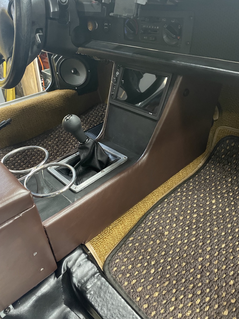

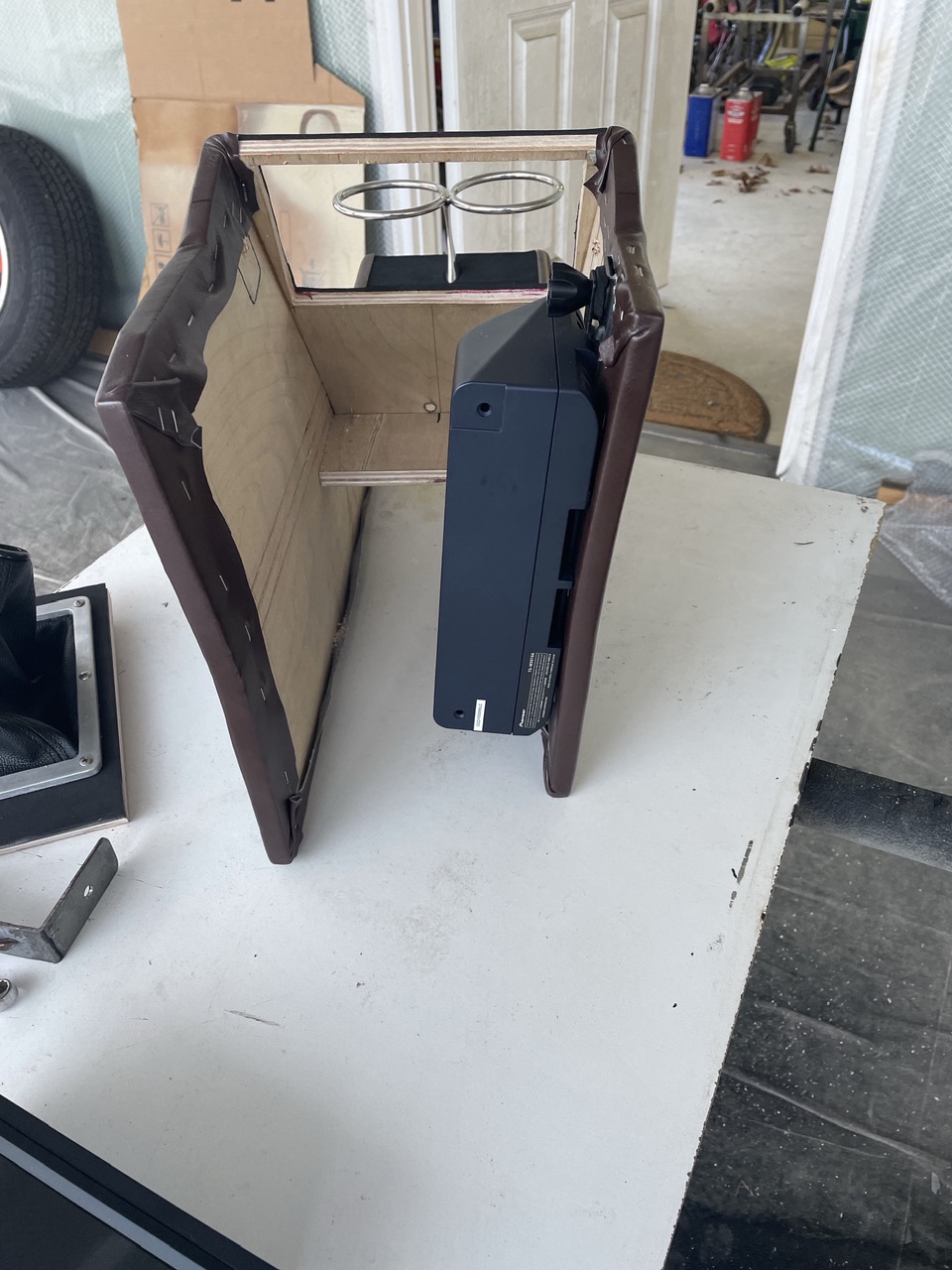

I choose the less hidden route…and I realize it’s very ‘out in the open’ but I do like it. Was making a center section anyway so I feel like it integrated well for what I wanted. not trying to hijack the thread. I love the center console and screen setup you have
