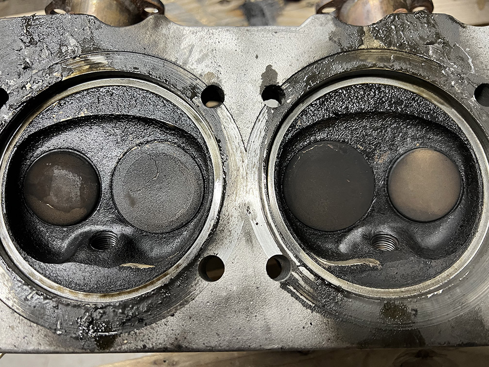

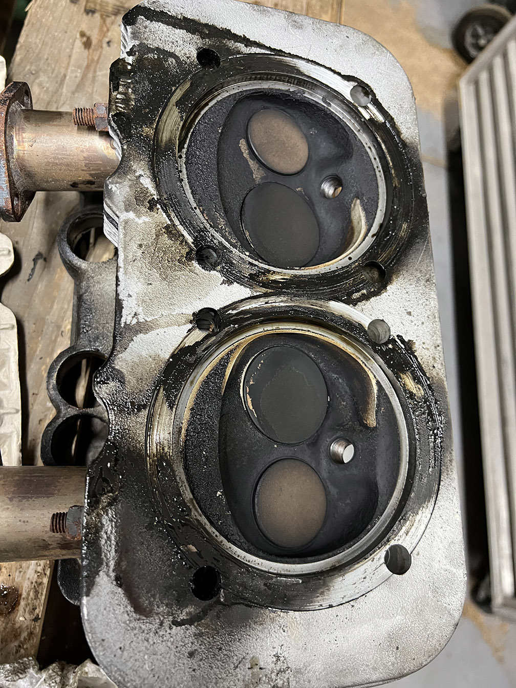

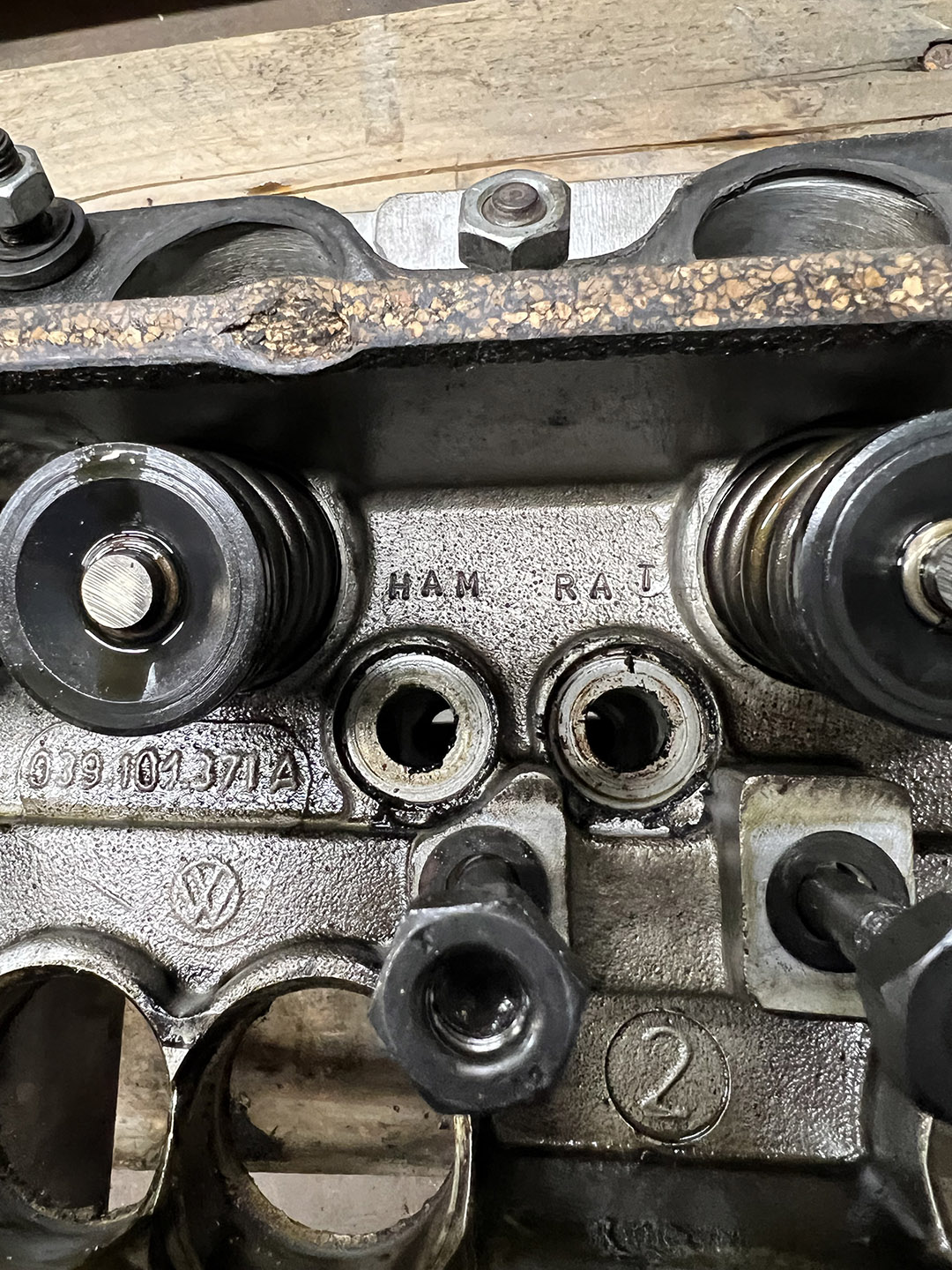

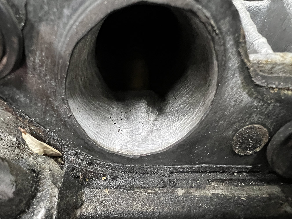

@Shivers
Just so you can see the HAM RAT head on the 2270 before Jorge rebuilt them, this gives you an idea of what this looks like from one of there heads back over 15 years ago
Best Bob B

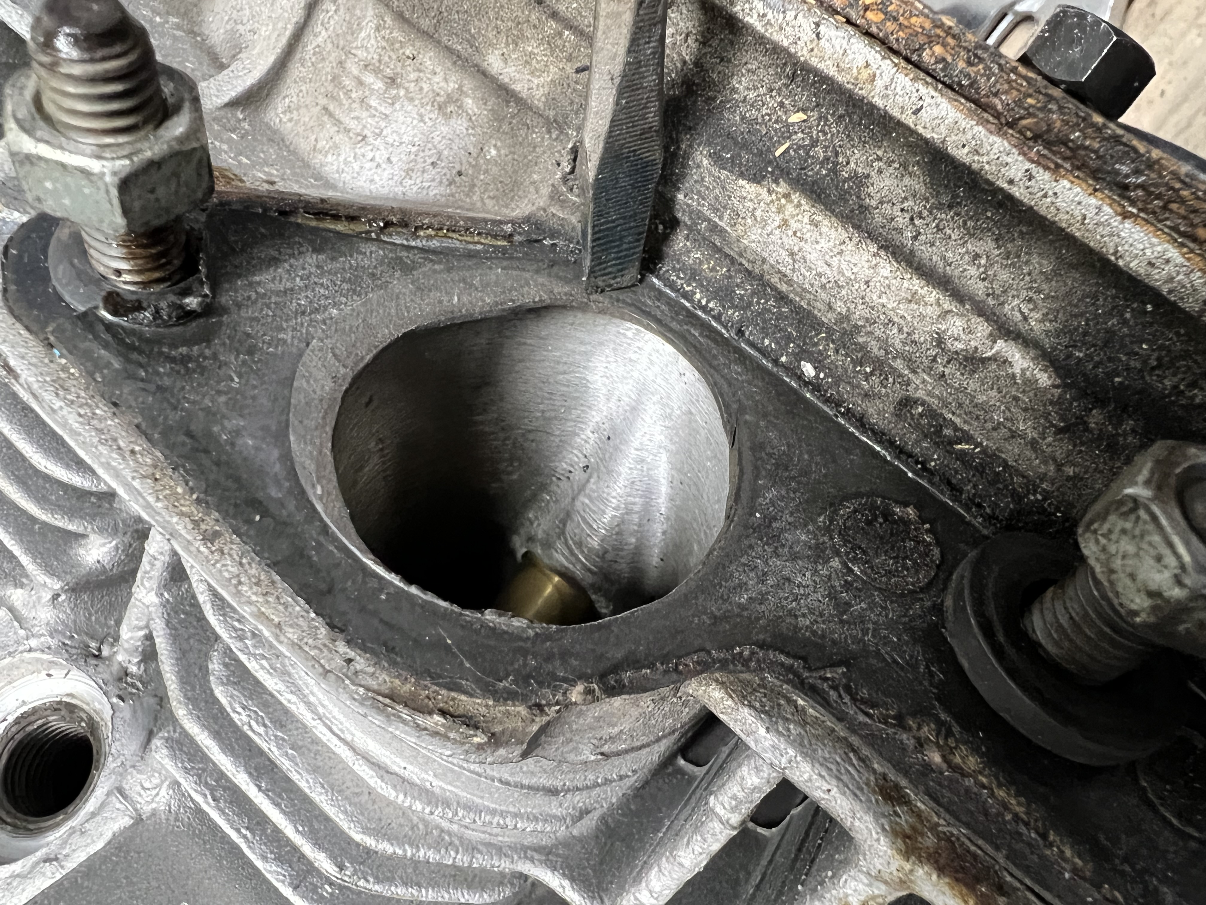

Member No.: 15,499

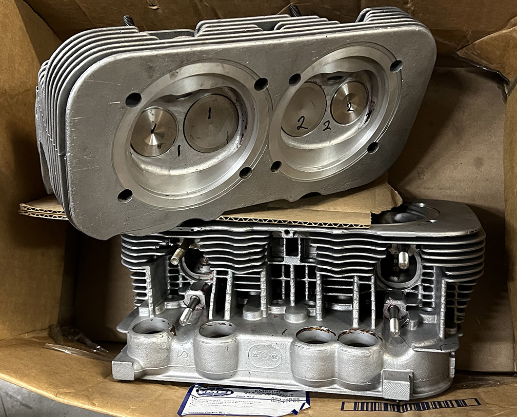

Here is a pic 2.0 Porsche heads for my intake. Not my work but good for compare?
enjoyAttached Image

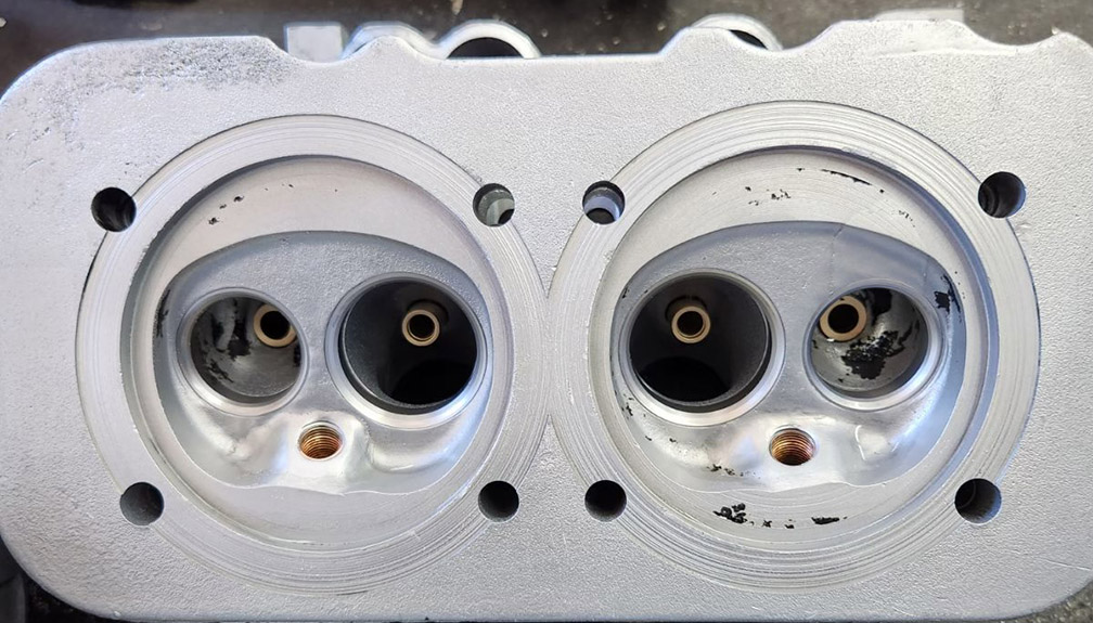

@burton73 can you post a pick or 2 of the chambers please. I am touching up the seats and need to CC match the chambers, and trying get a good idea where to take material out...

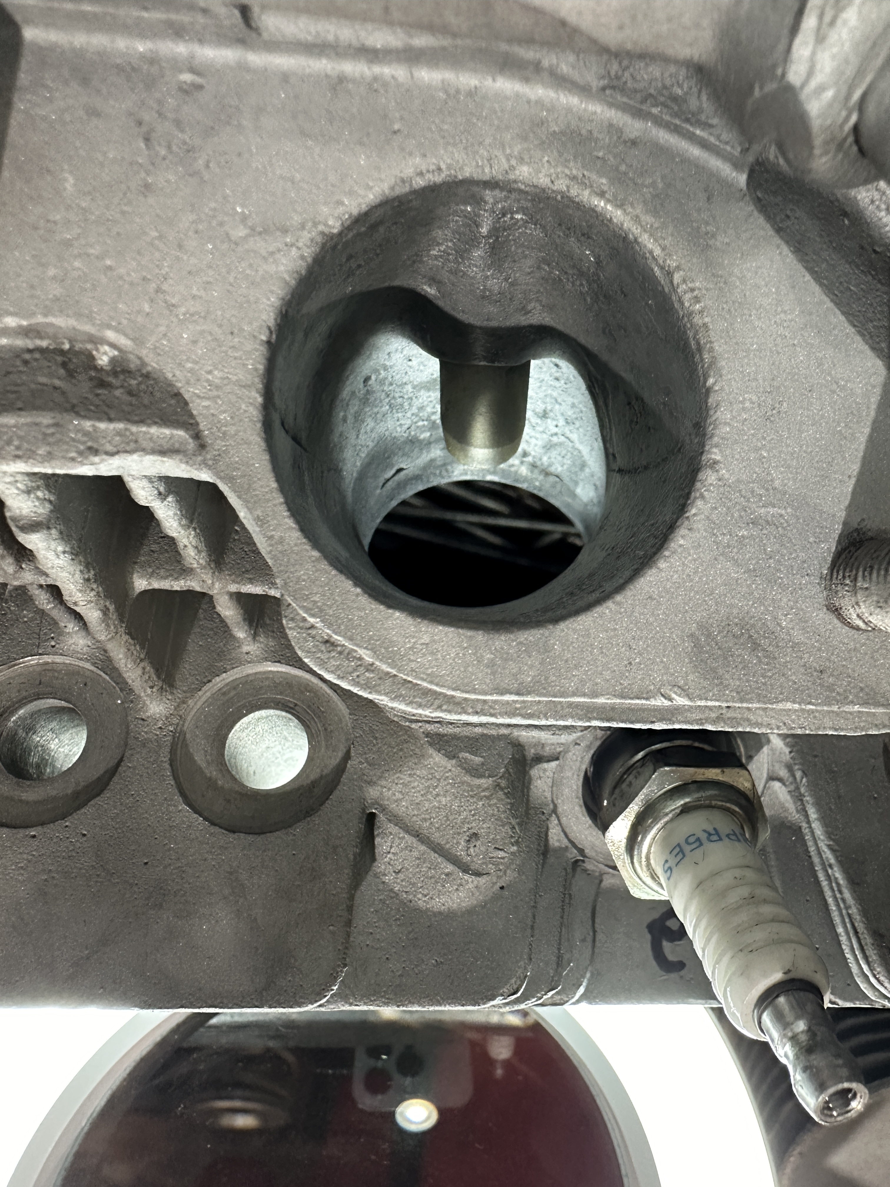

Bob do you have pics of the exhaust?

Thanks, yes it is, open it up and polish it is pretty much my answer there hoping to get some tips if there are any. It is really short and coming out of the valve so none of this pesky stuff about one side of the ports airflow can blow its turn and cut off the other side of the of the ports airflow messing up getting in the valve effectively.
Thanks for the pictures, so far not seeing any speed bumps to slow air down. Seeing a little port shaping, seen that before on a type 4, I’ll keep that in mind, I run carbs so I can match the aluminum intakes.

QUOTE(rfinegan @ Sep 9 2024, 11:14 AM) *
Hope this helps.
The exhaust system is a Tangerine Racing unit, not sure that I have a good picture of the exhaust ports on the heads. I have to look through my pictures N good pictures just this
Best Bob B
Attached ImageAttached Image

Shivers
post Sep 10 2024, 01:57 PM
Posts: 3,335
Joined: 19-October 20
From: La Quinta, CA
Member No.: 24,781
It tells me that someone that knows a heck of a lot more than I do about working ports and chambers didn’t find it necessary to taper the chamber for quench. And I do not see any substantial unshrouding going on around the valves. That is info I didn’t have, and being I also have no flow bench there was no way for me to find out. So for me Bob, it helps. Thanks dude. @burton73
