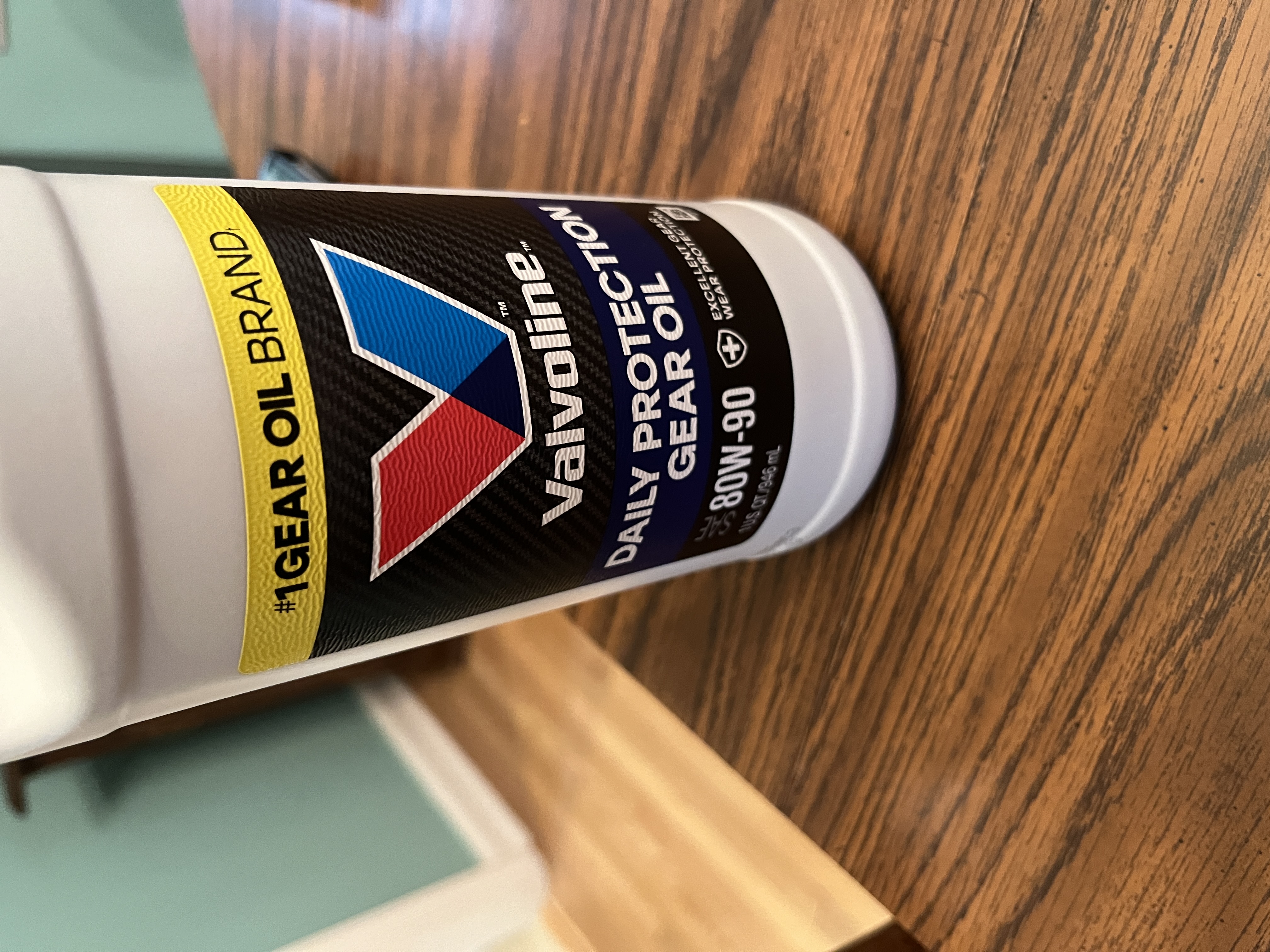

I have Swepco 201 in tranny but with seep in rear main seals need to top it off.
With cost of Swepco as only available (to me) in gallons, thinking of topping off with some other gear oil in quart bottle.

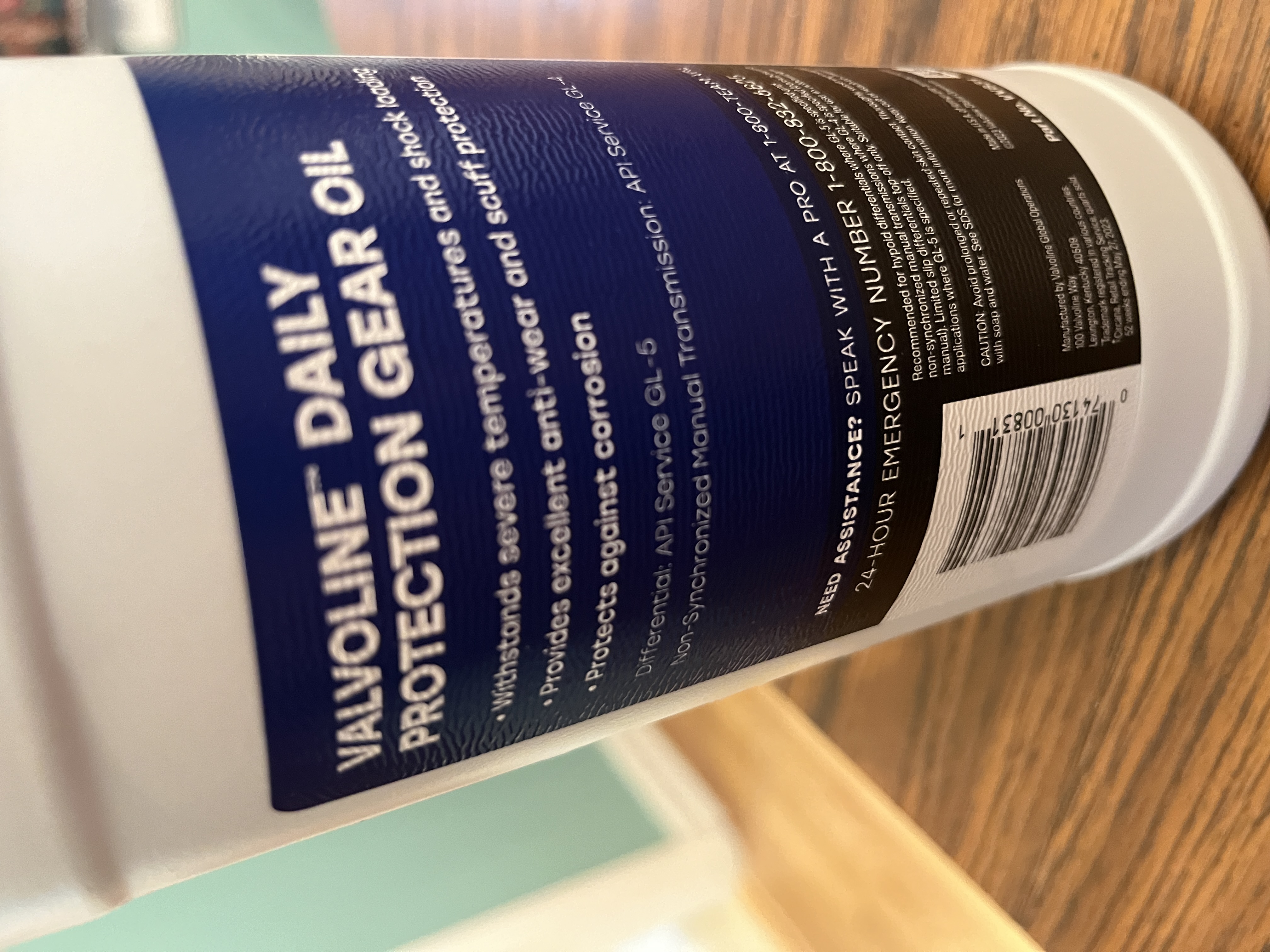

Ok to use an 80W-90 oil rated at GL5 (differential) and GL-4 (non-sync manual trans)?
I’m skeptical.

technicalninja
post Sep 15 2024, 09:24 AM
Posts: 2,531
Joined: 31-January 23
From: Granbury Texas
Member No.: 27,135
Any GL5 will work fine.
Dr Evil seems to like the cheaper stuff (Stay lube I believe).
I wouldn't waste money on top off oil.
I'd get the cheapest non-synthetic that your flaps has for top up.
The bottle in the picture is FINE!

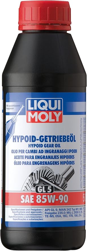

Another option - Liquid Moly GL-5?
I like the pour top on the Valvoline bottle - easy for top off when car not on a lift (which I don't have).
